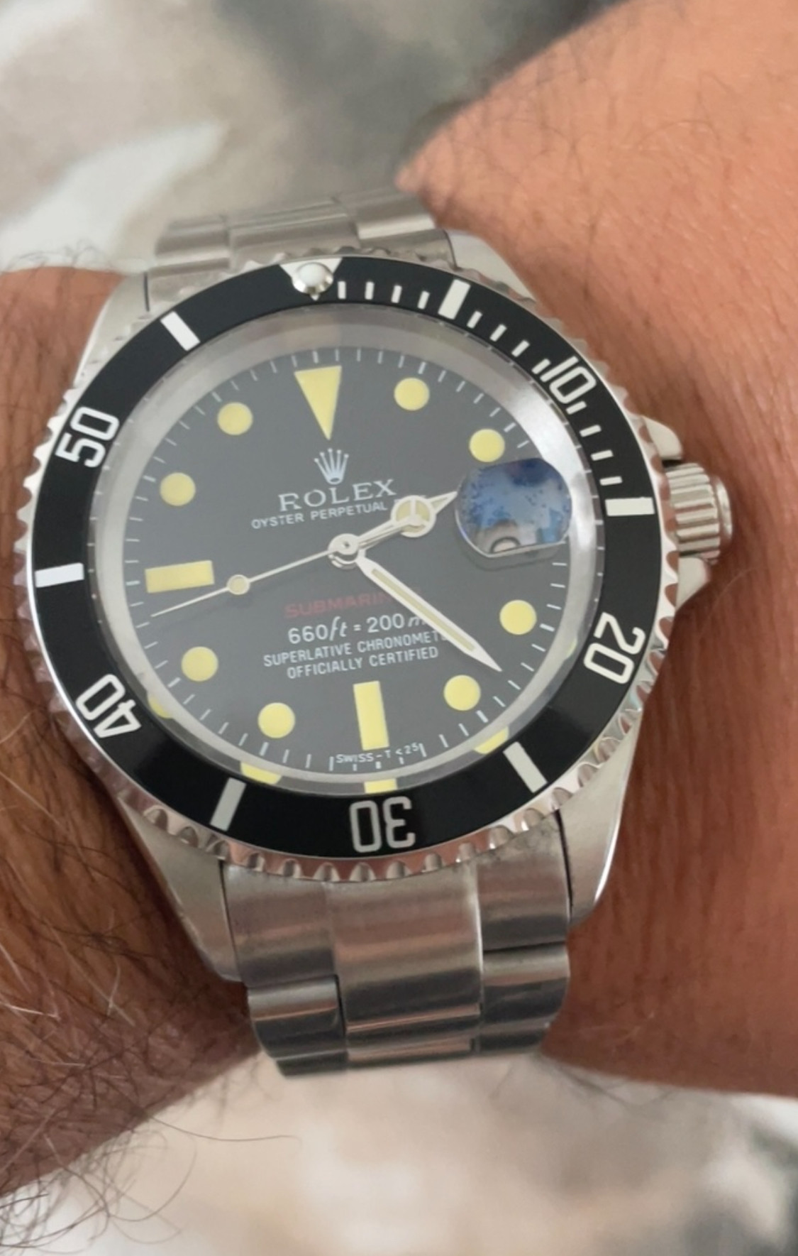

There was one step that I still want to try. It took me a while, because of a missing part, that I have to order. The insert I currently use looks very new - because it is new - and in my opinion it doesn't fit to that old watch. So my mission is to give it a vintage touch. On the thread xxx there are a lot of nice inspirations of vintage 1680. I can find three different ways of modding a insert: bleaching, mechanic scratching and using heat.
I go for the bleaching method, because it is easy and gives good results. Therefore, I bought two new and cheep inserts from Alie and use light bleeding water. It's based on a Sodium hypochlorite (2-3%). Because of the in law in europa you can't by stronger products in the drugstore. As a result, the bleaching process takes a long time.
At the following pictures, you can see the different states of the bleeding process.
And finally the result at the watch:
I like the style and I am happy about the result. But I still have one insert left for further experiments. What's your idea? What should I do with the one insert?

It is now almost a year since the 1680 was finished. Every now and then, it's allowed on my wrist. But every time, a detail of the case has annoyed me. The crown guard is a bit too big on Milk's basic case. @tripdog also described it in his presentation of the case. You can leave it as it is, but now I wanted to do something about it and adjust the crown guard to the gen. After I found several pictures on the net, I reduced the width with a file and polished it with sandpaper up to 3000.
Here the result:
Left: new shape; Right: milk shape
