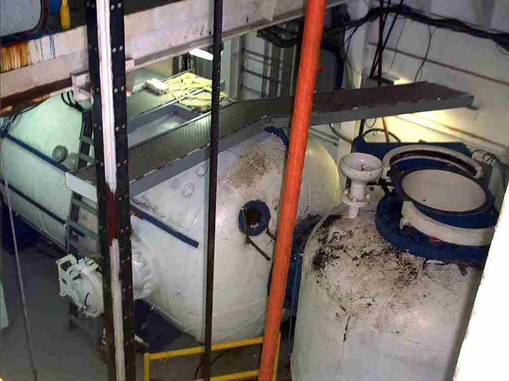

This type of diving is called saturation. Basically you climb into a steel living chamber, then you press down to pressure depth on helium. Then you live in the chamber for however many days are required to complete the job. To go to work you get into a bell and seperate from the system. We lower the bell to bottom until the pressure equalizes and you can open the door. You climb out and go to work. We do 5 hours on bottom then your bell partner locks out and does 5 hours. They pick us up and lock us back into the system and the other team goes for 5 hours each. This way you compress once and decompress once. It is much safer than surface diving and more productive ( money ). Her are some pictures of a system and bell.
This is a picture of the living chambers

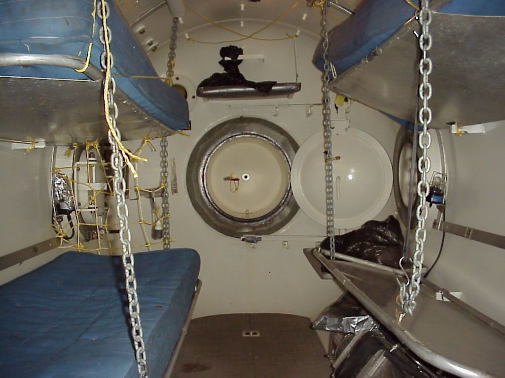

This is a shot of the interior. How would you like to spend 30+ days in there!

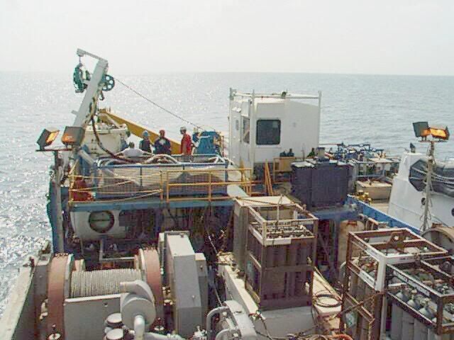

This is a portable system. You can see the living chamber underneath. The building on top is the control van.

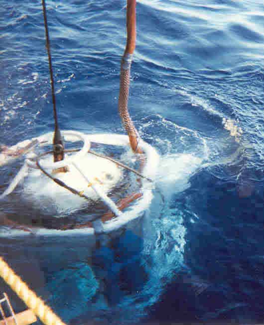

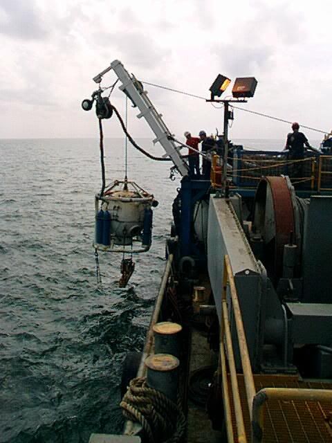

This is a picture of the bell going over the side with the working diver team in it.
This is the bell leaving surface.

As far as the loo, if you look at the picture of the chambers the smaller chamber in the center is the loo. Toilet and shower. It is also the chamber that the bell attaches to, because when you open the hatch water and mud will get into the system. We want to keep the living chamber as dry as possible. Any illness spreads like wildfire in there. It is like a giant petri dish! :D
