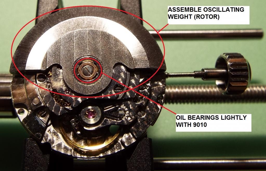

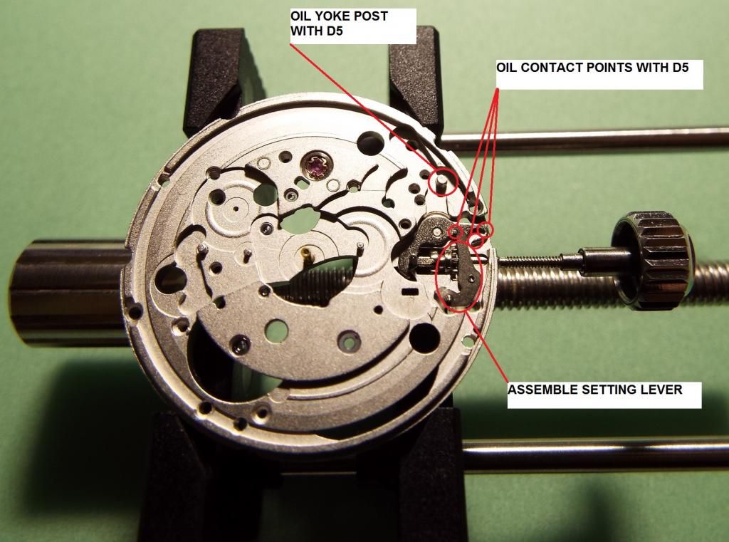

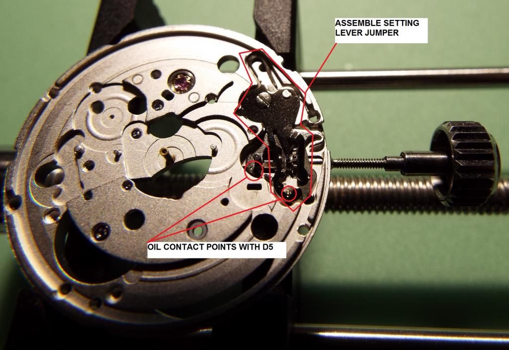

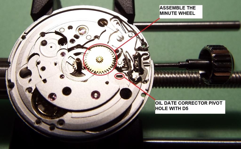

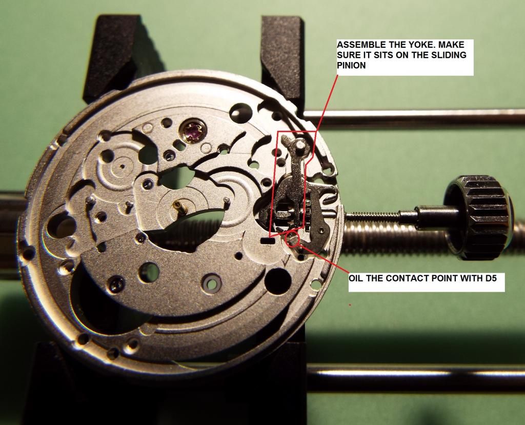

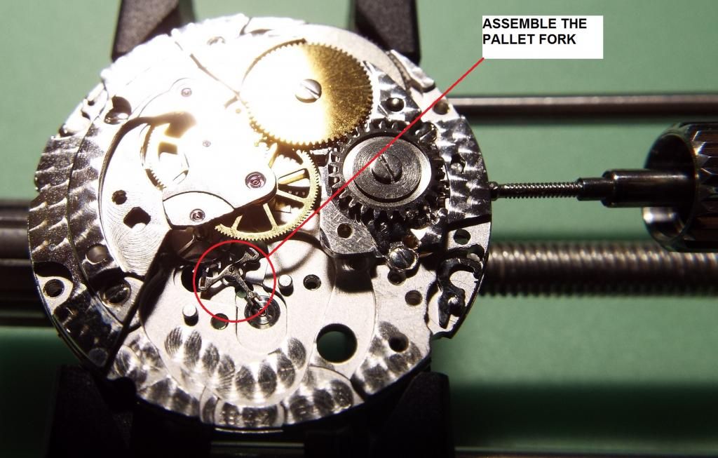

Assemble 2824-2 movement step by step

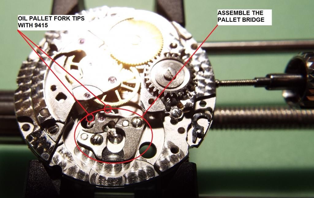

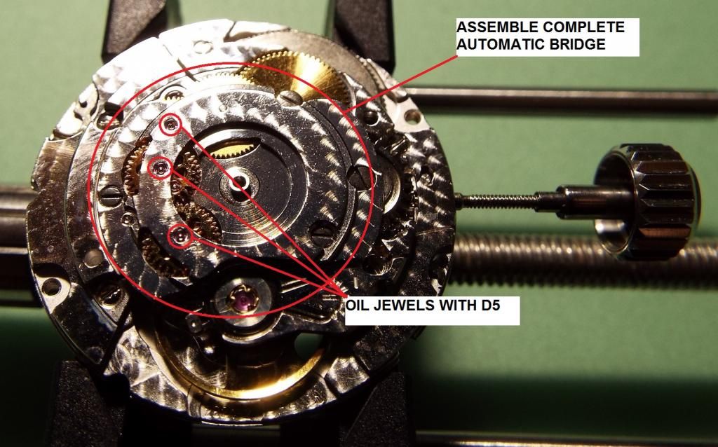

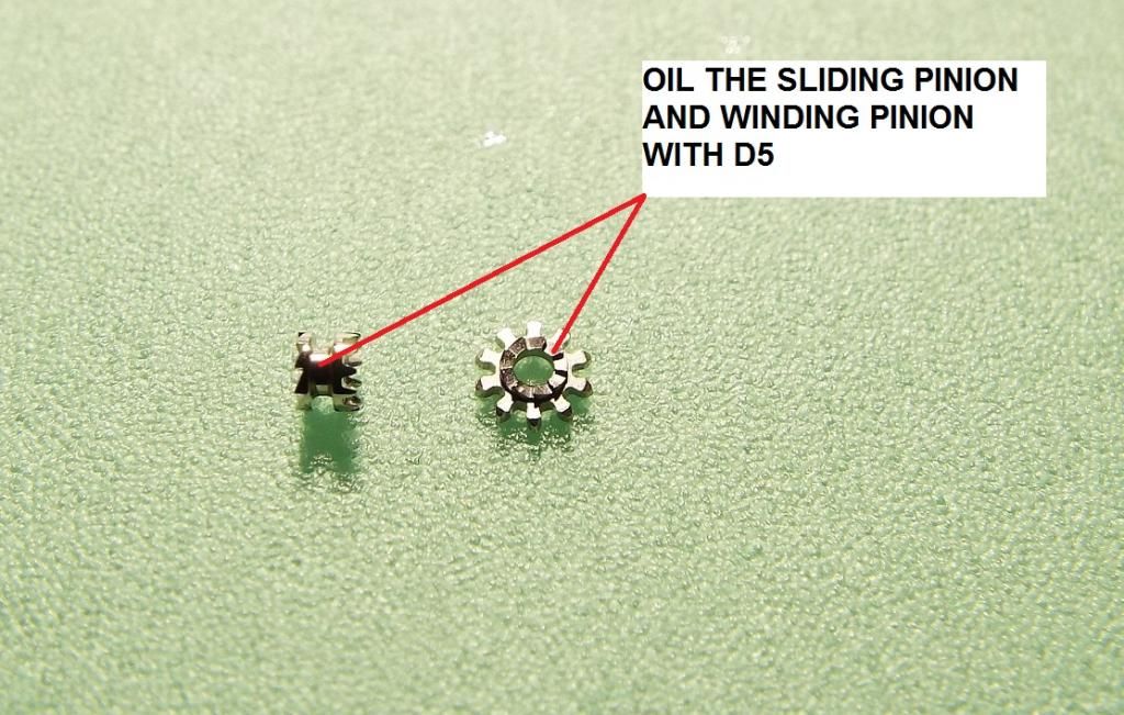

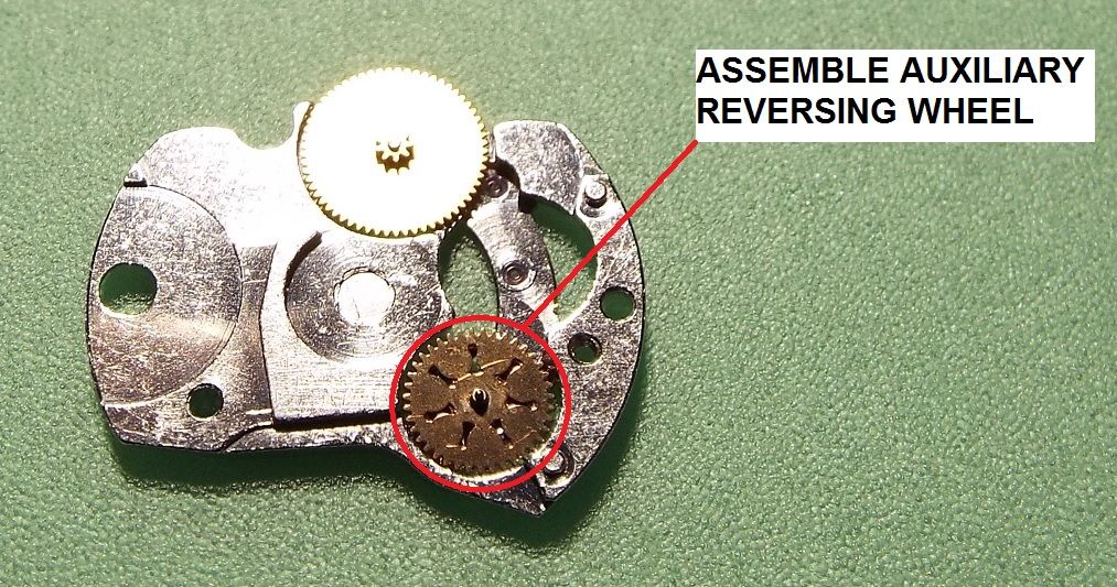

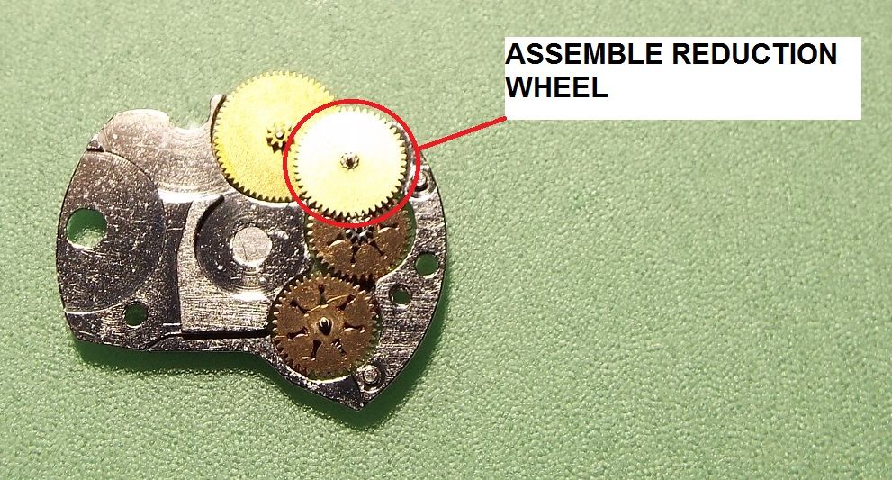

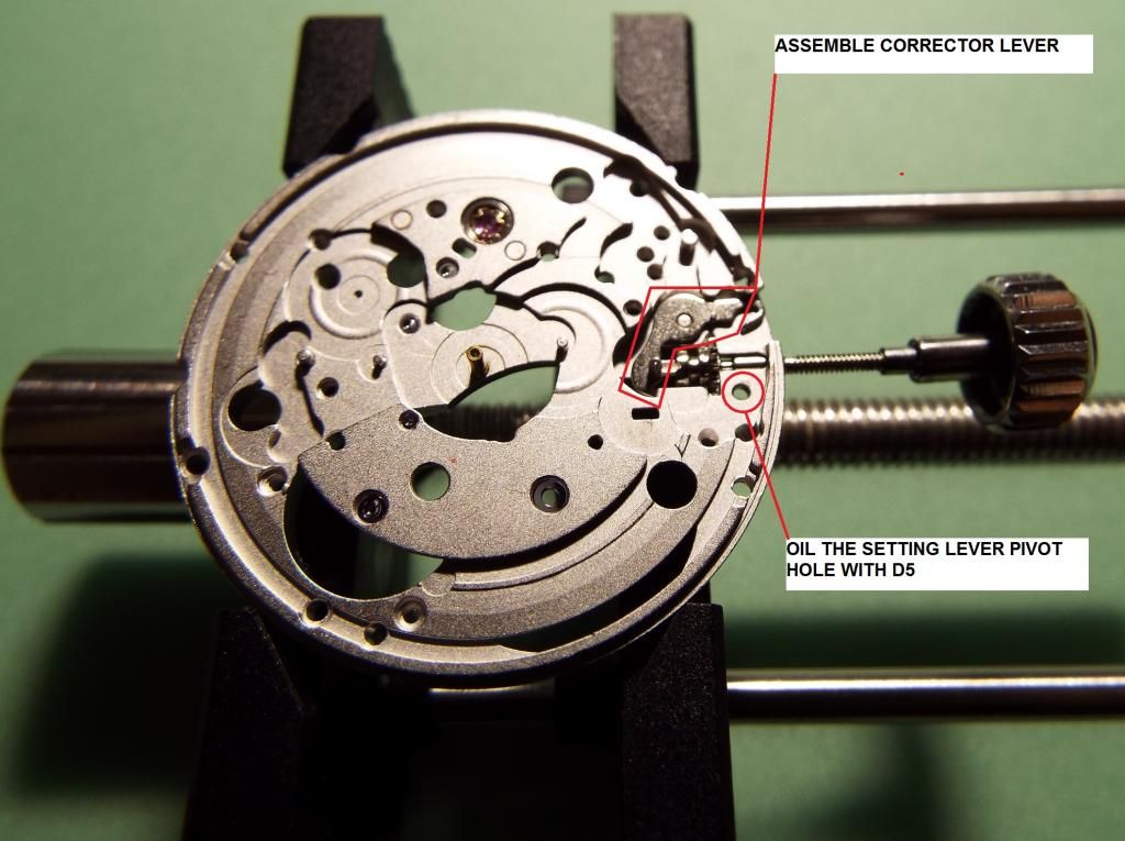

These stickied guides are incredibly useful, but PhotoBucket makes it hard to see the pics. I had to download them all to see them - and found the easiest way to access the guides quickly was to make a PDF. I did this for my own use, but thought it might be helpful to others here if I shared them. Link below,
I must thank Milkbread for these excellent guides, and credit him as the author of the images. If I'm inadvertently breaking any by-laws by doing this, please let me know and I'll delete.
Assembly Guide
Assembly Guide
