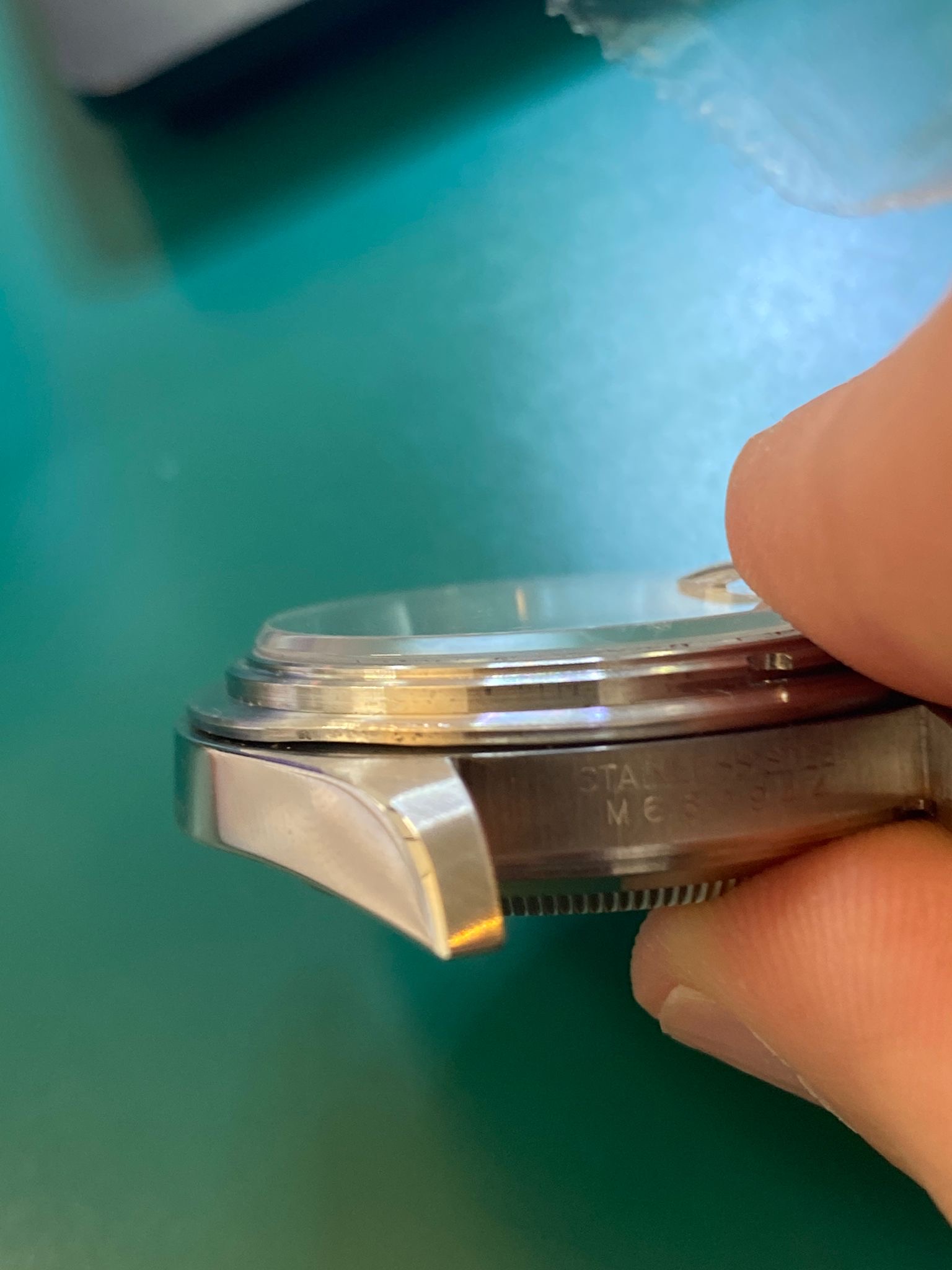

Hey mate, did the tubes come in? What do you think? I've ordered about 4 backup tubes for it.
I installed one of these tubes in an RAF case, the crown now sits much more snug against the case, definitely an improvement.
Couldn’t get a great fit with my tube remover, and regardless, the tube was really cemented in there and snapped clean off. Had to use a screw extractor to get the rest out.

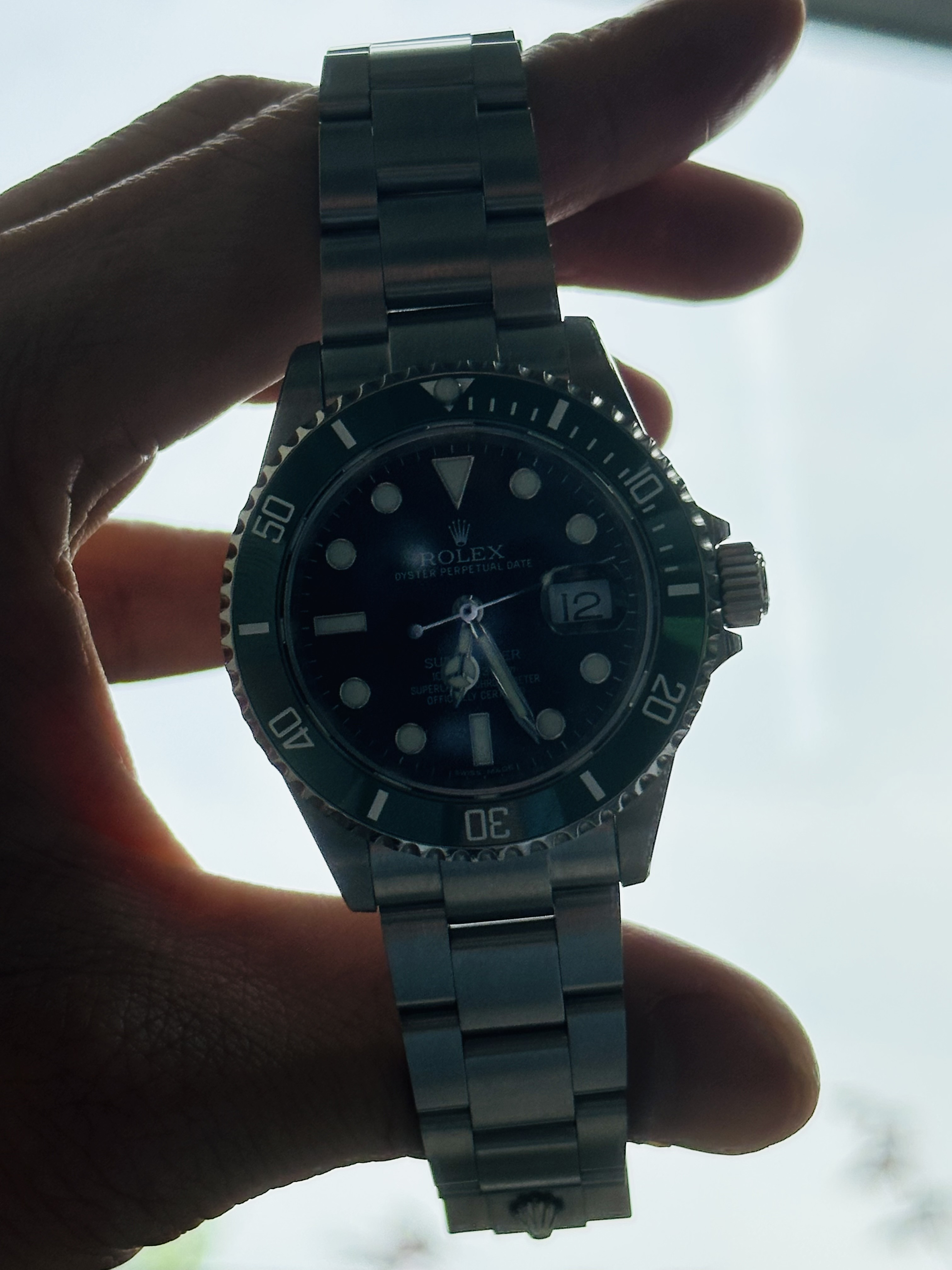

@soyuzrep i ended up swapping the crown from AliExpress. Now the crown sits tight to the case.
no light gap showing between the case and the crown. thanks for the tip, a great find for $18 CAD!!!
no light coming

*no light coming through between case + crown.

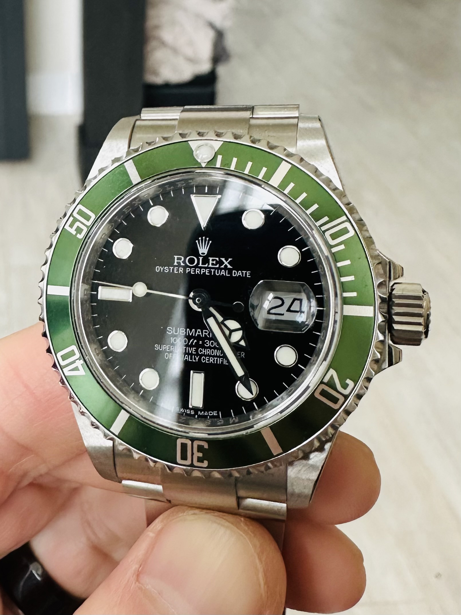

Here’s the BEFORE, with the watch in stock form. Not terrible but with the smallish ARF crown guards it sticks out like a sore thumb.
FYI, 5-digit Subs have a small gap at the crown, so your before pic is correct.
6-digit models have little or no gap 😉
