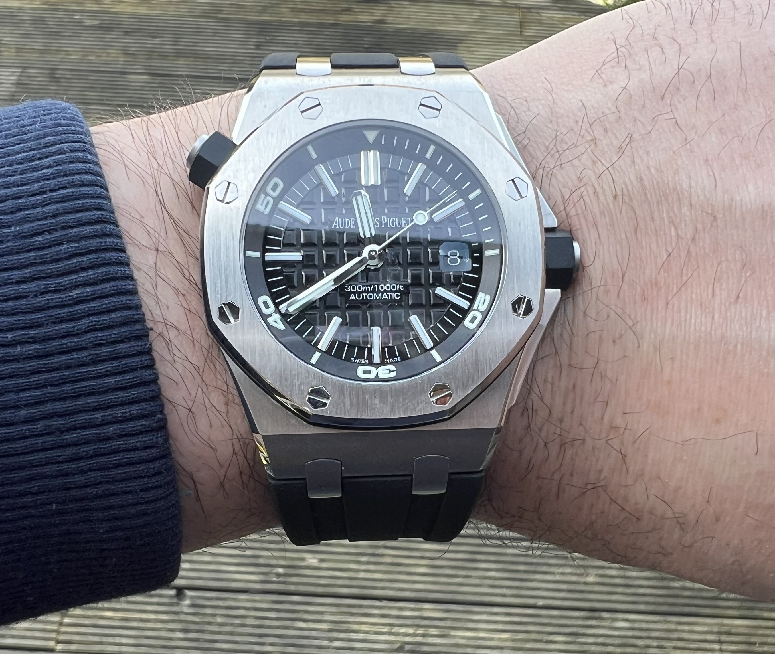

I have a APSF 15703, love the watch, it wears really nice and looks amazing.
I don’t like the movement at all, just the way it winds - it’s very sloppy and the date change is slow and not instant.
I have a 2 gen Tag Heuer movements- a Calibre 5 and 7. Does anyone know if either of these movements will fit the 15703 and take the hands, winder and date wheel?
If not is there a better movement out there?
Thanks for any help.
