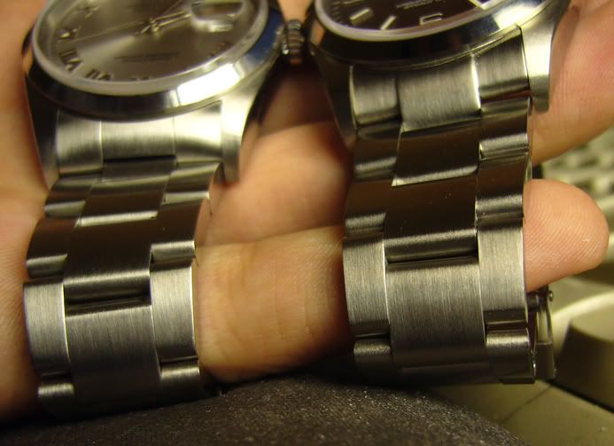

Some say they see no difference. Some say the 904 is "brighter"... Not the best pic here, but see for yourself...
Genuine on the left, Rep on right.

Thank you. I honestly don't see any appreciable difference and even Omega uses the 316L so it can't be all bad. Thanks again.

You're welcome... and 316L is not bad at all. I think 904 is mostly a marketing gimmick, and certainly provides no advantage to 99.999% of us... I don't know about you, but I don't keep my wrist around corrosive elements :)

I've had both 904 and 316L stainless steels in my hands at the same time- not on watches, but in flat plate form.
To me, there isn't a visual difference. That is, if both steels have the same processing and are brushed/polished by exactly the same methods.
Two watches, side-by-side, one 904 and one 316L, might well be different in appearance- as the two pictured above are- but IMO the diff is very small and probably you coulf make one look just like the other with a suitable application of scotchbrite, Mother's Mag Wheel Polish and/or cape cod cloth, plus a little dragon spit. :mrgreen:

I think you can easily tell which is 316 and 904 if you have some good lighting on it.
rep
gen
shinier and different hue

No comparison to 316 and 904. Looking at pictures on the net to determine how the finish of the steel compares is like pulling a pair of nylon panties over your head to read a book at night under low lighting conditions...
Try and imagine that- oh yeah - and the panties have been worn before too!!!
Now do ya got it?
Side by side, in your hand, you can pick out the 904 vs 316 ever time. The 904 ALWAYS has a brighter silver look to it. When you combine that with the fact that the 904 has a WAY and I mean WAY harder finish, the 904 almost always has little to no surface scratches on it like 316. Fakemaster is right when he says if you spend enough time on a 316 bracelet, polishing it and using the right treatments and techniques you can get it really close to the look of a 904 bracelet. The only major problem with this is that within a matter of just a few weeks (if the watch is worn regularly) the softer 316 stainless will develop a bunch of fine "desk diving" scratches all over the surface. The only way to get it back to 904 looking quality is to polish it out and touch up the brushed finish. This requires constant work, but can keep a 316 bracelet looking close to 904 in it's appearance.
The 904 on the other hand always stays "bright" and because it is so hard to scratch, really doesn't develop the "desk diving" scratches easily. A 904 bracelet can go months if not a whole year before it starts looking degraded.
The same is true for the watch head. Next time you have a genuine 16610 in your hands look closely at the brushed marks on the top of the case lugs. Then look at the brushed marks on the top of the lugs of a Rep. I guarantee you - you will see much "brighter", more pronounced brush marks on the Gen. That is because the Gen head is made from 904 too.
