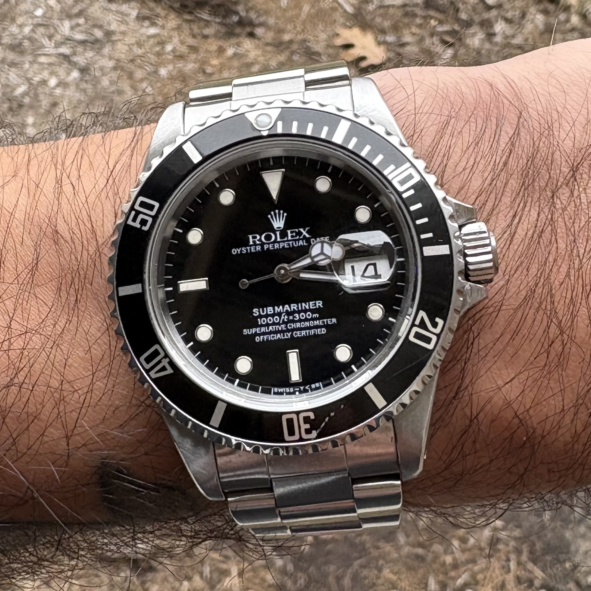

And heres a before pic:

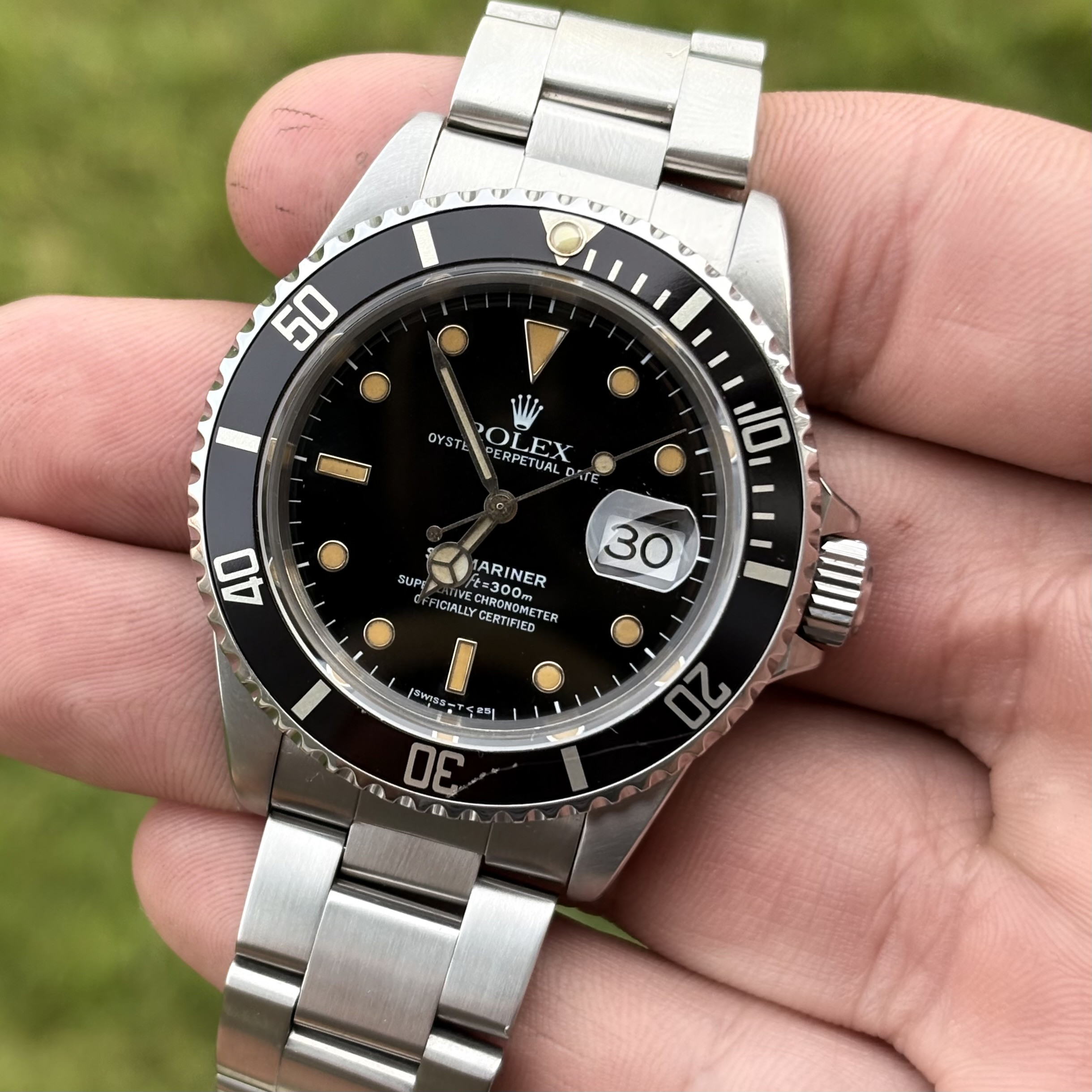

Here is an after pic:

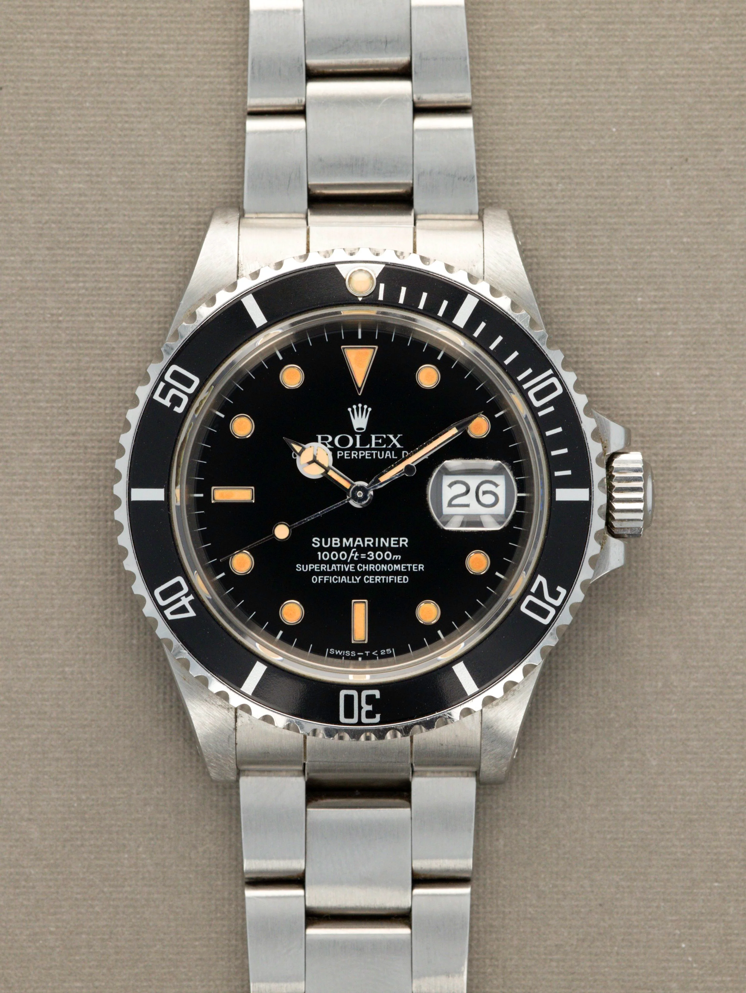

And my inspiration picture:

Overall i am very very happy with the outcome. Watch keeps +1SPD and is waterproof with some great patina. In the future i want to get a gen xtal and gen bezel to top it off. Til then ill be enjoying this on the wrist of my drinking hand.
