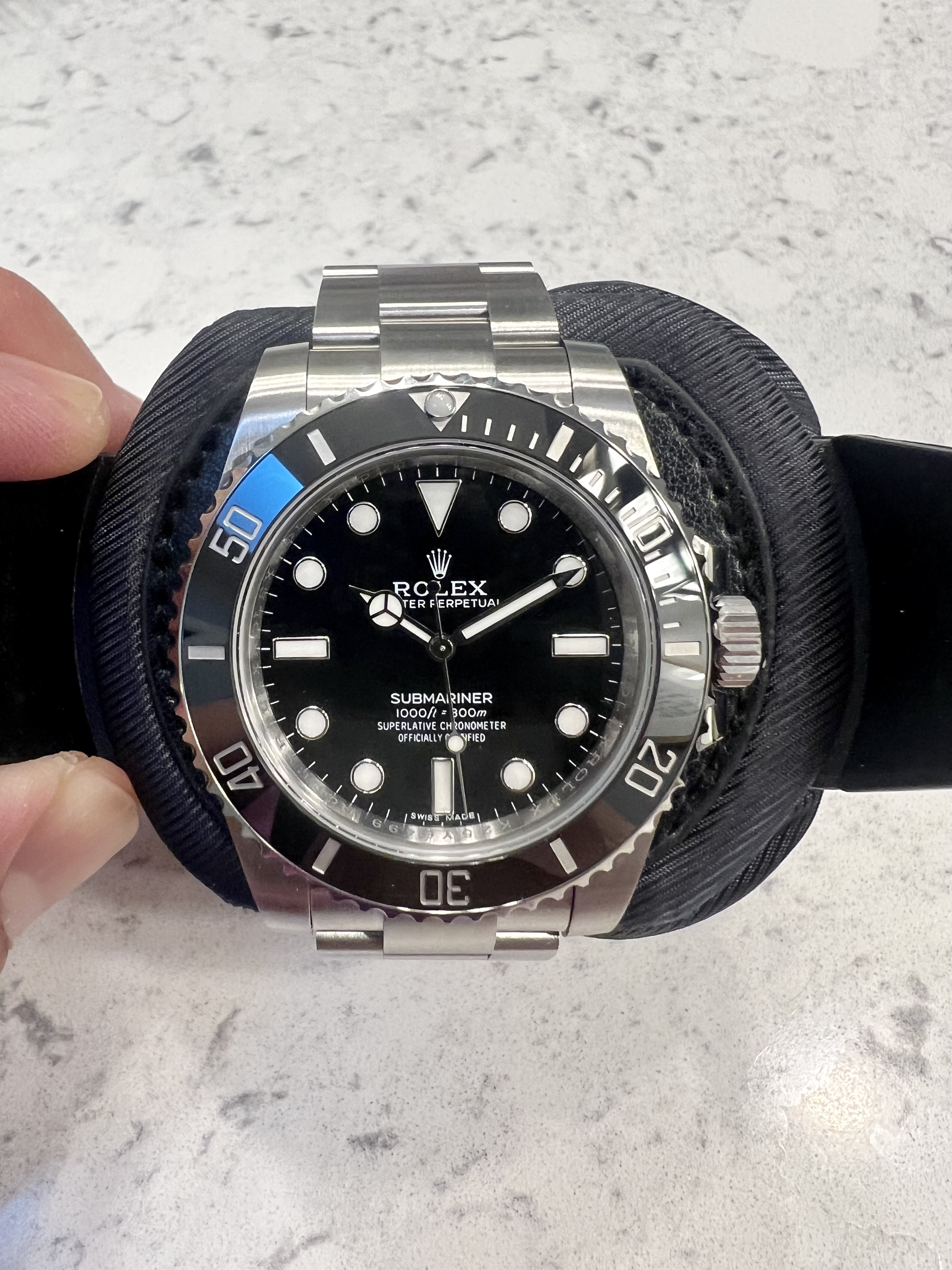

My 114060 holy grail, but regret watch. I have always wanted a no date submariner. I recently purchased the VSF 114060 from a TD and the watch is perfect in some many ways that you have indicated in your very comprehensive comparison. My regret comes from the wearability and size on my 6.5” wrist. After wearing around the house for the past two weeks, it seems just to big and heavy compared to my 38mm and 39mm watches. I think this is one of the greatest benefit from the rep hobby is that it allows people to “try before they by the real deal”. I will likely sell it and get the Clean 36mm Explorer I. Thank you again for your comparison.
