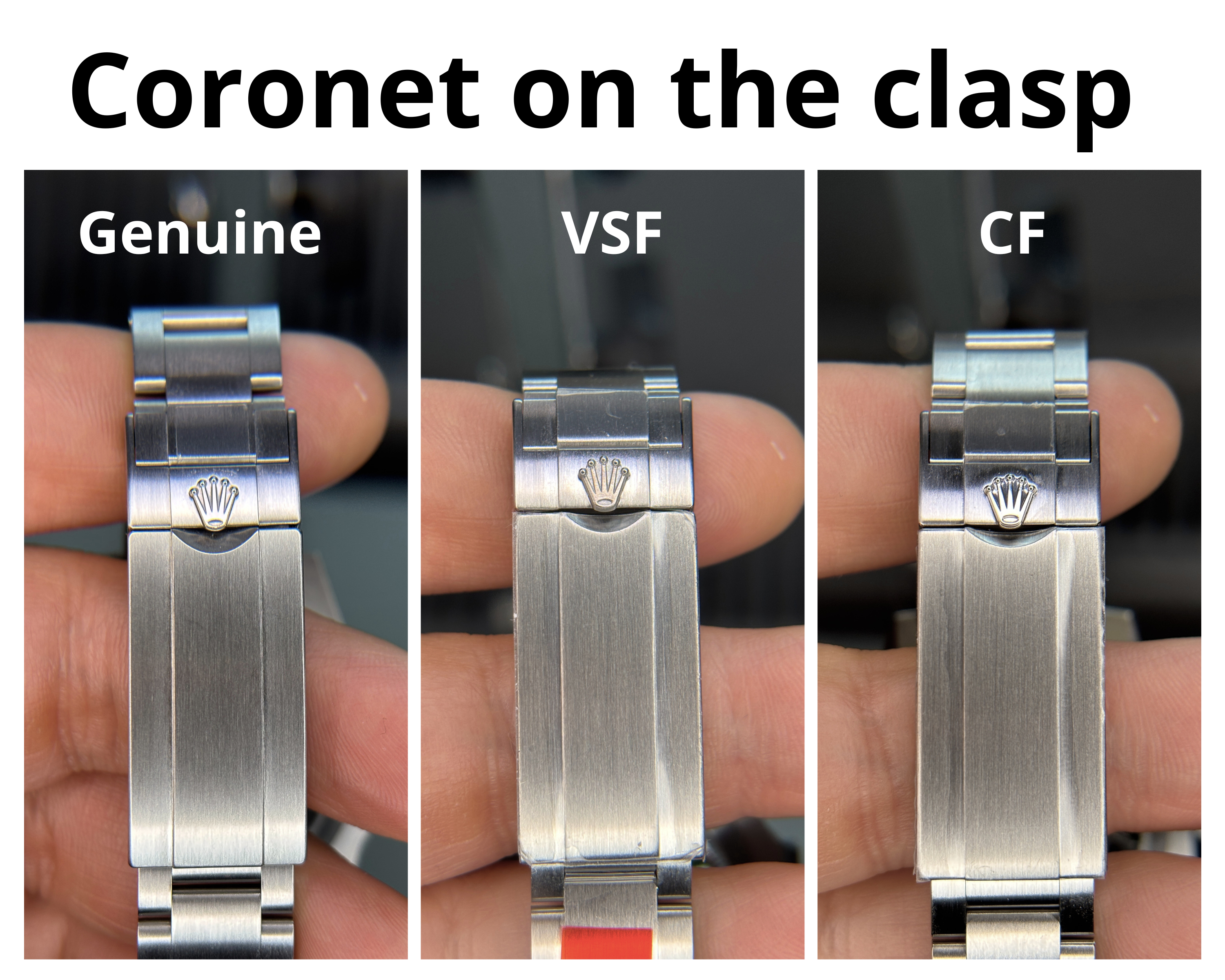

Maybe it's time for a quick summary, unless you'd like me to touch on some other aspect of the differences between the factories and the gen?
Here we go:
  1. Case – the win goes to CF. Better crown guards and the area where the crown integrates into the case looks much cleaner, without sticking out past the bezel. 1 point for CF. (1:0)
  2. Bezel – the feel of the bezel often depends on gasket placement and greasing, so I’m judging only the insert here. VSF takes the point with a better-executed lume pip. (1:1)
  3. Bracelet – I’d go for VSF, but only on the condition that it gets a proper SPA treatment. Sorry, ARF/CF fans. 1 point for VSF. (1:2)
  4. Dial – another point for VSF thanks to more accurate printing. One of you noticed that the applied index at 6 o’clock sits a bit too low. Still, CF’s printed indices are just too thick and sit too close to the rehaut for my taste. 1 point for VSF. (1:3)
  5. Handset – CF’s hour hand is simply too thick. VSF replicated it much better. 1 point for VSF. (1:4)
  6. Crystal – surprisingly, 0 points for both. VSF’s AR coating doesn’t match gen specs, and CF’s chamfering is way off. Removing the AR? Sure, but you risk damaging the crystal. Honestly, gen might be the way to go here. (1:4)
  7. Rehaut – clear win for CF, no debate here. 1 point for CF. (2:4)
  8. Movement – not comparing here, since you can get both versions with a DD3130 if that’s what you’re after.
FINAL SCORE: 2:4 for VSF
Dimensions:​
  • Thickness (with caseback stickered):
    GEN: 12.7mm, VSF: 12.6mm, CF: 12.7mm
  • Lug to lug:
    GEN: 47.9mm, VSF: 48.0mm, CF: 47.5mm
  • Including SELs:
    GEN: 50.8mm, VSF: 51.2mm, CF: 51.0mm
So, if I were to build the best possible 114060 from the two factories mentioned, my setup would look like this:
  • Case – CF
  • Bezel – VSF
  • Bracelet – VSF
  • Dial – VSF
  • Handset – VSF
  • Crystal – GEN
Would you go the same route as I did?

I just wrapped up my hybrid build (no Gen parts) and went with a slightly different setup. This was my first build, and aside from the pending crystal swap, it was very straightforward and easy.
Build details: Hybrid CF and VSF Sub 124060 41mm No Date
  • Case + rehaut: CF
  • Crystal: CF (swapping to Deep)
  • Bezel: CF
  • Bracelet: CF
  • Movement: VSF VS3230 (serviced)
  • Dial: VSF
  • Hands: VSF
  • Clasp: VSF
Some quick thoughts:
CF and VSF are great OOTB, so building this hybrid is unnecessary! However, I wanted to combine the best of each to make the best Sub Clone available (without buying Gen parts).
Bezel: CF's bezel is noticeably better than VSF's. It has a tighter, more satisfying click. VSF’s has some play and a higher-pitched sound that doesn’t feel close to Gen. Also, swapping bezels on six-digit Subs is no joke, which is why I haven't installed the Deep crystal yet.
Bracelet vs. Clasp: These should be judged separately. CF's bracelet is smoother, has better tolerances and finish, but the glide lock is stiff and clunky. VSF's glidelock is super smooth and way more refined.
Case & Rehaut: Some people rate the case and rehaut separately, but they’re one piece, so not separable. VSF’s rehaut can be polished to look more Gen-like, but CF wins for a more accurate case profile and better rehaut OOTB.
Second Watch: Once I install a VSF Clasp (ordered), polish the rehaut, and smooth out the sharp edges, I will have two great Subs with one slightly better in all aspects. I may also install a rubber strap and a Deep crystal.
Edited for clarity
