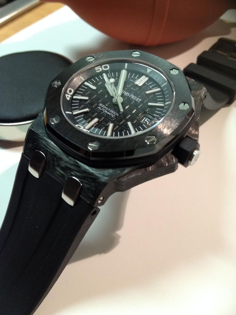

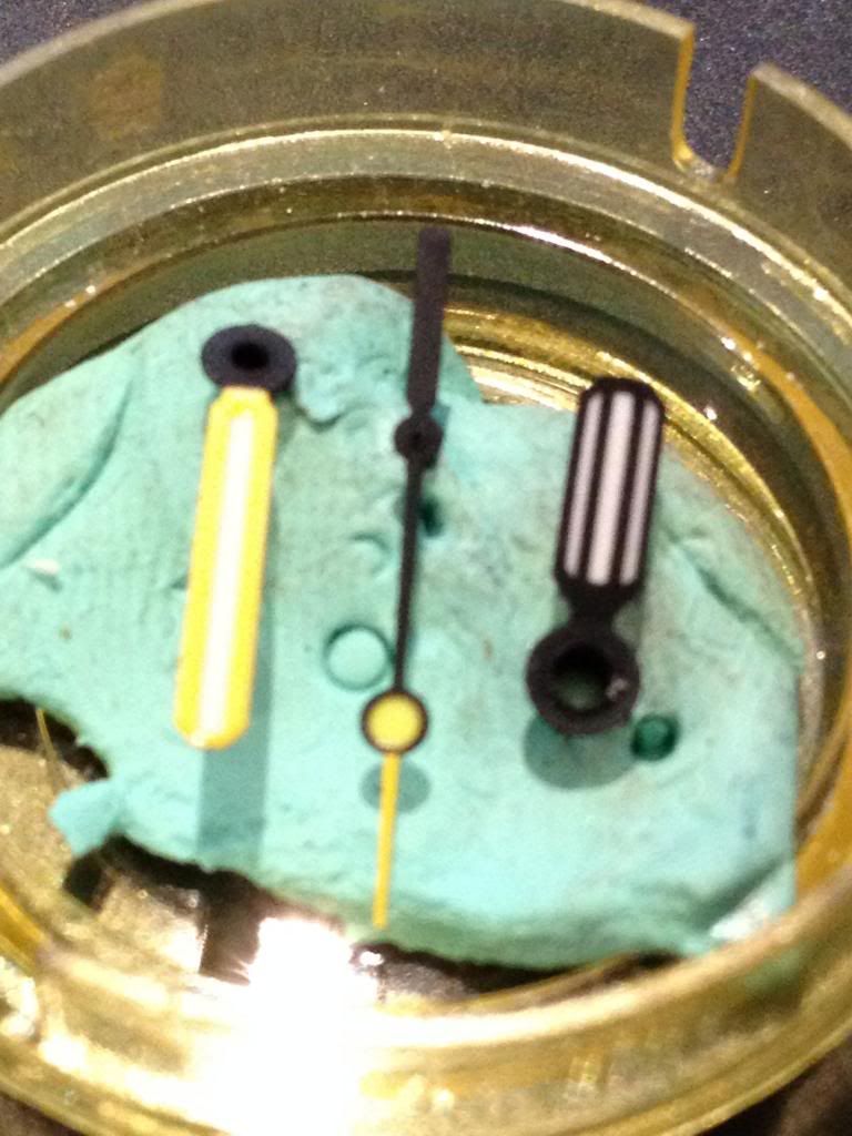

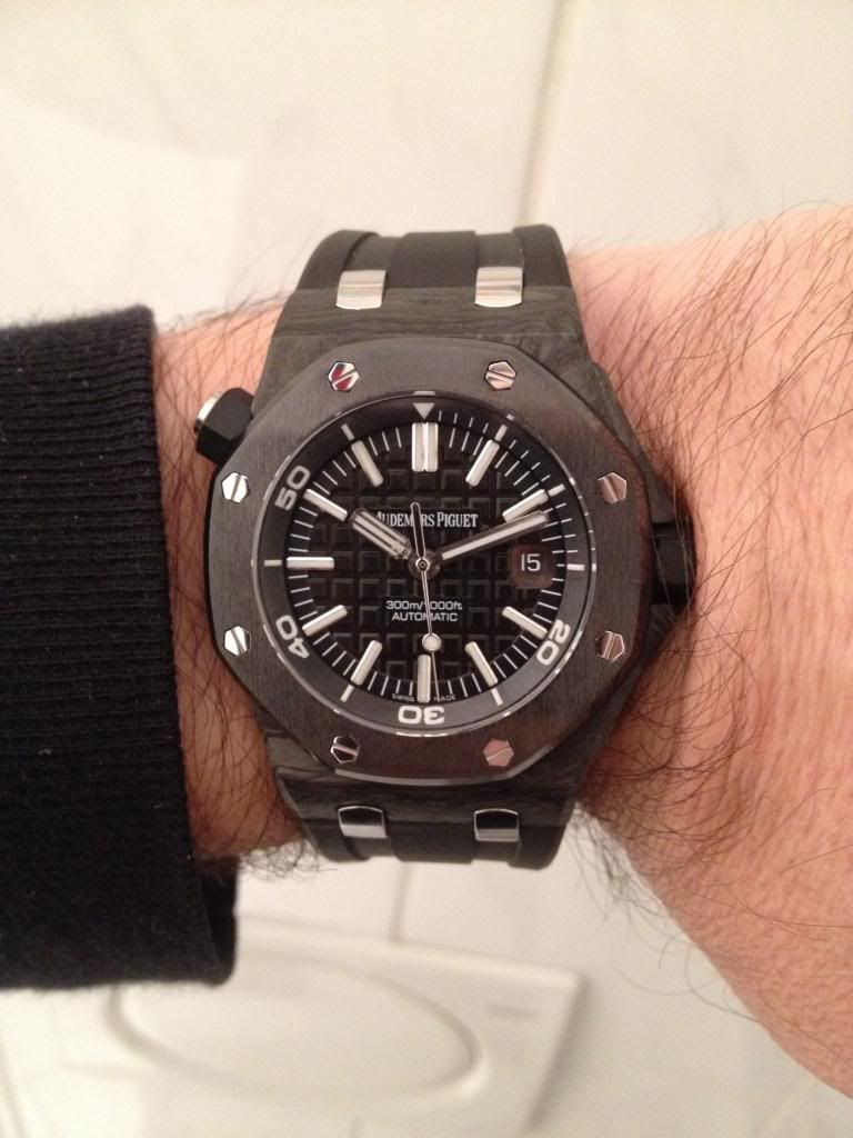

I am pretty sure this fantasy Diver combination has been discussed, but never really fully built, as it presents some challenges for a watchmaker along the way. The idea is to transplant the best parts of the SS Diver into a FC case, and omit all the funky yellow components (hands, inner bezel of FC diver). There was a lot of customisation and hot-rodding along the way, which only made the final result even more expensive and arduous to assemble, but which eliminated some of the most annoying features of the Diver for me.
Ingedients:
1) FC Diver 2 mid-case (the "wavy" not the "woody" case--look at LW's Spidolite for a FC case with the same wavy patterns, giving this V2 case a kind of design pedigree). Polished, of course.
2) Swiss ETA 2824 movement, serviced by me.
3) FC Diver 2 ceramic bezel and polished bezel screws
4) Noob Diver 3.5 dial, with double-AR cyclops, and C3:C1 relume of markers, did not like the original lume
5) Noob Diver 3.5 hands, with C3:C1 re-lume, to match the dial
6) Noob Diver 3.5 DW
7) Noiob Diver inner bezel, re-lumed with C3:C1, to match the dial and the hands
8) Noob Diver 3.5 Xtal, w/ double-AR
9) polished end-links
10) gen Diver strap w/ custom DLC buckle
Photos:
Swissy inside:
No need for these:
On the work bench:
On the wrist:
No annoying cyclops reflection. :adoration:

Other side does not work either. Sometimes, like guru also experiences, one needs to drill out the hole on the end-links to 1.5-1.6mm to accommodate the metal inserts.
But I fitted an AP Bands hornback black/white successfully. You were right: Looks much better than the rubber. (Lesson #1 of RWI: Always listen to Sharrkey when it comes to matching straps to APs).
I am wearing this to the wine cellar now. I worked 11 hours straight on it. Time for some Bordeaux!

just amazing! I want a 5.1 like that !!:drool:
did you thought about having the bezel screws all black?
slaughterer62
DO NOT TRADE WITH ME
27/1/13
9,280
1,892
Sometimes the silver bezel screws irritate me on a black bezel, it is true. But with this fantasy, I wanted to have some chrome bling, so I left the bezel screws silver, and polished the end links. There are really only two or three colours here: black, silver, and white. BTW, this watch glows like a torch in the dark. Not like a wimpy rep lumed Diver.
