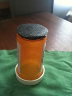

While I do have a proper Rolex case back opener, with a full set of dies, I have found it is still very difficult to use without incurring scratches.
So I made my own and it has never failed to open up any size for me, it will not scratch and it enables you really tighten the case back when you reinstall.
Materials: 1 - Prescription Pill bottle (mine is the diameter of the case back of a full size, ie - Submariner case back). Mine is slightly con-caved on the
bottom, so it follows the domed contour of the case back.
1 - Roll of Heavy Duty Indoor / Outdoor Carpet Tape
I cut the carpet tape into circles the same diameter as the bottle. It seems to work best with 5 layers of carpet tape circles (adds a resilient cushion that conforms to the shape of the case back, plus more grip).
Just place directly onto the back and while firmly holding the watch case, press downward and turn the bottle. Viola...the case back stays stuck on the bottle making it very convenient to reinstall. Be sure to change the tape with each use.
