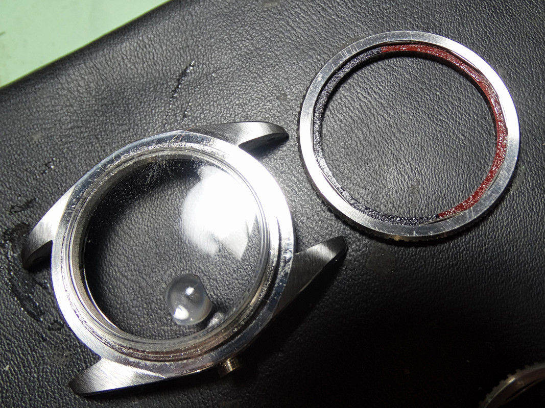

Bezel does not turn on my watch. After disassembling it I realized the problem was the plexi insert being glued on the retaining ring. Most likely fixable.
The insert itself, although looking good, is really too thick and cannot easily be thinned down properly. I think it would just be better to smoothen the edges down.
Bezel ring edges are really too sharp and need to be sanded down and smoothened.

1 - The insert wasn't even properly stickied to the bezel ring, they forgot to peel off the 3M sticker on the double sided tape. it was friction fitted on and would have fallen off.
