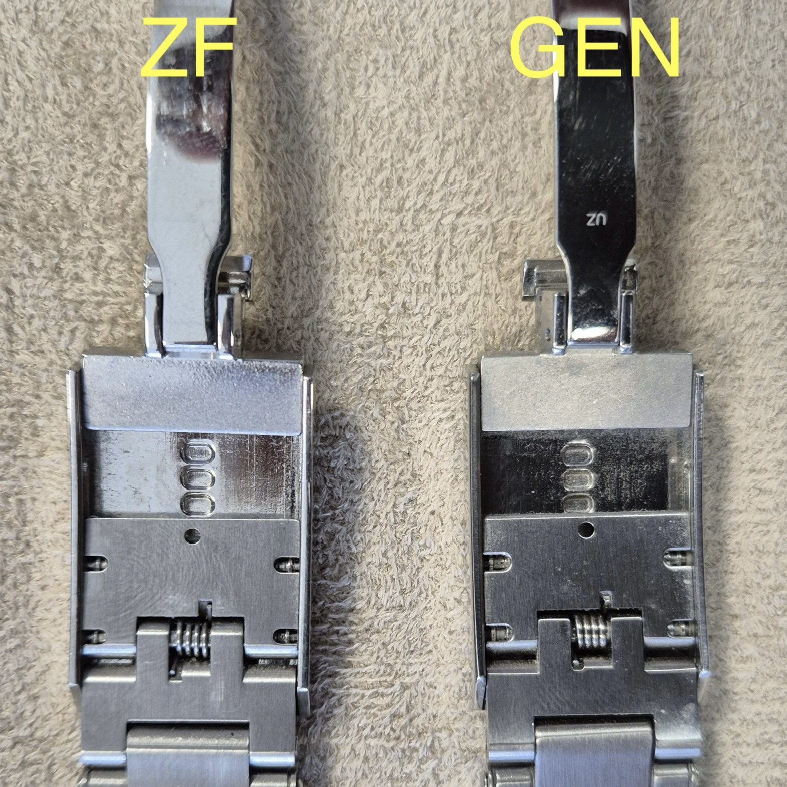

Very informative, and I think I'll try his approach if I can't figure anything else out, but I wish there were a solution that didn't involve taping the watch. I feel like that's not going to last long term. I'm wondering if anyone has a gen t-fit clasp they'd be willing to take apart to see what the differences are. I took my ZF clasp apart and here's my observations:
The small slots visible in front of the clasp are either to visually judge where your adjustment is set, or the ZF one is missing something. They serve no physical purpose in mine. There's a hole above them, and the inner diameter of the top of the hole is narrower for a fraction of a millimeter than the rest of the hole, almost like it could capture a spring that pushes down on something that could engage the small position slots. This second point of engagement might make the difference, but from what I can tell by online videos and pictures, I suspect the hole is also empty on gen. Weird design if so.
The thing I suspect is the actual issue is the "bar" that fits down into the long slots has a rounded profile instead of being squared off. This allows it to slip out of place instead of locking in place. I can't be sure without a gen one to compare, but here's a screenshot from a youtube video, it seems to me this gen example "bar" may be more squared off. No idea on the slots themselves vs gen, but the ZF I have has at least an approximation of a squared off profile.
I also don't know if this "bar" came this way or immediately rounded off due to wear. If it did, it wore down extremely fast. As I mentioned, it was slipping the third day I wore it. Here's some poor attempts at close ups so you can see how rounded it is:
My final thought is that the spring on the gen looks to be thicker and thus probably stronger on the gen. Look at the middle image below, it's the t-fit style in question, and the spring here looks slightly thicker than mine. This is a marginal guess at best, it's too hard to tell in a photo, but just another thought. A stronger spring would hold the bar down in the slot with more force.
That's all my thoughts for tonight, if you have a gen you're willing to take apart, I'd appreciate it. Unless someone else has any better ideas, I'm going to try sticking some tape in there for now.

I had the same problem on my bb pro with the slipping clasp, I compared it to my genuine pelagos 39 clasp and found out that the spring uses a much harder material as the rep one therefore you need more force to adjust it.
For me the solution was to take the spring out and bend it a little bit to the outside so when it’s in place it’s much harder and doesn’t slip so easy …
