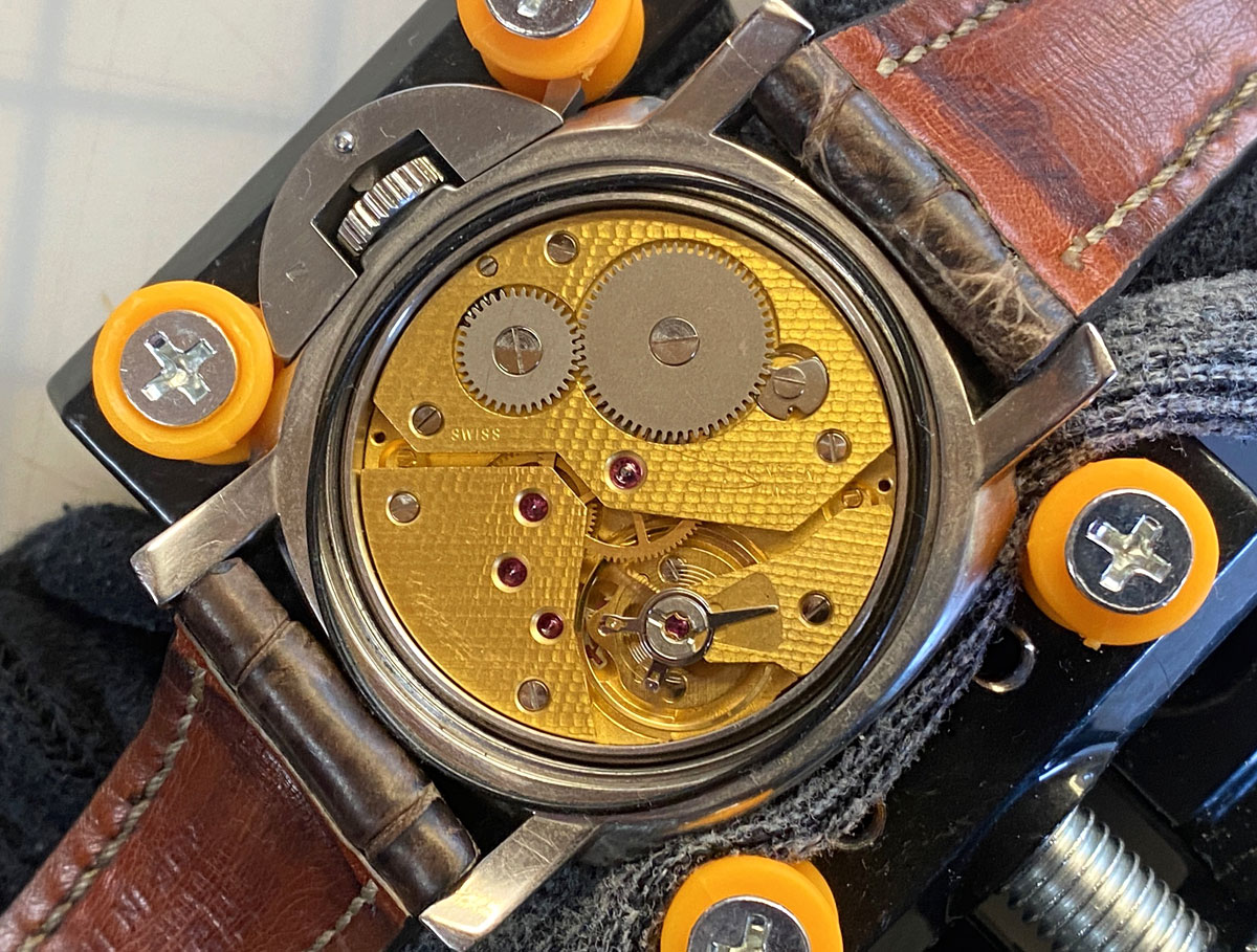

I opened her up and found that the rear gasket is not only dry but very stretched. Hopefully, that's the main problem.
