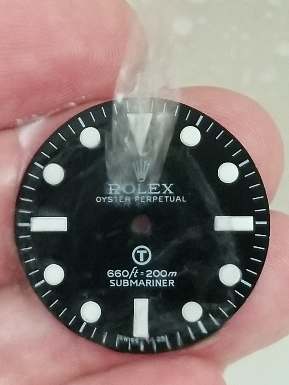

Dials
I tried washing a junk dial one day just to see how it went. It worked well so it's now my default cleaning method. I use a good quality artist paint brush and mild dishwashing liquid. First close the sink stopper in case a dial marker comes loose (never had that happen but no need to risk it). Get the dial wet, soap it up good, rinse and blow dry with an air puffer. Sometimes you can get a water spot or two if you don't dry it fast enough, just wash the spot away, rinse and blow dry again.
This technique should not be used on matte dials or if you have water based lume. But on most of our rep gloss dials with lacquer based lume it will leave them flawlessly pristine. I've done this on dozens of dials, including a gen dial.
I always recommend trying any new technique first on junk parts to see how it goes and to get practice. Make your mistakes where they don't matter.

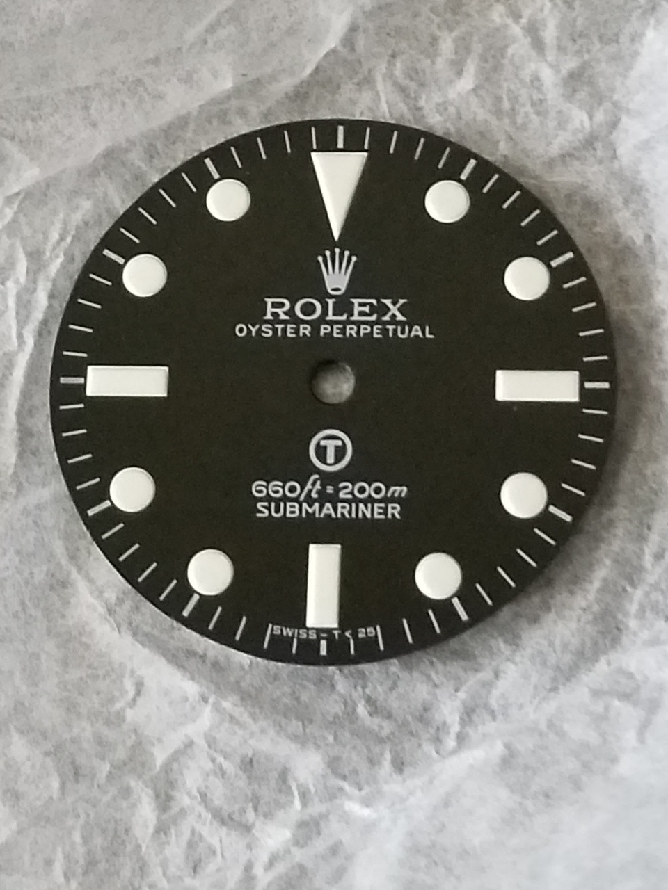

A couple other examples

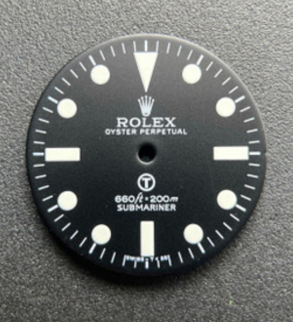

I've been asked about washing matte dials, so I finally tried one. I hand shaved this Raffles dial about 1.2mm (0.6mm all around) and wanted to wash it as that's the best way to rid it of all dust, debris and metal and paint particles. The dial suffered no damage whatsoever, not even the lume plots. But examine them carefully before trying this. These lume plots clearly had been applied with some type of laquer or varnish - they had a slightly glossy clear glaze on them so I knew they could handle a gentle bath. Ofc it never hurts to do a tiny test on one lume plot with a water dampened paintbrush. Just touch it lightly and see if there is any indication of thinning or spreading. then progress to more water exposure if all looks well. Be cautious, careful, and do this at your own risk. Many of these dials are not greatly expensive after all.
Original diameter
Shaved
Washing

Thanks for sharing. How would one go about cleaning a matte dial?
ward1991
24/7/13
3,470
3,499
Rust Belt
Just use matte water.
Vaselume Miracle 2-in-1 Knob N' Hole Polish™️
Seriously though, with matte dials, I just rodico it really well and blast it with multiple coats of matte krylon spray. Will hide a great amount of imperfections easily.
I've never tried it so I can't say how water would affect the surface. But the lume could be a problem if it's water based. It would dissolve and run.
I might have a junk matte dial I can test, but in the meantime I would stick to the usual methods of dry cleaning - light touch of Rodico or not too sticky tape, dry lens cloth, dry artist's brush, dial cleaning pen, air puffer etc.
