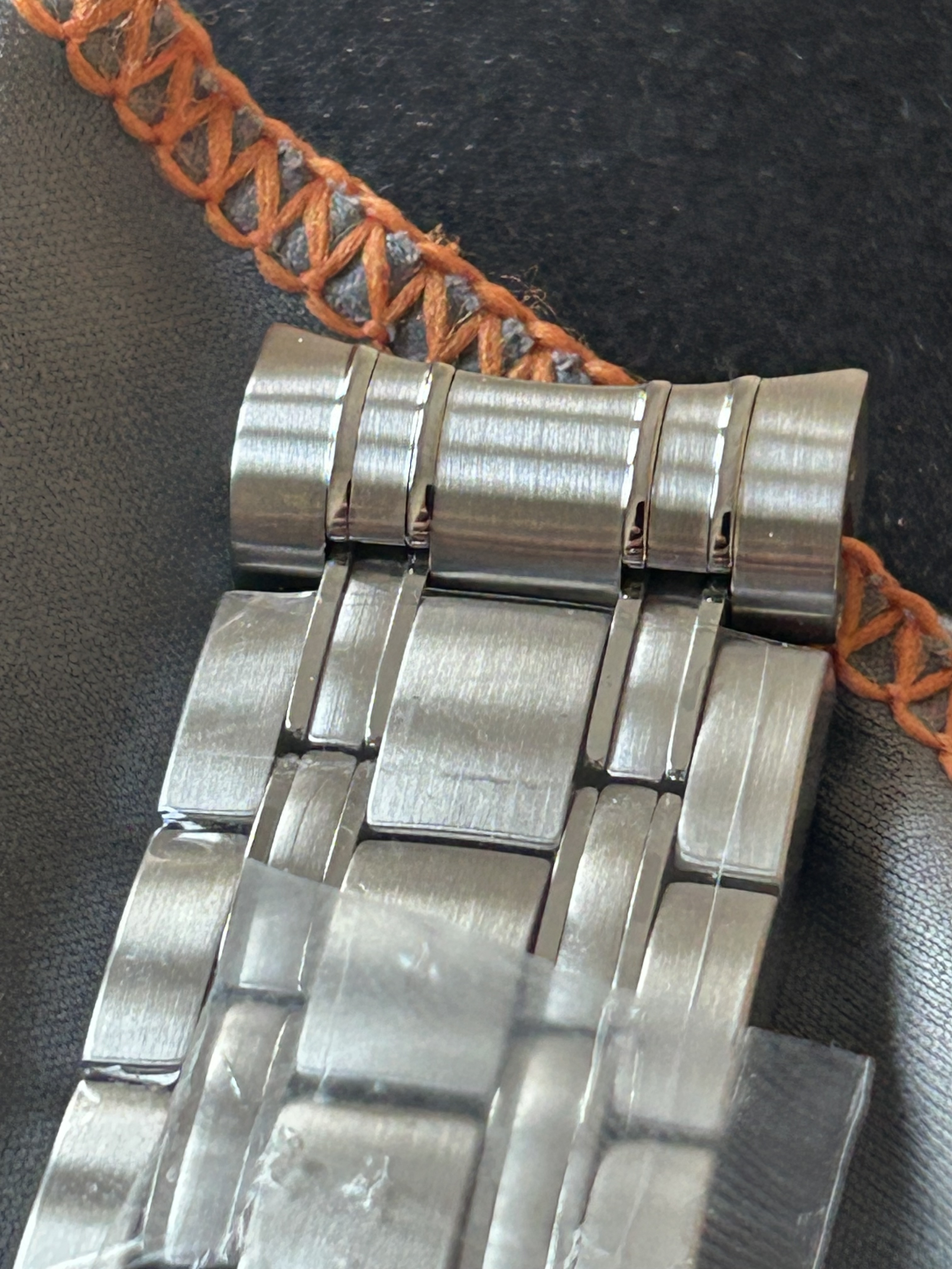

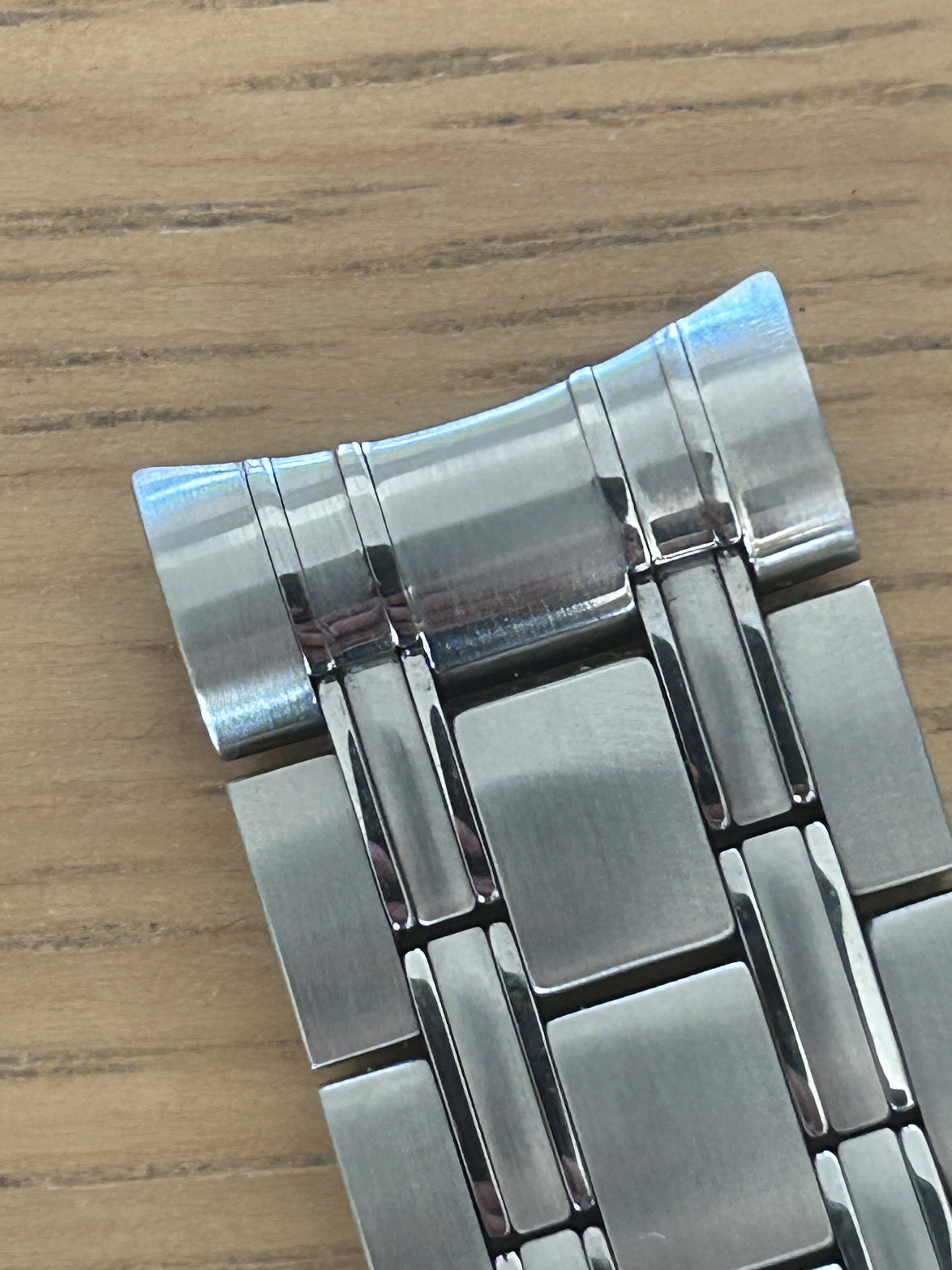

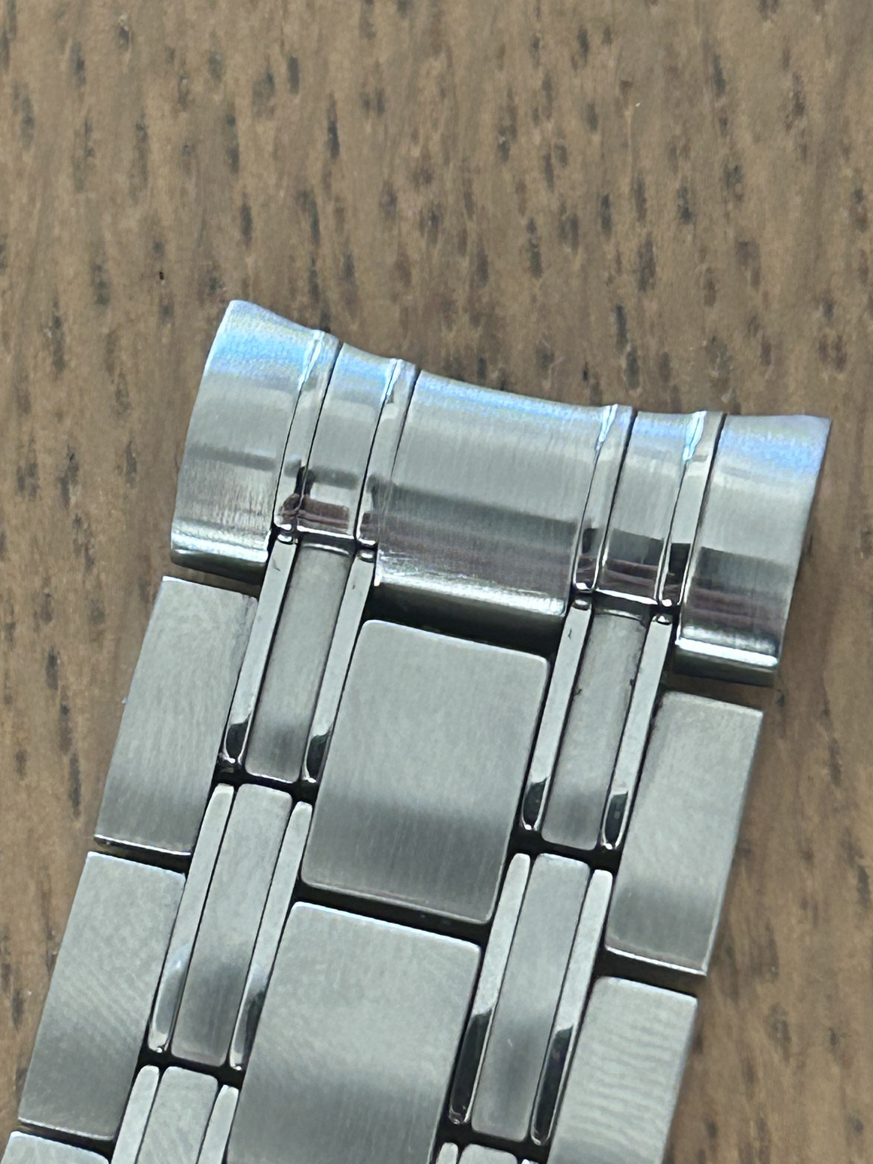

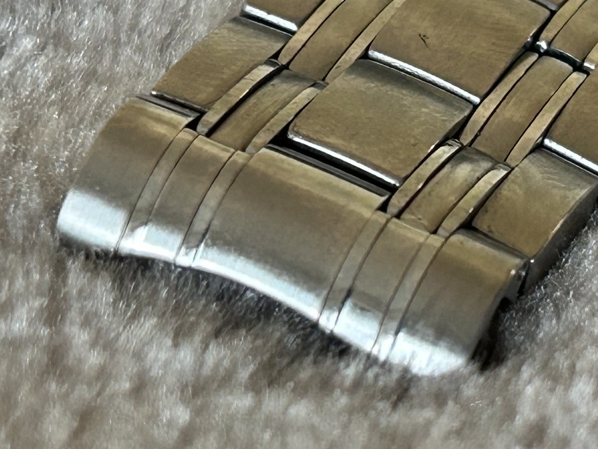

So I found the polished sections of the VSF seamaster bracelet to be an instant tell.
They are raised and humped for want of a better description. Forming a ridge rather than a flat polished surface like the gen.
So to improve this, I started with a flat emery board for nails and gently removed some of the material on the raised polished sections of the end link.
After this I used several grades of fine sandpaper to polish the sanded section back up and gave the entire end link a good polish with a cape cod.
I then used modellers masking tape to section off the polished from the brushed areas and re brushed with a medium grit Garryflex block.
This is the end result.

Just need to finish the brushed section with a 600 grit brushing to get a close match to the rest of the bracelet.
