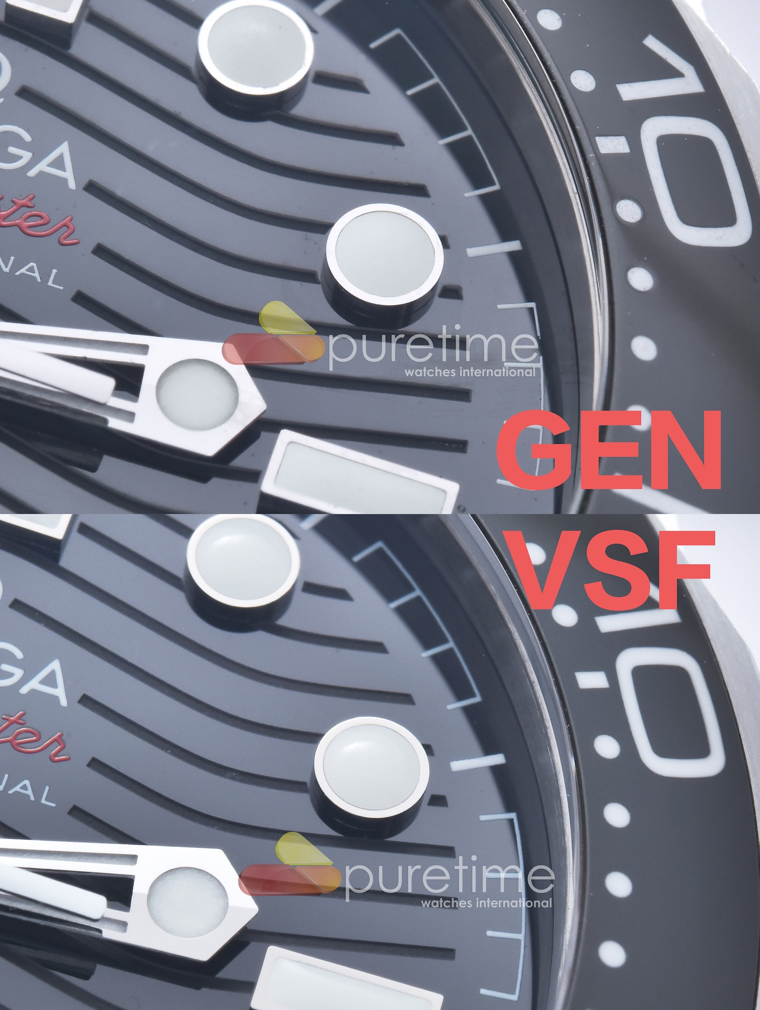

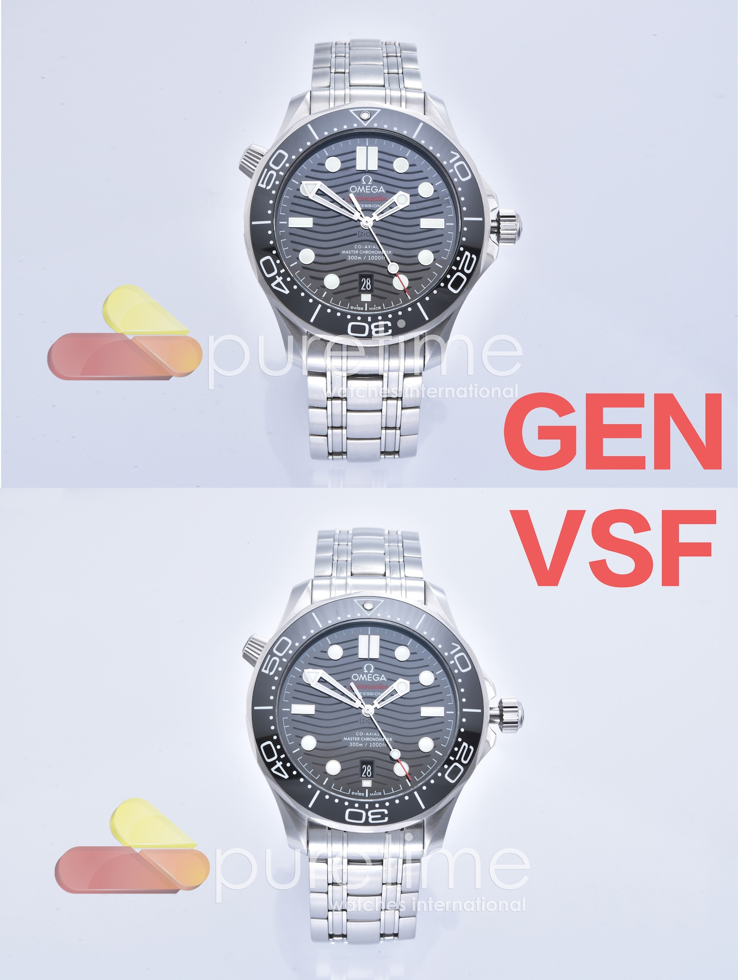

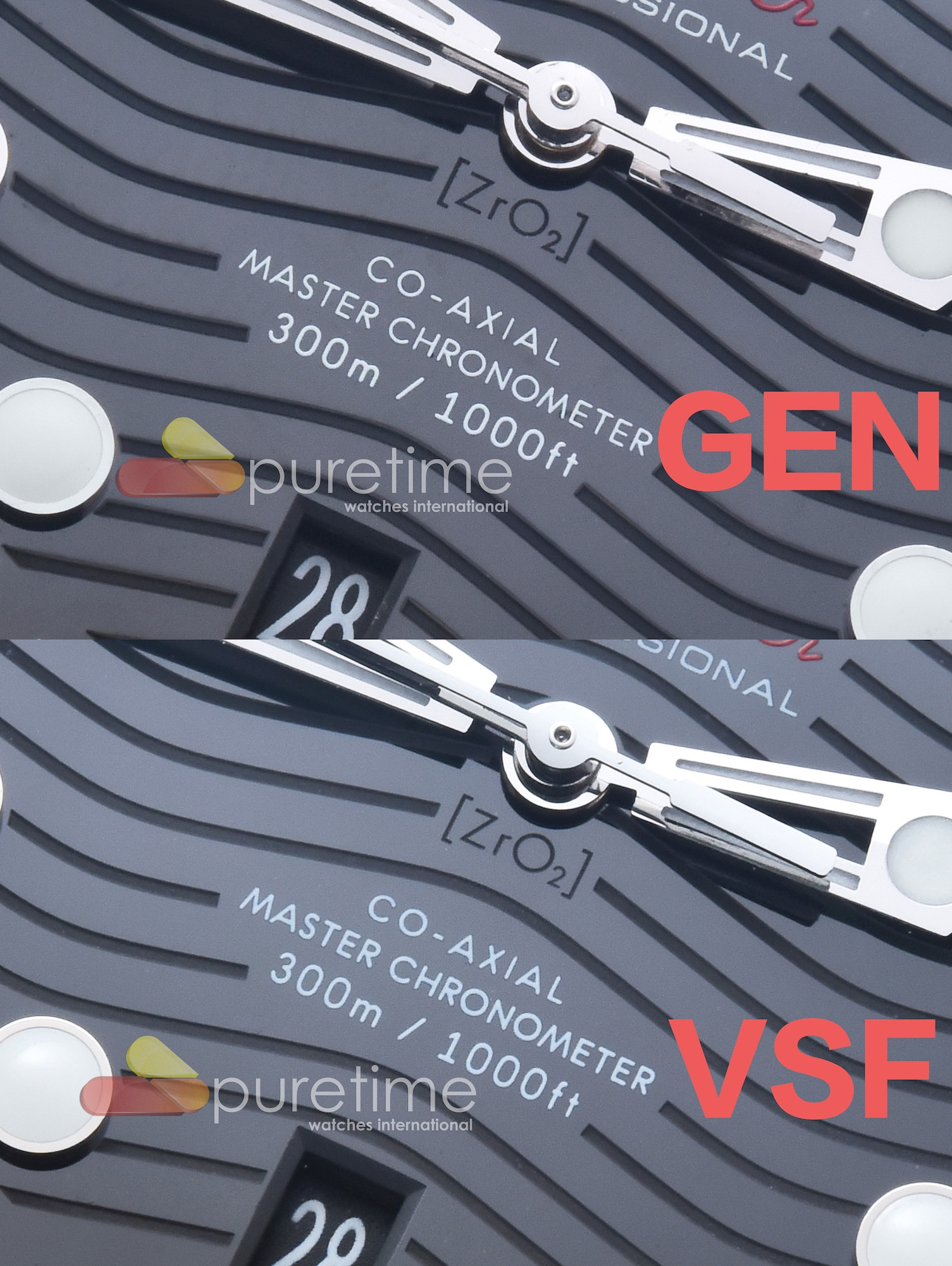

The Seamaster Diver 300M has long been one of VSF’s most iconic and best-selling releases. As the model that first put VSF on the map, it’s been a consistent favorite among collectors for years.
Now in 2025, VSF has finally upgraded this classic with their newly developed 8800 Super Clone movement, bringing it even closer to the genuine Omega in both performance and appearance.
Let’s take a detailed look at how this latest version stacks up against the GEN. Feel free to drop your thoughts or ask if you want comparison photos or movement shots — happy to share more!

Great pics, thank you! This looks like a super rep!

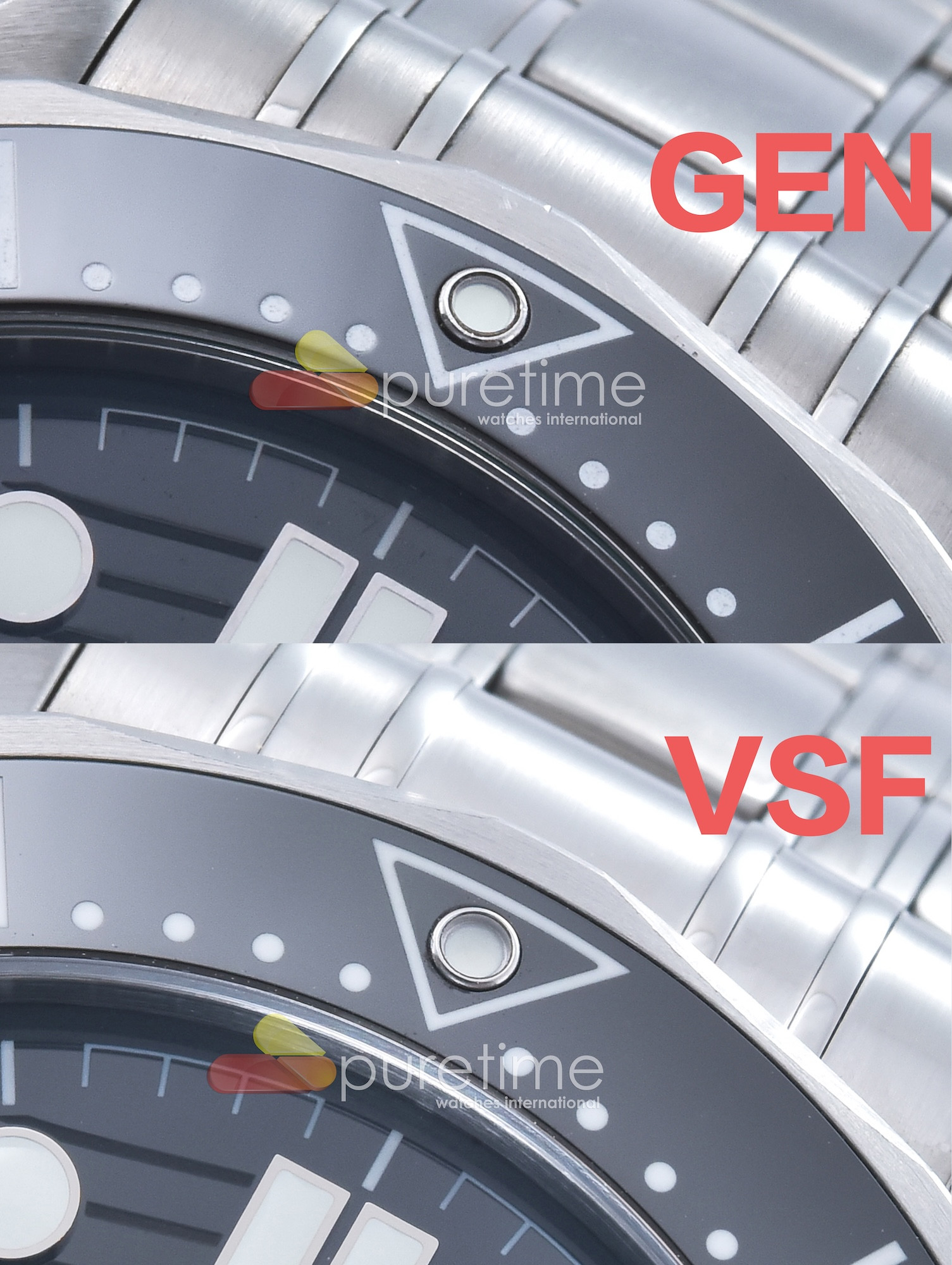

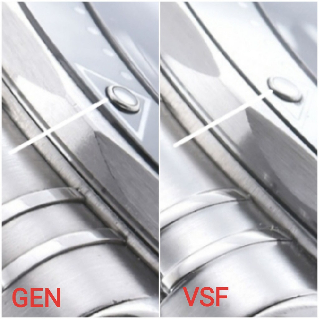

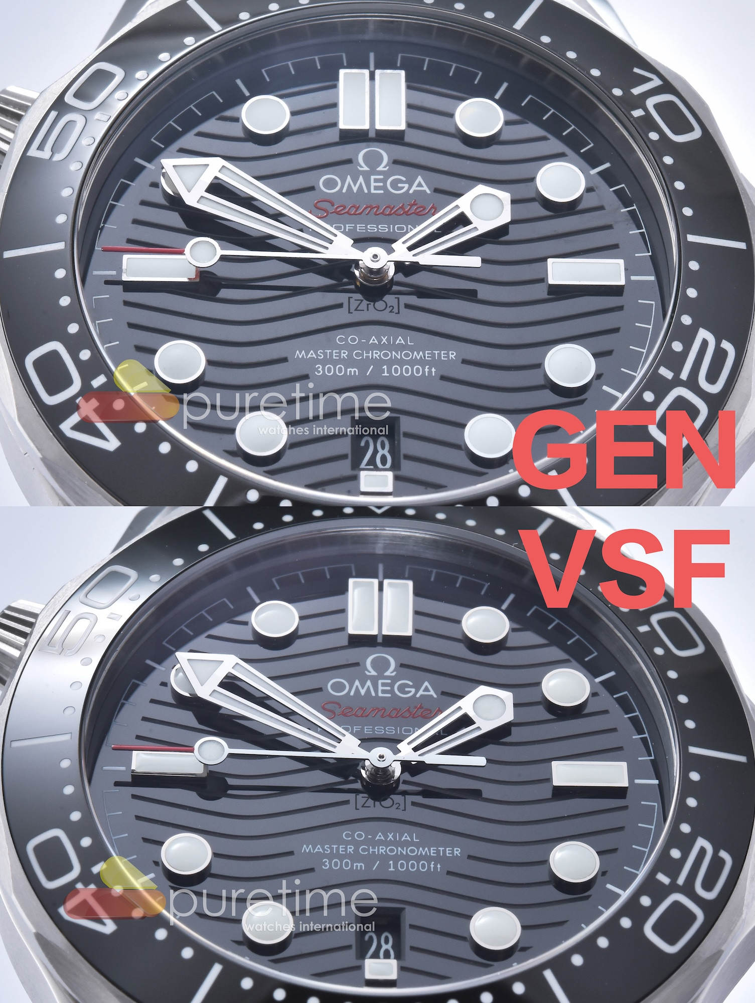

One small but quite disappointing flaw - can't VSF take another 30 seconds and align the bezel "teeth" properly with the pearl and the other insert markers? This is not a look most of us will appreciate once seen, and many of us will feel compelled to correct it. The correction is an enormous hassle or expense compared to the minimal effort it would take to avoid it.

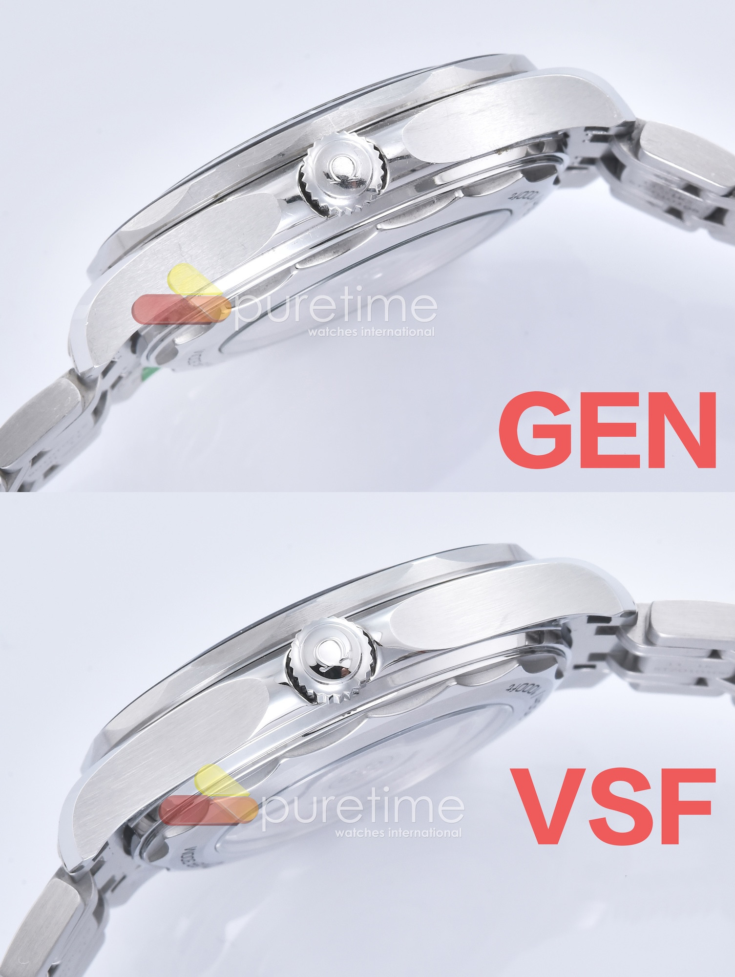

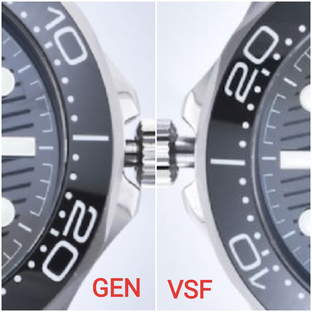

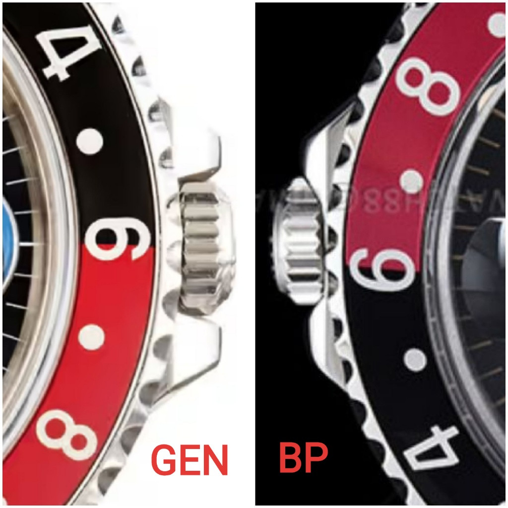

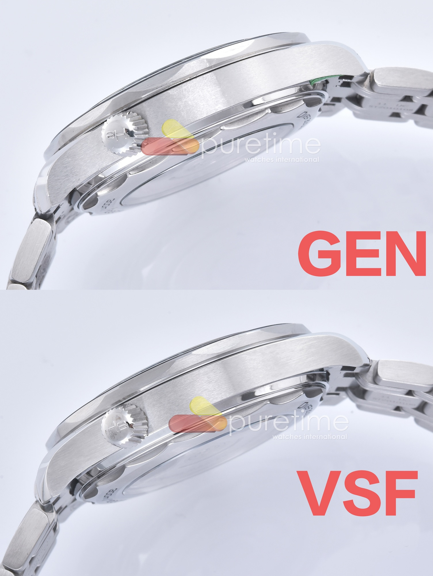

What is the point of investing money in producing a clone movement if they can’t even ‘Clone’ stubby the crown guards, I would rather the fixed that a new movement.

I've heard it before and I get it that the CGs aren't just like the gen but I don't think it's terrible. Check out the difference on the "best" factory rep 16710 vs the gen.

with this new version vsf solved the crown problem?

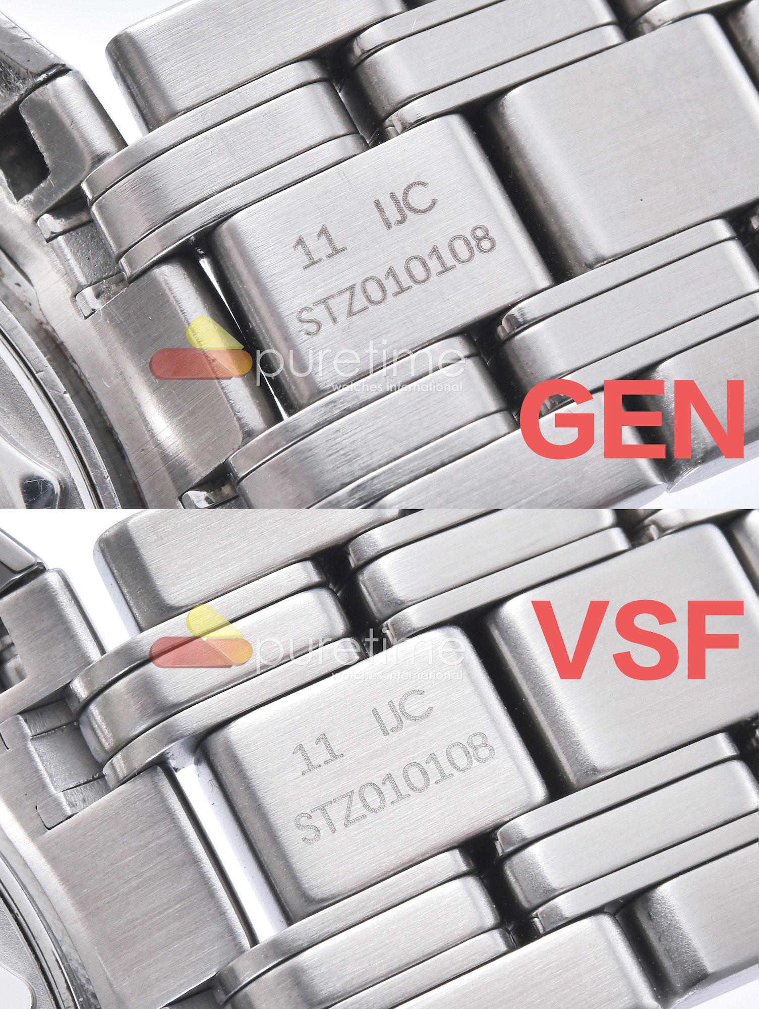

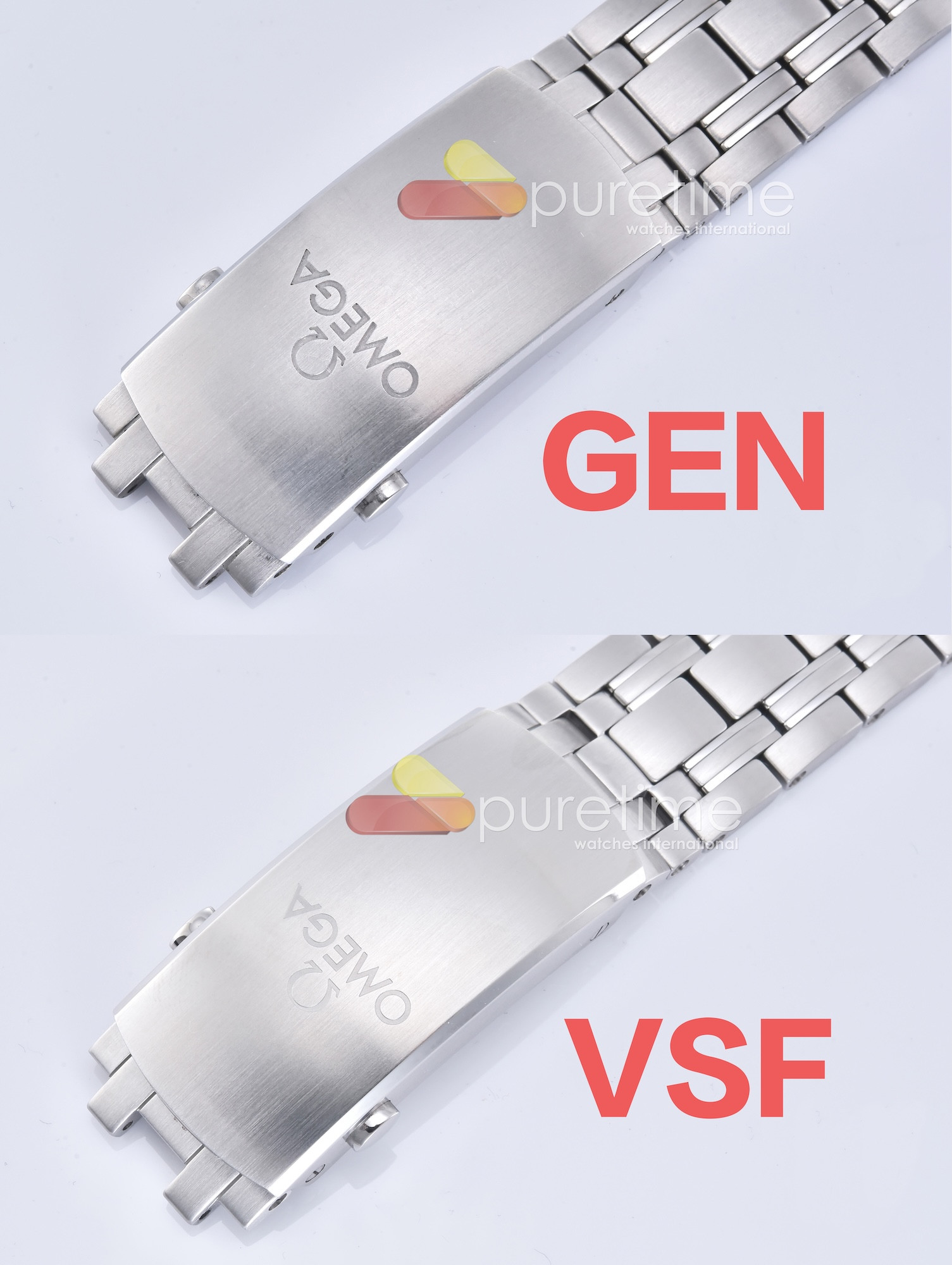

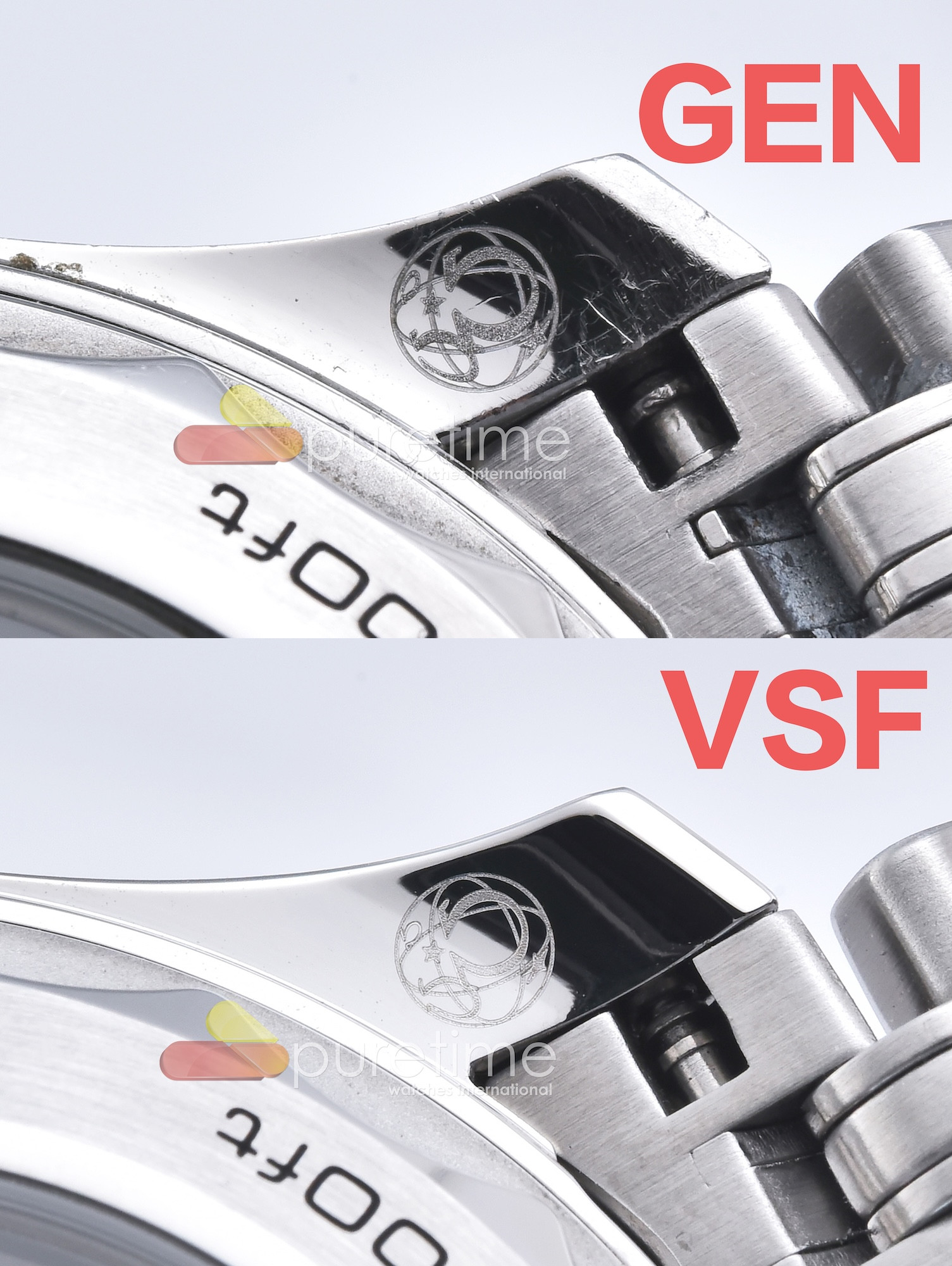

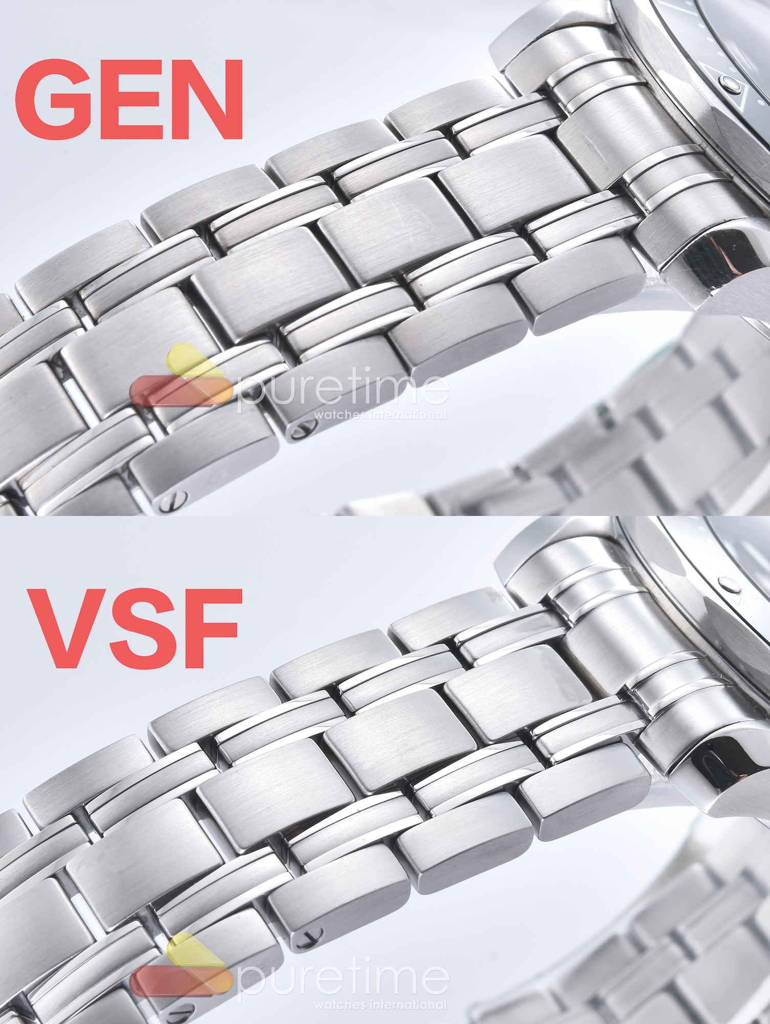

Anyway, a 'flaw' that is common in a lot of Reps (except Rolex, Tudor, PAM maybe ) is the engravings on the back and on the clasp, i am always able to spot the rep in this way...
VSF did a really good engraving on the back side, but on the clasp...

Creatively photographed to not show if the crown guards are better at all. Come on puretime show some better pics please of what might be (or not🤞)improved cg’s!

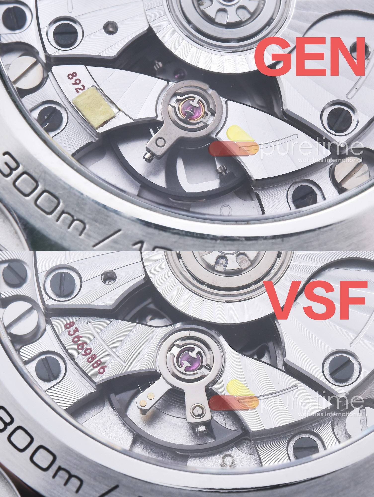

Do you think that we can "hide" second regulator arm under the fake one? Or they are side to side, same height?

Neither of the regulator arms you see are fake.
They are both fully funcioning as per any other VSF movement clone. VSF has yet to rep a free-sprung balance that requires micro-stella screws on the balance wheel to regulate.
The regulator arm with the gold stud rivets is the rate (fast or slow) regulator, the other regulator arm is the mobile stud carrier to regulate beat error.
Unless they had to completely remake the case to fit the new movement, I would not think so.

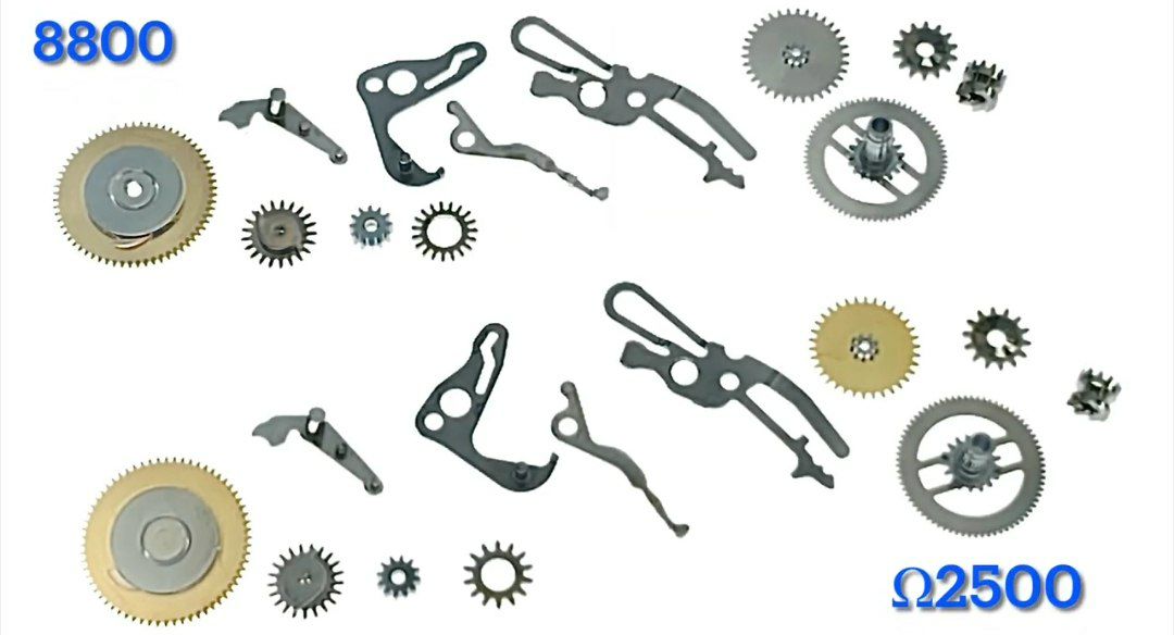

I was wondering before why the 8500 was "copied" earlier than the 8800, as it a completely new designed movement. Oposite to the 8800, which uses a lot of design and components from the swatch family movements..
