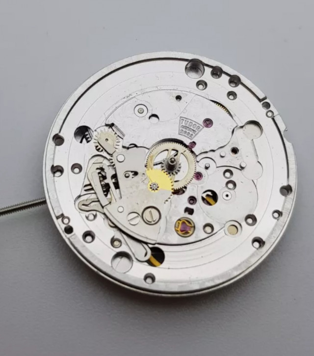

Hi all,
I have a gen Tudor eta 2892a2 movement I am interested in making a build around. It was used in a Tudor Monarch). Datejust like watch.
My first thought was to buy a ZF black bay 41 that comes with a clone 2824. I know that is 1 mm thicker and I am not sure if this has been done before. Also, the date wheel will need to be replaced and I was hoping to use the one from the ZF Tudor.
Is there a way to make this work? If not, any other ideas for this movement? Thanks ⏱️
