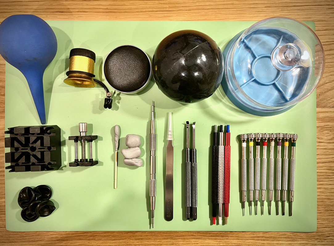

I've been asked a few times now for recommendations on tools / supplies by folks who were interested in getting started on doing some modding, so I thought I'd share it here as an additional reference for anyone who may find it useful, as I've learned so much just from reading all the threads and projects here. None of this will be new to the experienced folks, so please excuse the repetition - I just hope that this will be useful to a potential modder who wants to dip their toe in!
Needless to say, when the senior folks here recommend you not cheap out on a particular tool, you really shouldn't cheap out, coz inevitably, you'll end up buying the more expensive version after your cheap one fails immediately, or after 1-2 uses. Anyway, I started exploring 5-digit and 6-digit subs, and when the perfectionist in me couldn't resist wanting to franken those I started looking into doing dial / hand / movement gen swaps, which is what the toolset in this post is focused on.

- Finger cots - buy as many as you like, these will help protect your fingers while protecting all the watch parts from your sweat/grease: https://www.aliexpress.com/item/1005001742018329.html
- A good quality screwdriver set (note - these come magnetised): https://www.aliexpress.com/item/32372285605.html
- A degausser to demagnetize the screwdriver set above
https://www.amazon.ca/gp/aw/d/B06XSQ8PDD/
- Tweezers - Get 1-2 really good quality ones here, it makes a huge difference
- Dumont #2 anti-magnetic: https://www.cousinsuk.com/product/dumont-no2-medium-tips
- Bergeon Brass AM: https://www.cousinsuk.com/product/brass-tweezers-bergeon-swiss
- Note: Some folks like to get curved end tweezers and/or Delrin tipped tweezers - it's always nice to have tweezers that are less likely to scratch hands
- Movement holder - there are fixed size options with changeable inserts or adjustable ones
- Casing cushion: https://www.aliexpress.com/item/32966468268.html
- Parts tray with dust cover lid: https://www.aliexpress.com/item/32895962771.html
- Dust blower: https://www.amazon.ca/dp/B078Z53XY2/
- Caseback opening sticky ball: https://www.esslinger.com/bergeon-8007-watch-case-opening-ball/
- Non-slip bench mat: https://www.esslinger.com/bergeon-7808-non-slip-bench-mat-9-5-x-12-5-inches/
- Rodico (very important for cleaning off dials and crystals, as well as using a small amount on the end of a toothpick to help with placing hands): https://www.esslinger.com/bergeon-7033-rodico-premium-watch-cleaner/
- Hand removal levers - if you go too cheap here, the forks will snap after a couple uses: https://www.aliexpress.com/item/1005002628667619.html
- Dial protector vinyl sheets - these are really important and come in handy for more than just dial protection, so get a few: https://www.esslinger.com/bergeon-protective-vinyl-sheets-7982-pack-of-3/
- Hand pressing tools: https://www.amazon.ca/gp/aw/d/B07VPCSC84
- Note: I tried the fancier one with the spring / stand and changeable tips, but I just didn't have a great experience using them given how finicky installing hands can be. So I ended up switching to the individual handheld pressers, and found these way easier to use
- 5x or 10x loupe: https://www.esslinger.com/four-eye-loupe-magnifiers-set-with-headspring/
- If you wear glasses like me, splurge on this glasses loupe clip - it's a game changer: https://www.esslinger.com/bergeon-7913-loupe-holder-clip-for-eyeglasses/
- Silicon grease for regreasing caseback gaskets before you close up the watch: https://www.aliexpress.com/item/32966320671.html
- Optional case holder to hell you with grip when you’re removing the caseback: https://www.amazon.ca/FINENIC-Battery-Replacement-Adjustable-Remover/dp/B07WFY1R1T/
