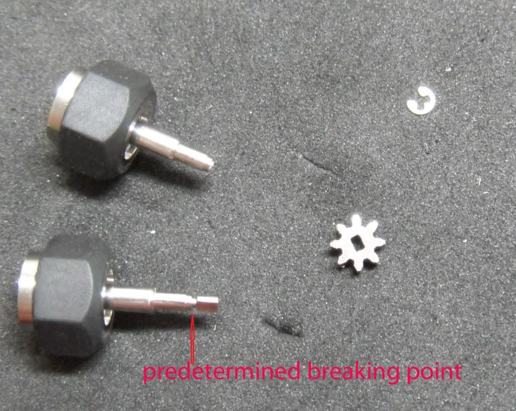

Do we have pictures of this weak part? And I don't get one thing: once the crown falls off, it can not be screwed back? I would really like to see any pictures of this weak mechanism/parts because I just bought one of these divers second-hand, and I am afraid I will have this surprise when I receive the watch. I would like to create a fix to this issue beforehand.

Who is saying that the crown cannot be screwed back in? The part which moves the bezel forward just brakes off, so you cannot move the bezel.
And here is a picture which Uwe took

In my case, the stem was broken. I'll post some pics when I arrrive at home.
fine dd
5/8/06
438
No, your stem was broken at the same place.
To make it more clear:
On the first picture you see the gear that transport the inner bezel on the first level.
The combination between steel from the stem, cast iron from the gear and plastic from the inner bezel is not the best solution.
You can turn the inner bezel only anti clockwise - if you want to turn it clockwise it looks with the ring on level two that you see in picture 2.
It needs only a little preasure to break the stem.
So please be carefull with using the inner bezel !

The "predetermined breaking point" is where the C clamp goes, right?
