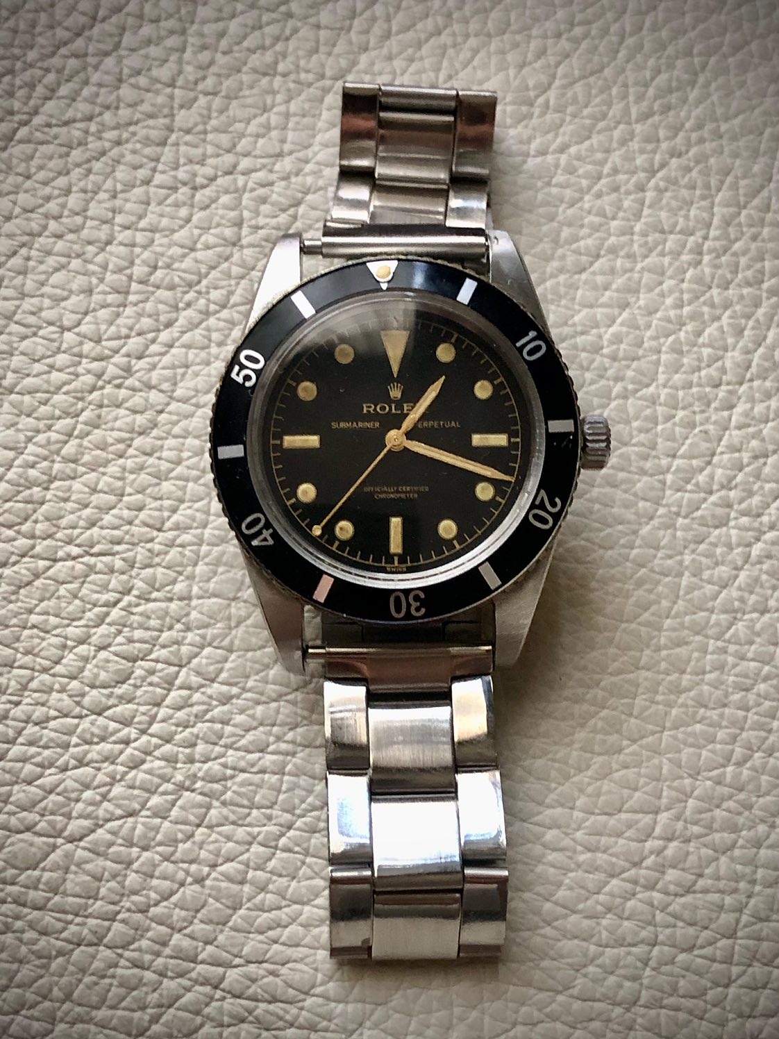

Some of you may remember last year about this time I started on a small crown 6536 build. The dial never materialized so recently I dug out the case as I had discovered a plan B

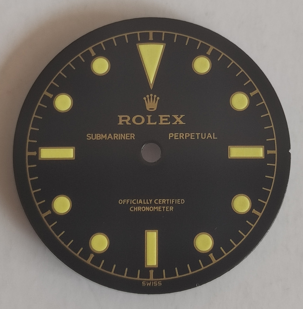

The new split logo 6204 sub dial - from Raffles was quietly released and I just happen to stumble upon accidently .
It arrived and the lume was that yellow tone.
I decided to bake the dial 260 F 15 mins face up on coffee.
It gave the dial a bit of a semi gloss finish and the lume dulle down to a tolerable ligjht yellow/almond tone. It now matches the lume tone on the pencil hands he offers.
This is the first draft. I plan on doing more aging on the dial and lume but I felt I wanted to stop and try it for a few days before I went further. kinda like when you are walking into a lake in the early days of summer you stop and take a break when the water gets to nuts level.
The gilt is brighter in person than the stock picture. The cornet and fonts look good, crisp and accurate . unbeatable value for $35.00
The take away is that if you dont like the bright lume colour...bake it for a bit. the colour fades.
Here is the current state of the 6204
I think a janky straight end link bracelet suits this early sub so well.
The third watch in my collection of firsts.
first gmt master 6542
first explorer 6350
first submariner 6204
Build specs:
alix x case set
raffles 6204 dial
raffles pencil hands.
TC no hash insert.
Eta 2824
alix bracelet 18mm
As always, thanks for looking and comments and questions welcome.

Thank you for the kind words and support everyone.. much appreciated .
Since I started using the weathering paints , they really have made aging dials and lume quite easy and authentic looking.
I just did a bit more aging to the sub this afternoon and I am more pleased with it now. it was too new looking when I first posted it this am.
its kinda tricky to capture on cam but in person it looks alot better. I plan on going back and softening the markers a bit but I was able to overcome that bright banana yellow lume with baking the dial and that softened the colour and then I dirtied it up with weathering paints.
here is a pic that gives you an idea of what Im talking about.
touched up the lume with a few different dustings of colours. brown , tan, ochre, and a light weathering of the surface with snow and mud... but its quite subtle , but it starting to look more age appropriate for a 70+ year old watch

I have a TC insert with red triangle that I banked and came out tropical I will swap that one onto the bezel down the road. currently I like the matte finish with minor marking look of this insert. it could use more character tho.
I will probably lume the pip hole and it will look better.

Beautiful! That dial is interesting- SUBMARINER PERPETUAL no oyster there! I googled Rolex 6204 Submariner and most of the dials are the typical ROLEX, Oyster Perpetual with Submariner at the bottom. So Raffles picked a rare dial to copy!
I love the Brevet crown, no hash insert and the pencil hands! Dial aging is excellent also!
Thank you
Yes There were a few configurations of the text layout in the early years. The split logo as its called had always interested me as it was different.
Bobs watches had a nice example a few years ago.
noticed the no hash insert without pip ?>!
