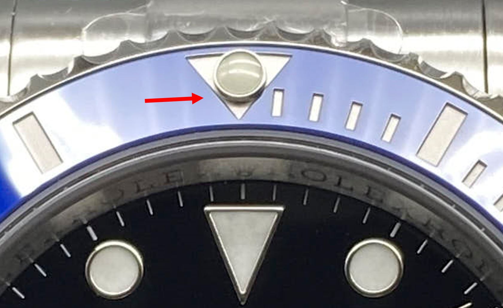

Hi folks,
I'm a manic of symmetry... (I know my desease) ...I have spotted plenty of times SUB (both Gens and Reps) with the Pearl Pib slightly off set from the triangle.
See below example.
Please can you comment on that?
How common is it, this "tiny" imperfection?
thanks

That one doesn't look bad at all. It's maybe 0.0000001" to the right. You will NEVER see that irl.

Light plays a big role in what you think you see. In your example the light is coming from the left so there is shadow in the space between the pip and the triangle edge on the right. It could easily look centered if it was shown with a dead center light source.
For ones that actually  are off center, it's best to either live with it and get over it or just replace the insert. It's far too much risk and expense to try to correct it. I have reattached pips to ceramic inserts when it was needed but to pull one off and move it a slight amount is a crazy notion.
Sometimes there is no room to move it in the direction needed because of the pearl cup shaft butting up against the hole in the ceramic. I've grinded that shaft off once to do a pip replacement on an insert in place but wouldn't go to those lengths for a tiny visual improvement.

All pearls look this way with that kind of lighting from the side. Left side is lit while right side is in the shadow so it looks like it's not centered but it is

If you look at a picture which is blown up so much that the pearl is the size of the dial, you're going to see things wrong with it.
