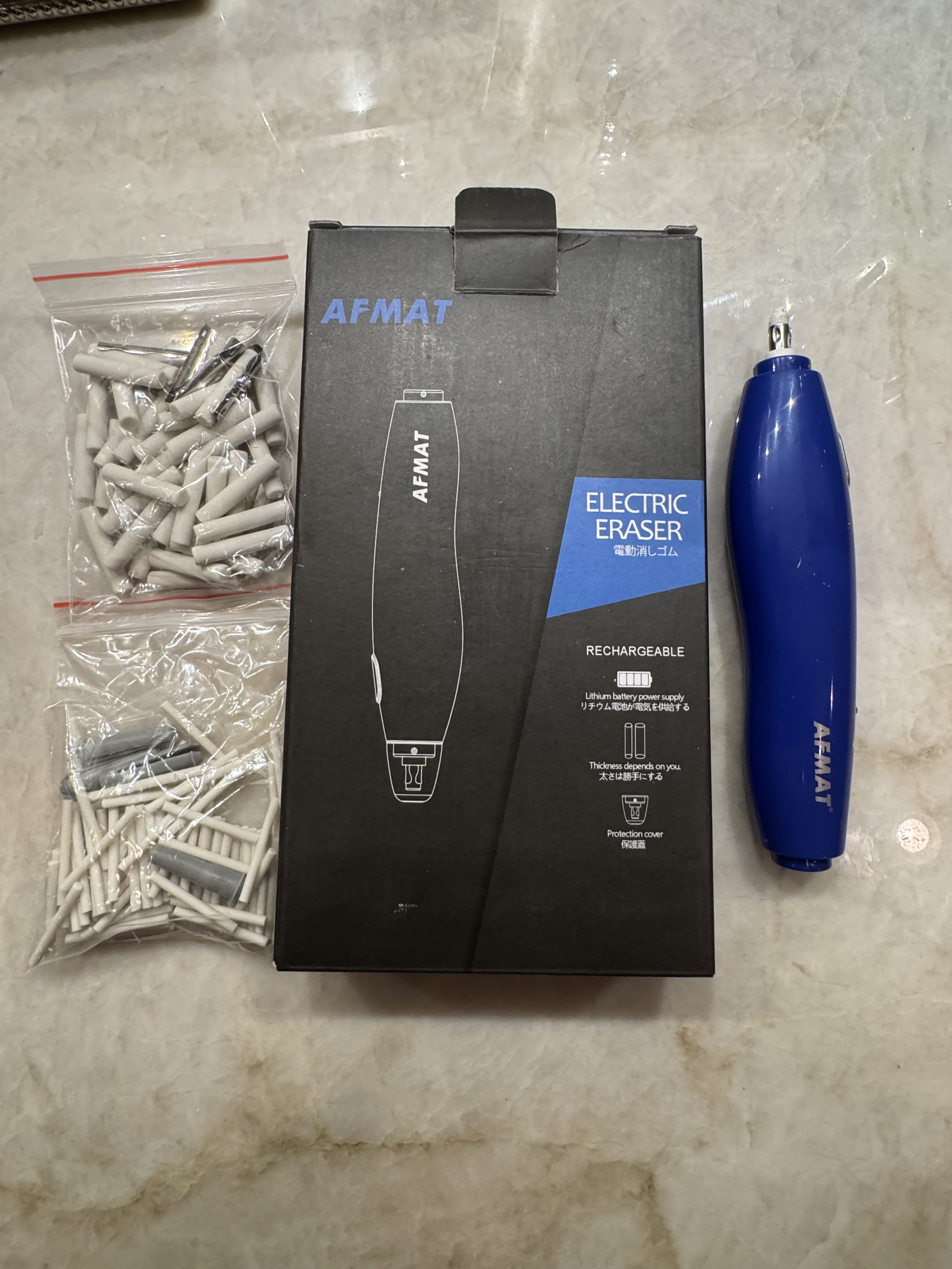

I looked on Amazon and for about $10 I bought an electric eraser and it comes with a ton of eraser tips. There's a larger one that's the standard size that you would see on a erasable pen, and then a very thin one that's a little stiffer and can be used for fine work.

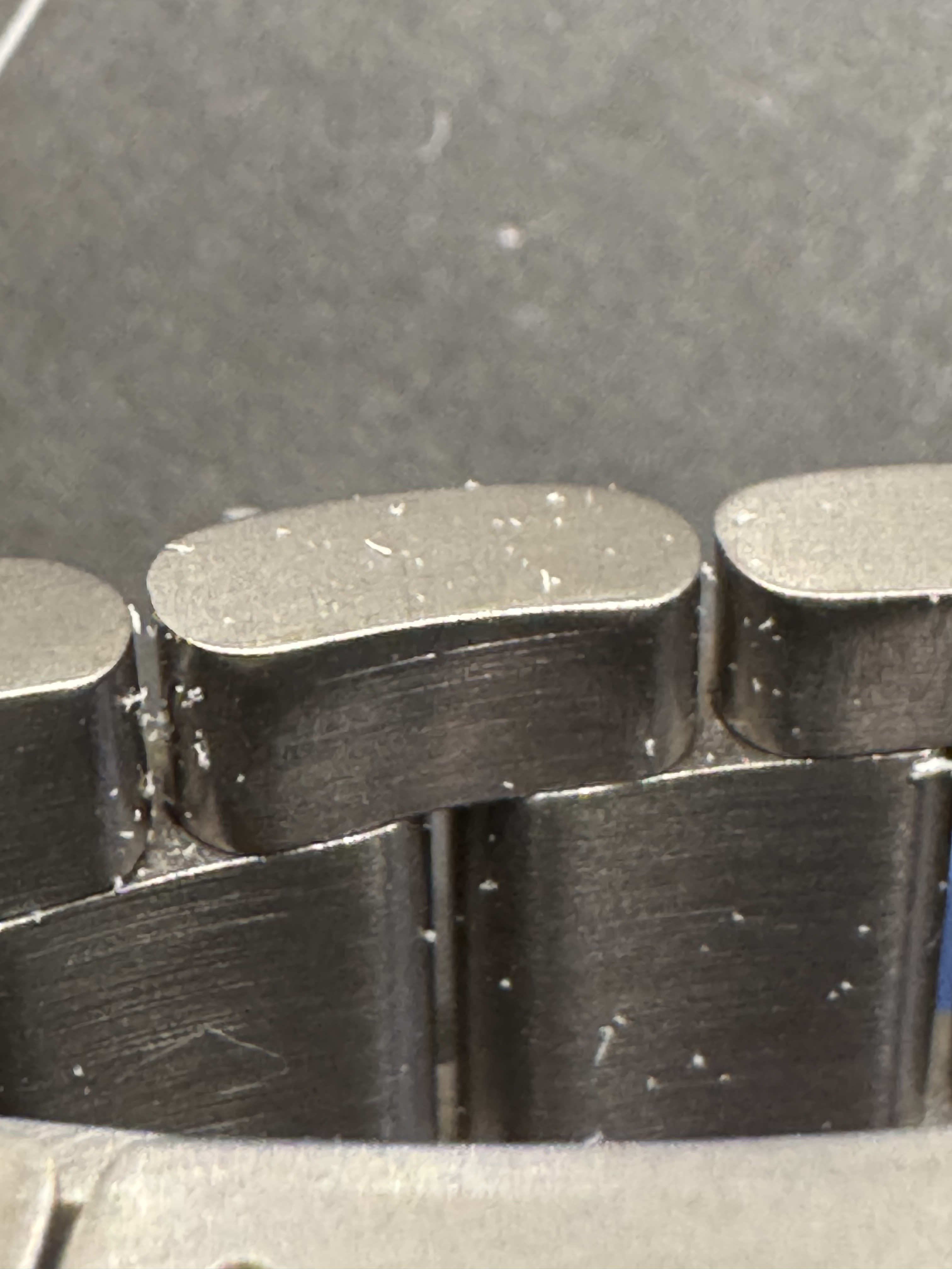

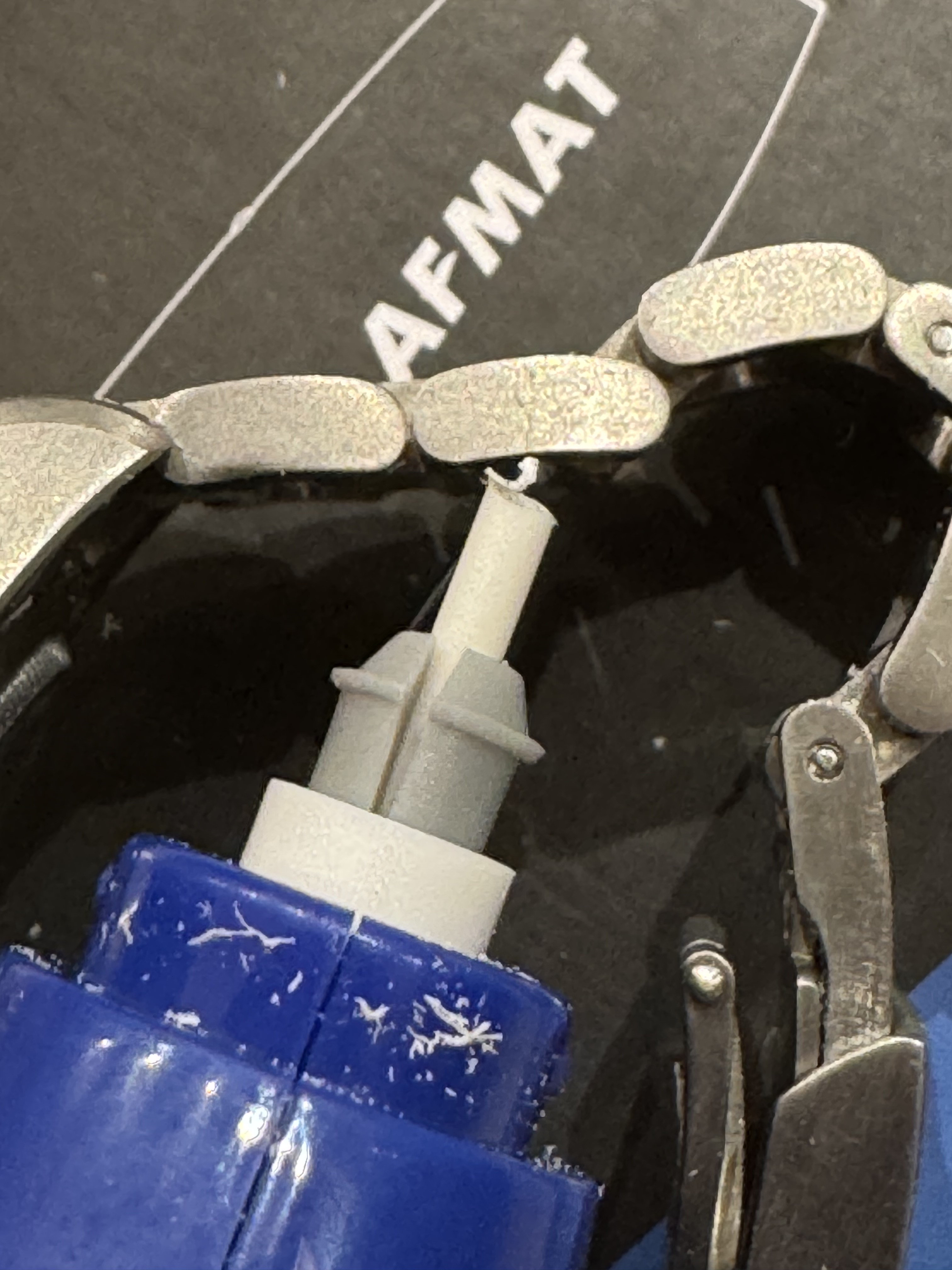

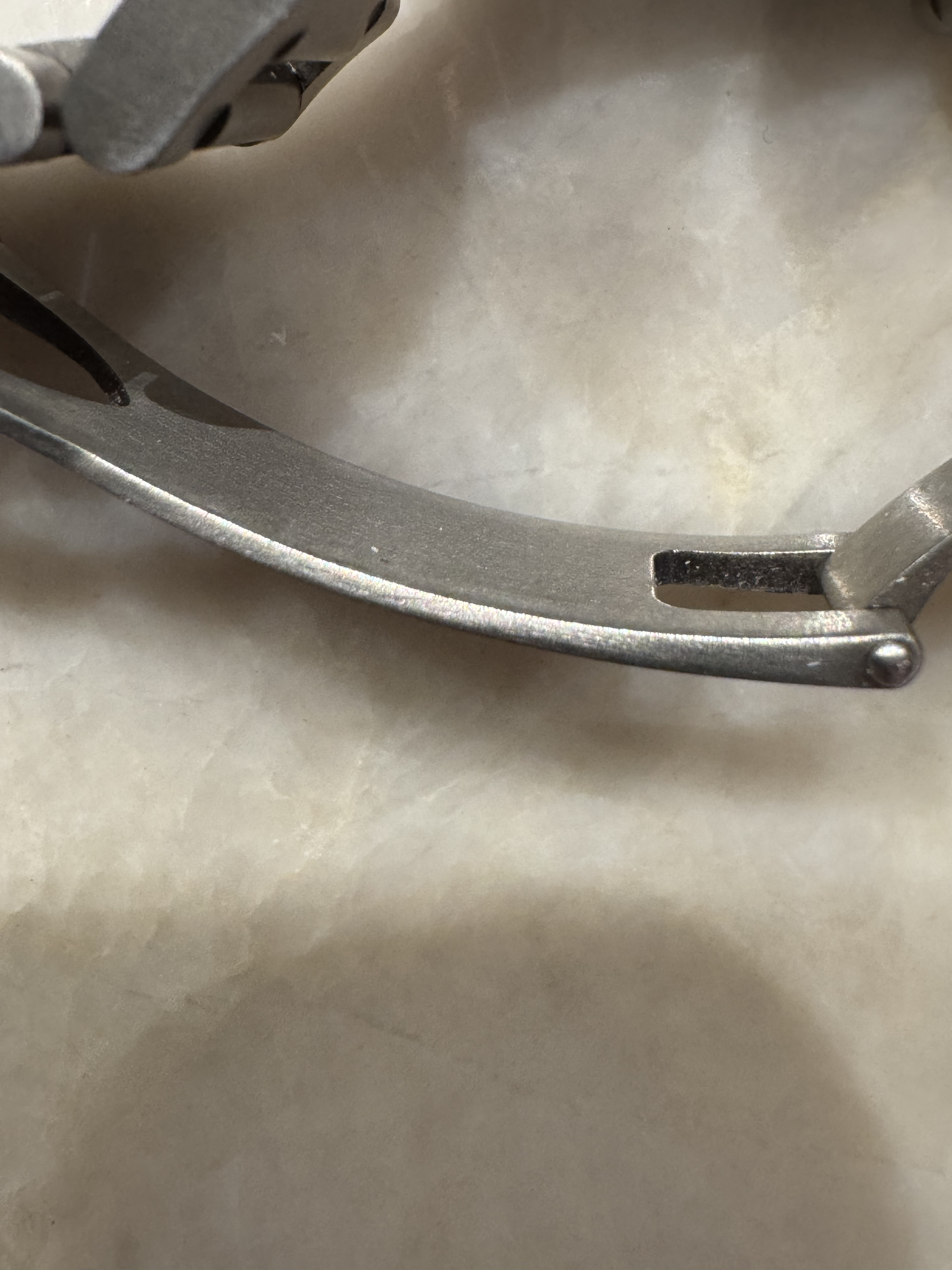

In about 10 minutes I had my entire Pelagos 39 bracelet, clasp edges, and Case edges super soft.
This is with titanium. I'm sure it would work with steel as well, but would probably leave a highly polished finish.

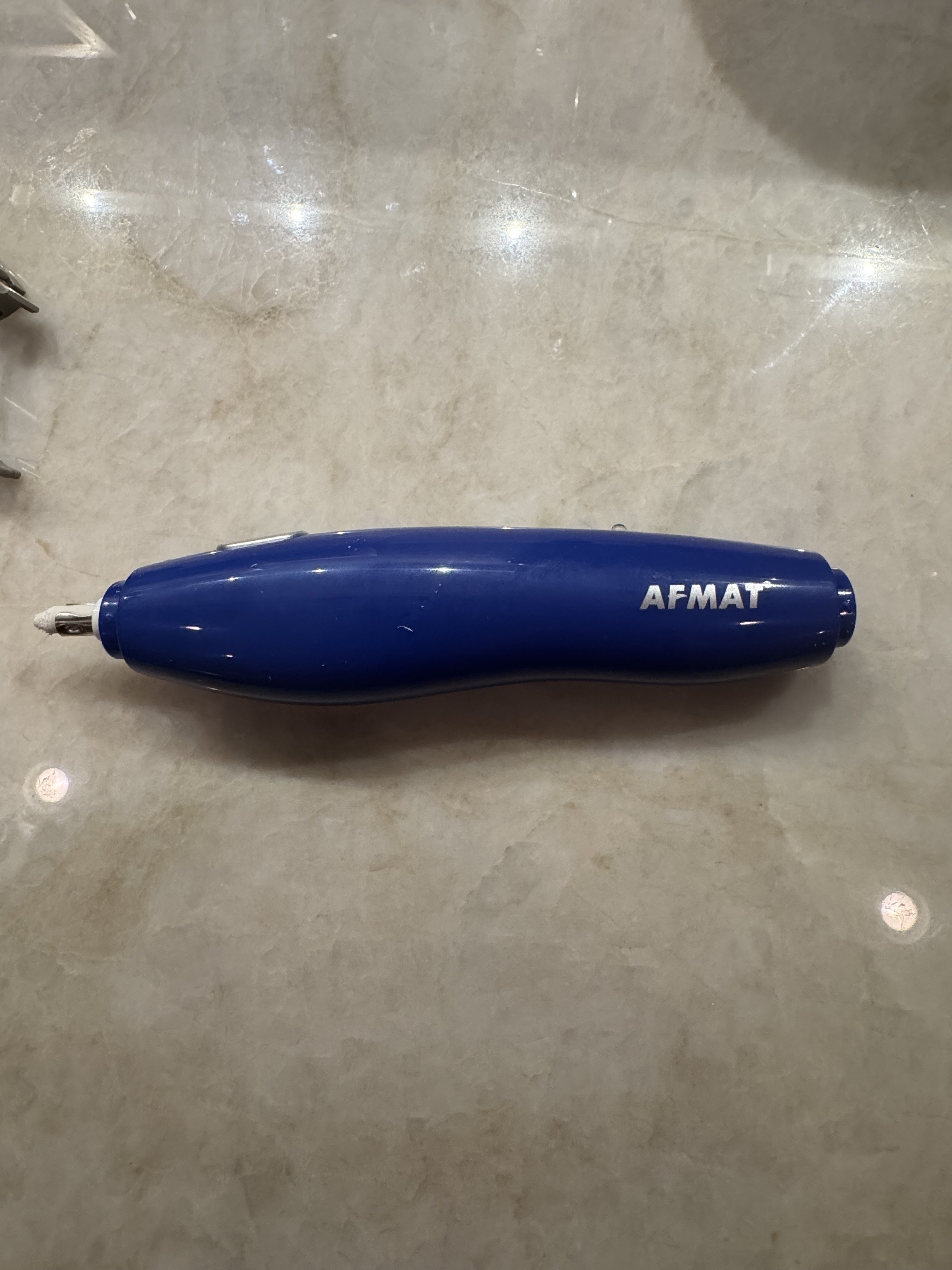

Here is a picture of the electric eraser. It spins at a high speed and makes easy work of the metal without being overly aggressive like a dremel.
