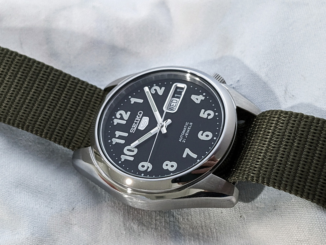

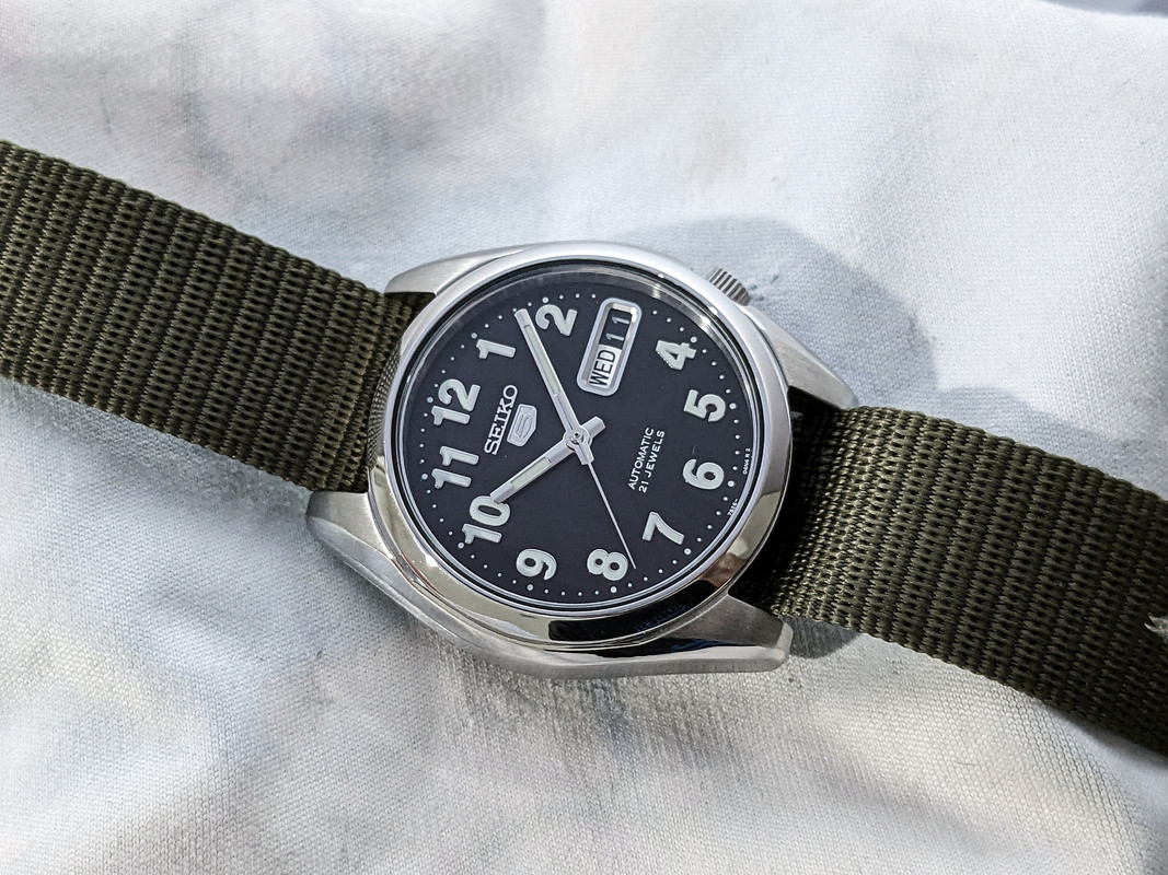

I gave up thinking to pay the todays prices and made my own:. All are Seiko parts.
Cheers.

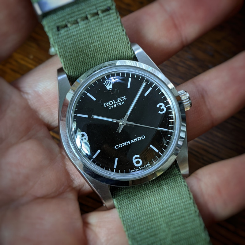

Do you print the dial and Lume it as in... Decals ? I have done quite a few dials myself.... Not "Seiko" , but this. I did this for a very close friend who wanted a Commando:
But I never lume it. That's why I ask if you did decals or are you doing actual plate pad printing.
