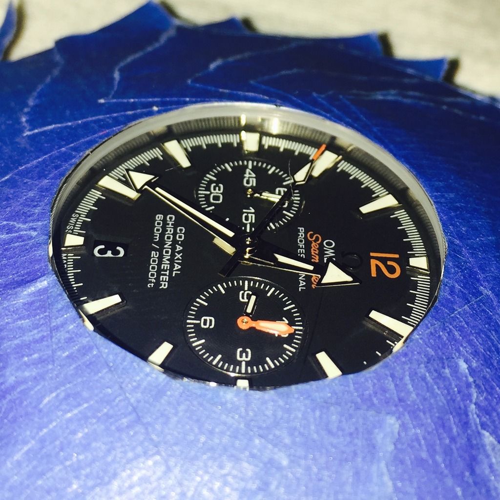

So, I'm new here and just discovered this forum right after making my first rep purchase from a non RWI dealer. I just received my watch yesterday and it was perfect! After admiring it for a bit, I put it back on its little pillow and back in the box so I could bring it with me to work and have some links removed on my lunch break. When I opened the box at the jeweler, I noticed the watch had shifted and the crystal was rubbing against the cardboard. When I took it out of the box I noticed a scratch on the crystal. Needless to say, I was mortified! I was hoping it was just a smudge, but after cleaning it, it was clearly a scratch :/ The website I ordered from claimed it was a sapphire crystal and from previous experience with genuine luxury watches, I know they just don't scratch that easily. Ive started a claim process with the dealer and he assures me they will take care of the problem, but I'm afraid he will just offer a discount on a future purchase or a refund with me fitting the bill for return shipping back to China. How common are crystal scratches on reps? Am I being too picky? The watch looks great but is it just going to continue to scratch?!?!? Here are some pics for you guys to look at. Is it worth the hassle to return? I'm in the process of ordering 2 watches from an RWI TD and I'm hoping to have better luck! Thanks, in advance, for giving a noob some advice.

Pictures are really low quallity, please repost them in HQ :)

The blue tinge on some of your photos suggests the crystal is AR coated, if this is so, then it is almost certainly Sapphire. It is possible the the scratch is in the AR not the crystal. Not an expert, just a suggestion.

Photos are bad - can't really see anything, but cardboard is not going to be able scratch either saphire or mineral crystal .As already stated looks like it could be AR rubbed off. Solution - Take it all off with a Cape cod cloth.

If it is just a scratch in the AR, I've heard of people polishing the AR off with a cape cod cloth to fix it.
If it's actually glass, it seems like there should be some kind of fill + buff routine like they do for car windshields, but I got no idea.

The genuine Omega Planet Ocean sapphire crystal had AR on both the inside and outside. In fact most of the Omega have double AR...
So the maker is correct by doing both AR too but the quality might not be as durable...
You definitely can remove it using Autosol metal polish. Mask the bezel with masking tape and polish it off.
Don't worry it will not scratch the crystal , I polish my genuine Rolex crystals (No AR outside) at times.

Thanks for all the advice everyone! I ordered some cape cod cloths and buffed the heck outta the crystal for about 20 mins with no visible results :/ Am I doing something wrong? Here are some hopefully better pics...scratches are obvious. Should I just chalk this up to beginner's bad luck, or is there something more I can do to get rid of the scratches? The dealer I purchased from offered to send me a brand new crystal free of charge, but I'll have to pay to have it installed and I'm afraid it will just scratch again...

Yes,those are scratches on the crystal. Take up the TD on his offer - you can install the crystal yourself, it's not that difficult - plenty of tutorials around to help you....
Also, if that scratch happened when the watch was in it's box then no way is that saphire - it's mineral.

And if it's mineral, you can easily buff it out with polywatch or diamond paste. Cape cod will take off AR but likely not buff scratches off a mineral Crystal. Get some polywatch and buff that thing and it will probably look brand new.

I'm amazed the crystal got scratched while in a cardboard box... I'd never even imagine that happening, but that's definitely not saphire.
