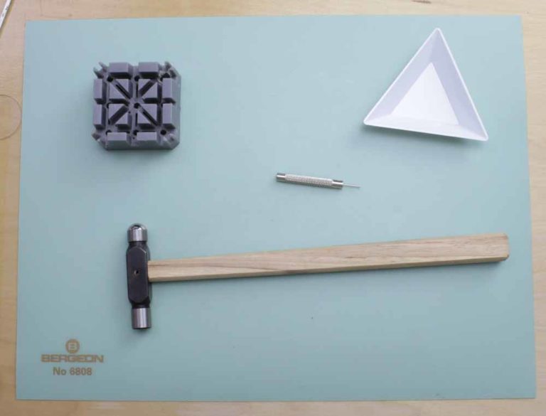

From my experience cotton pin pusher will not do the job. The pin will stay half way in, you have to push them completely out of the 2 inter links.
This will do the job :
White_Rose
24/2/22
102
31
Make sure the bracelet is well maintained and your tool staight before you use the little hammer, don't be afraid to use it though.
