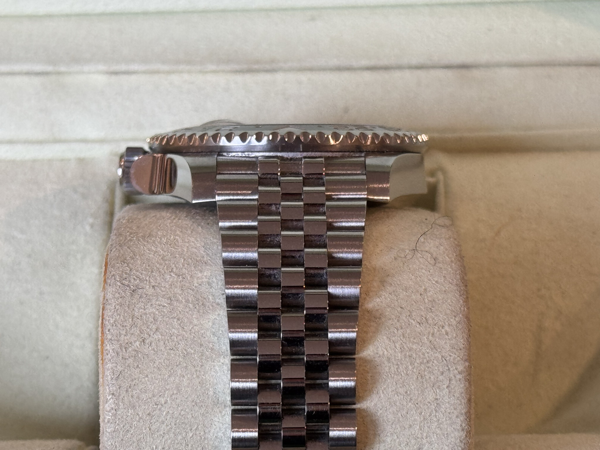

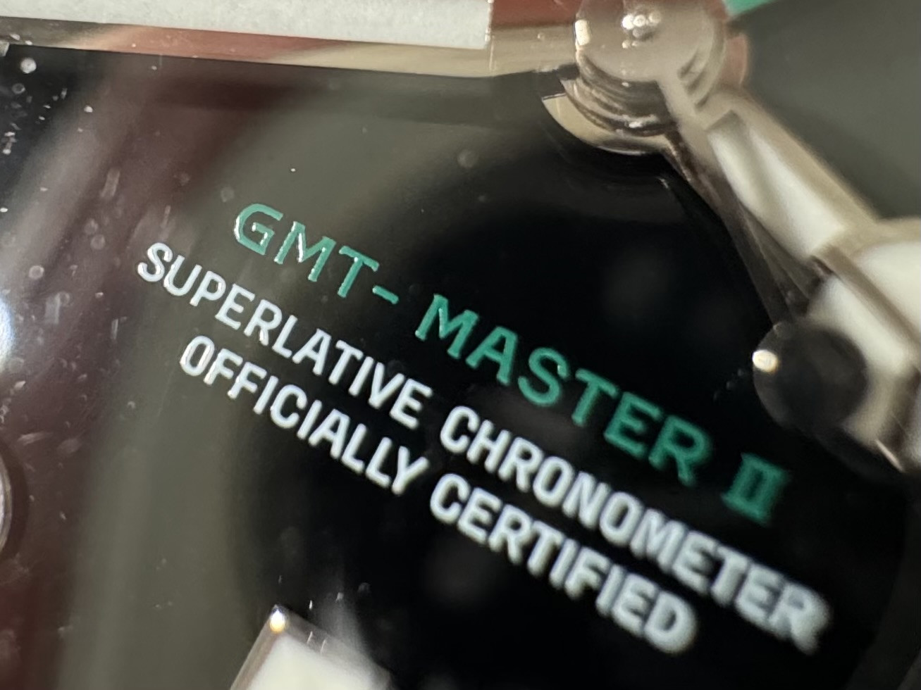

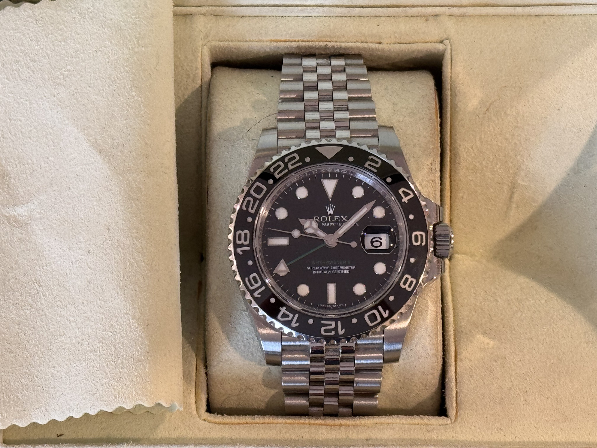

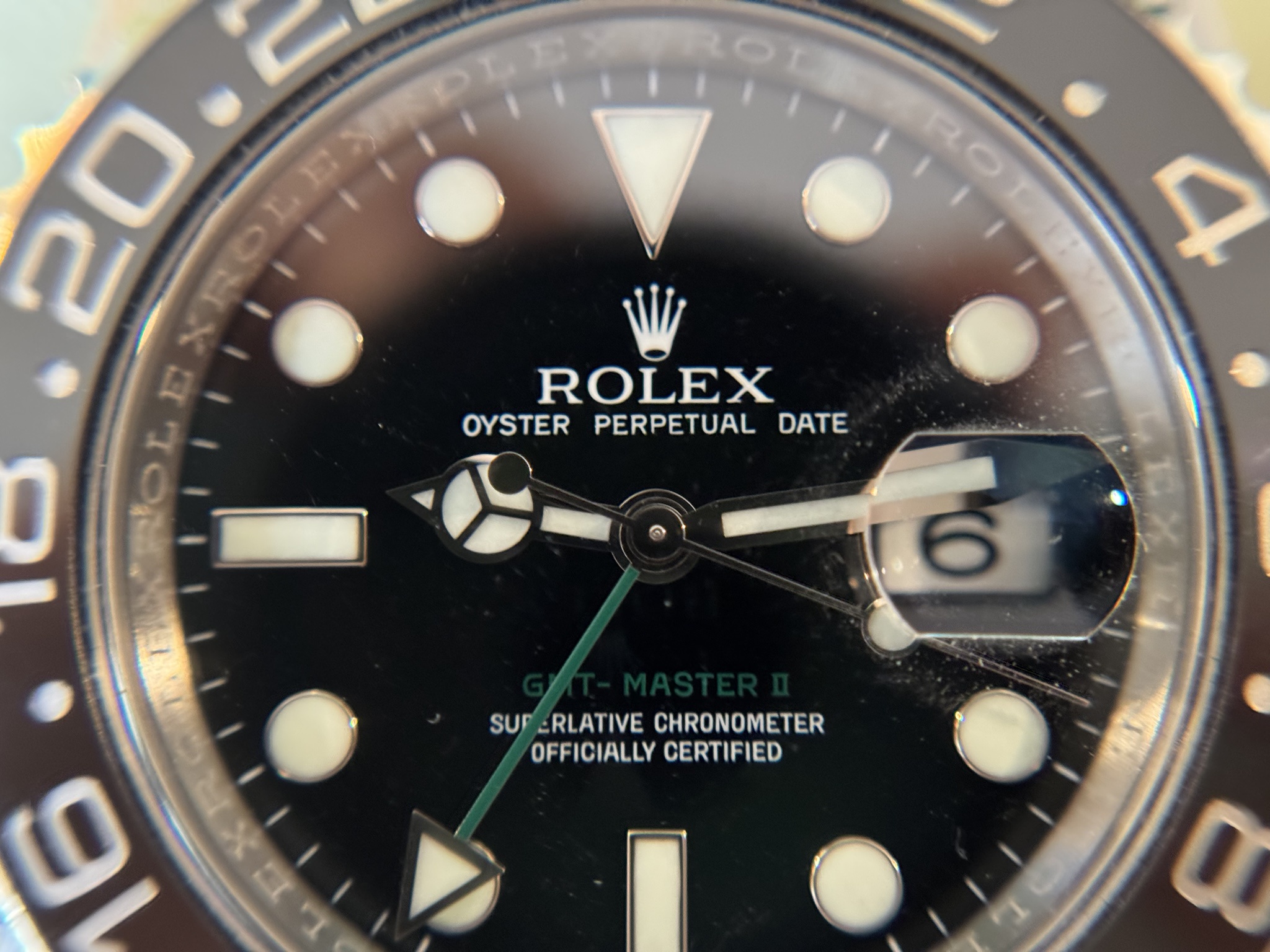

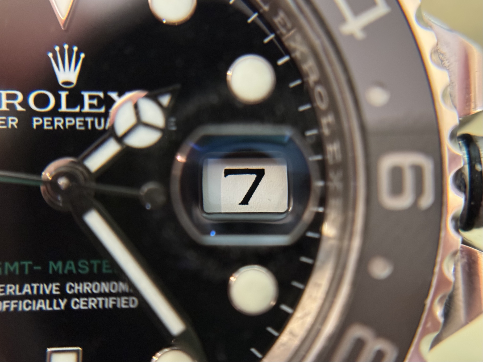

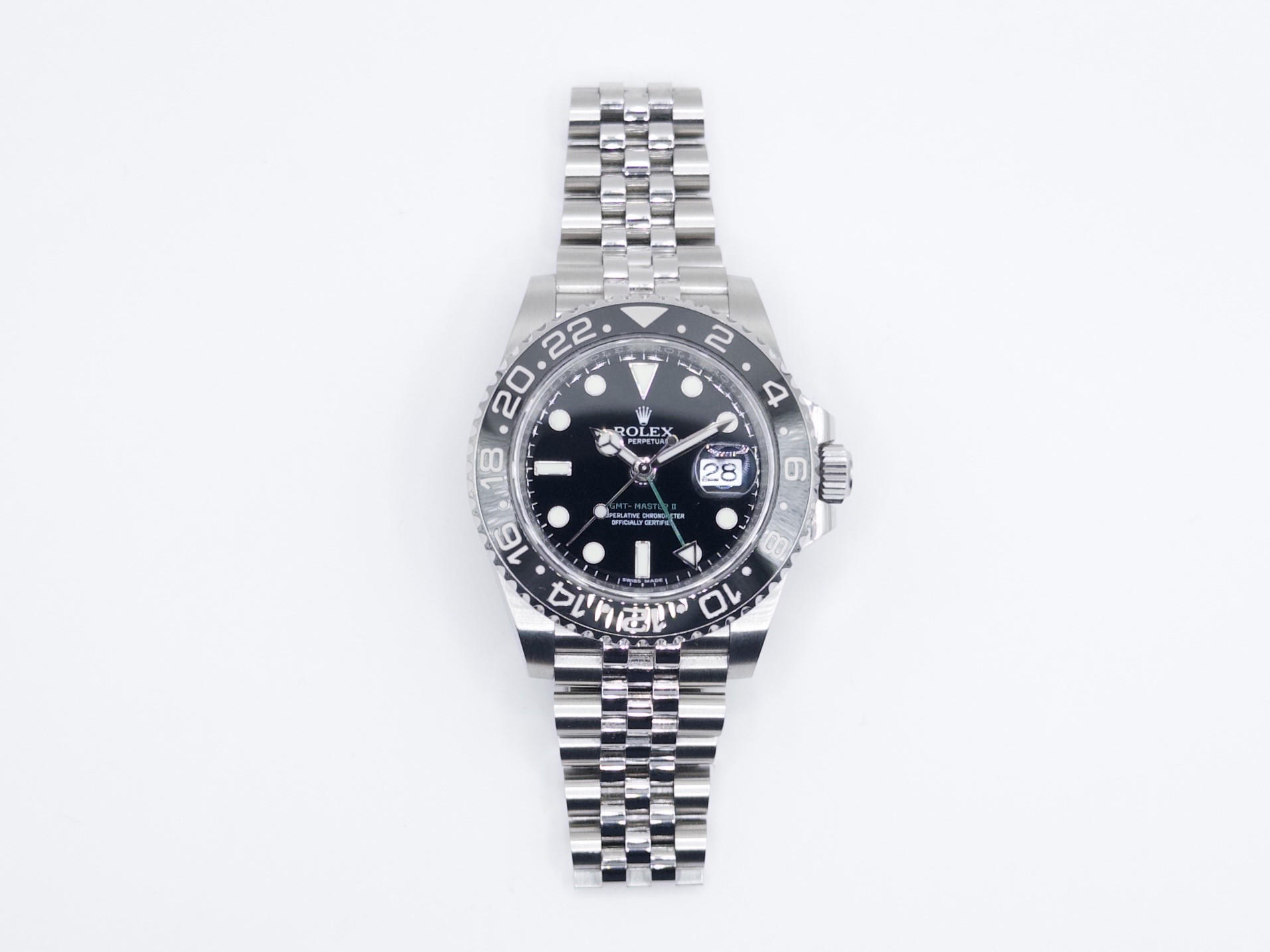

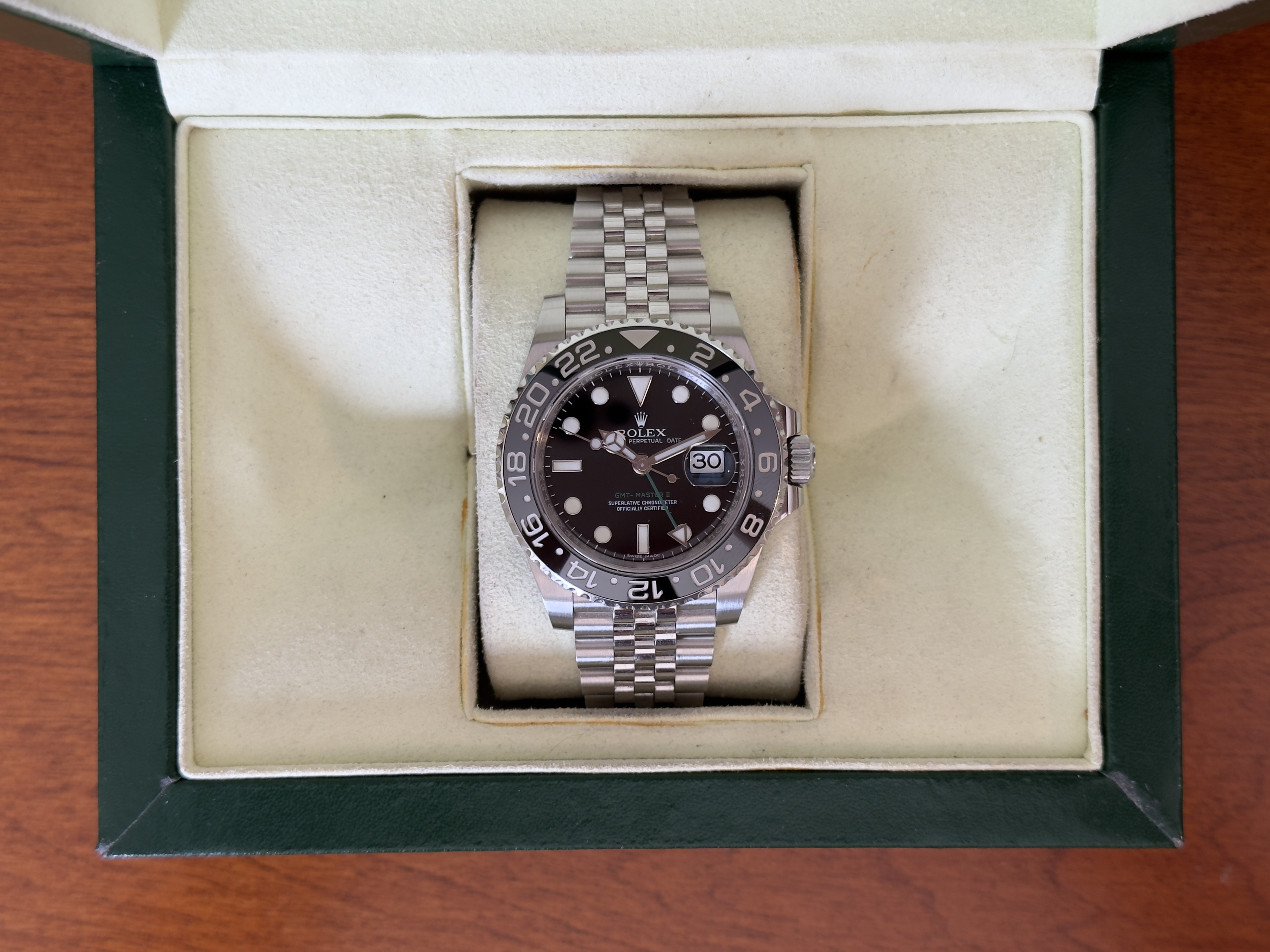

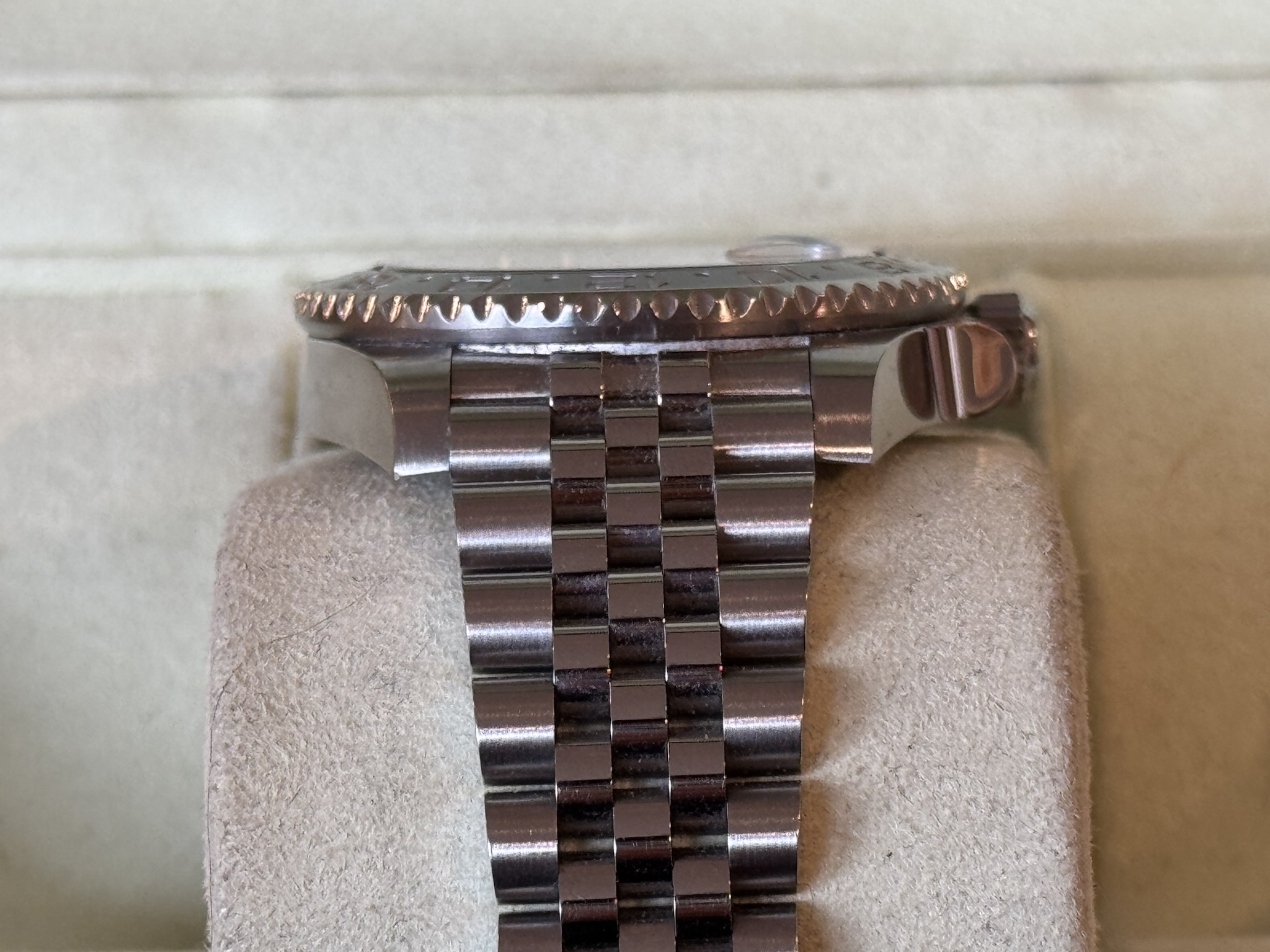

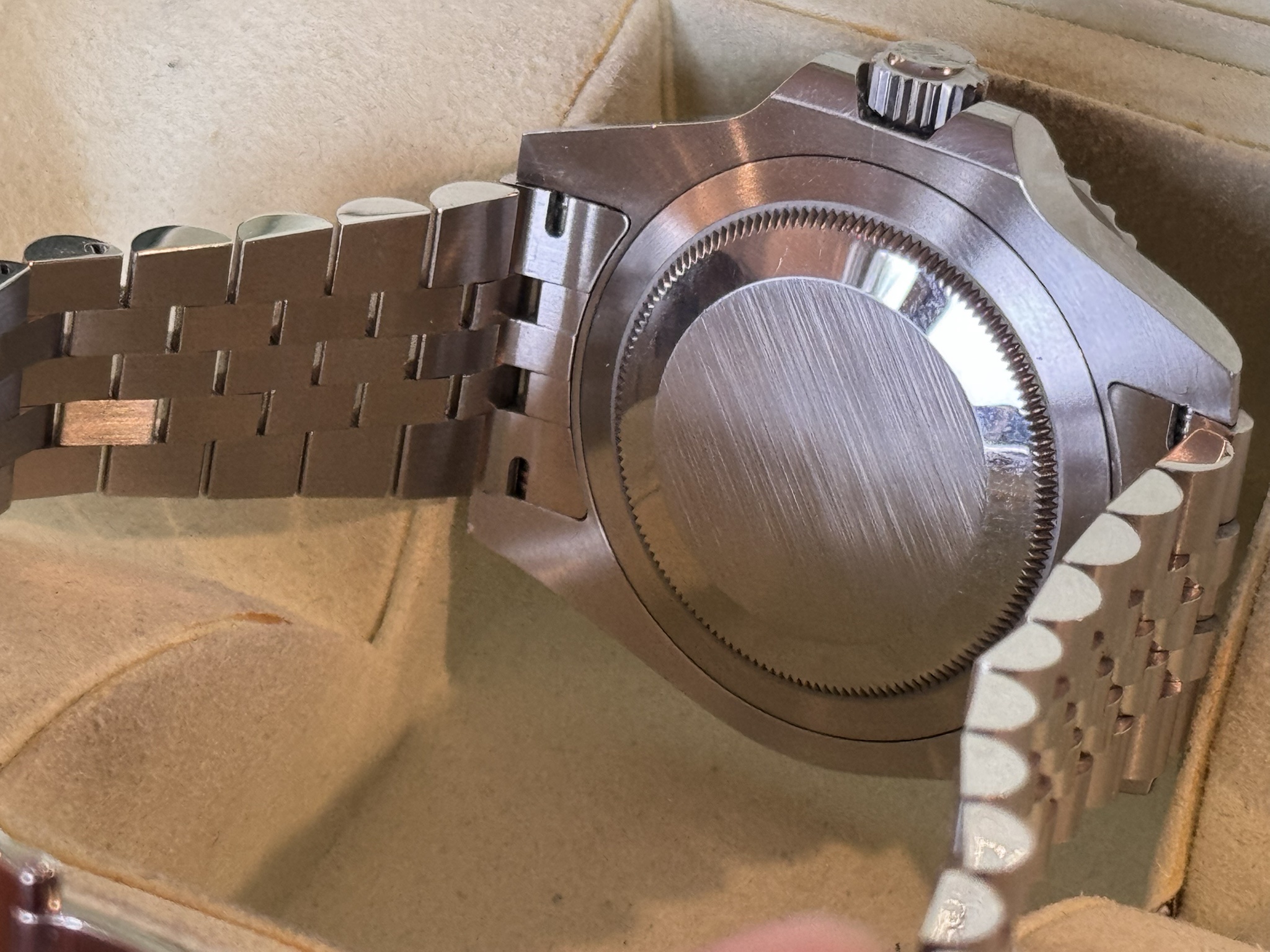

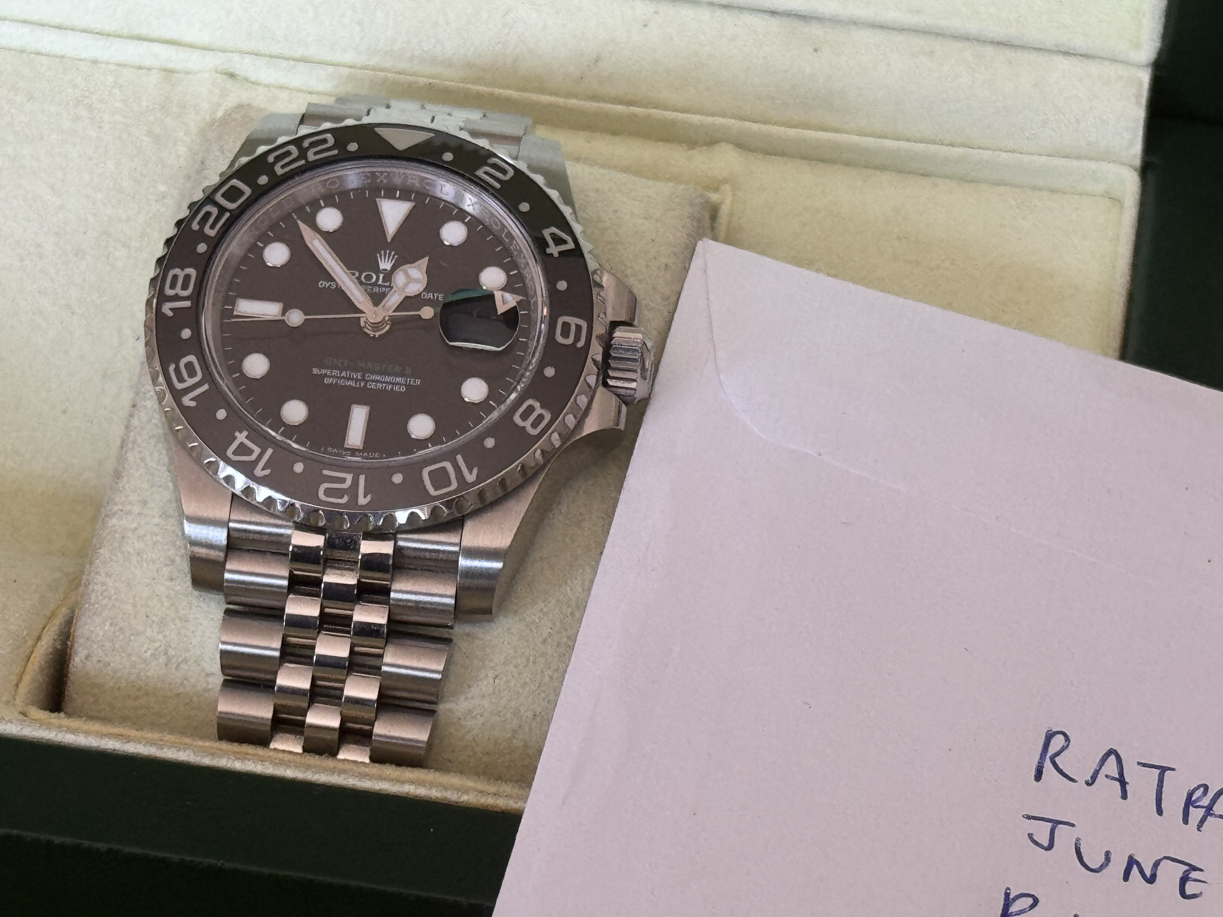

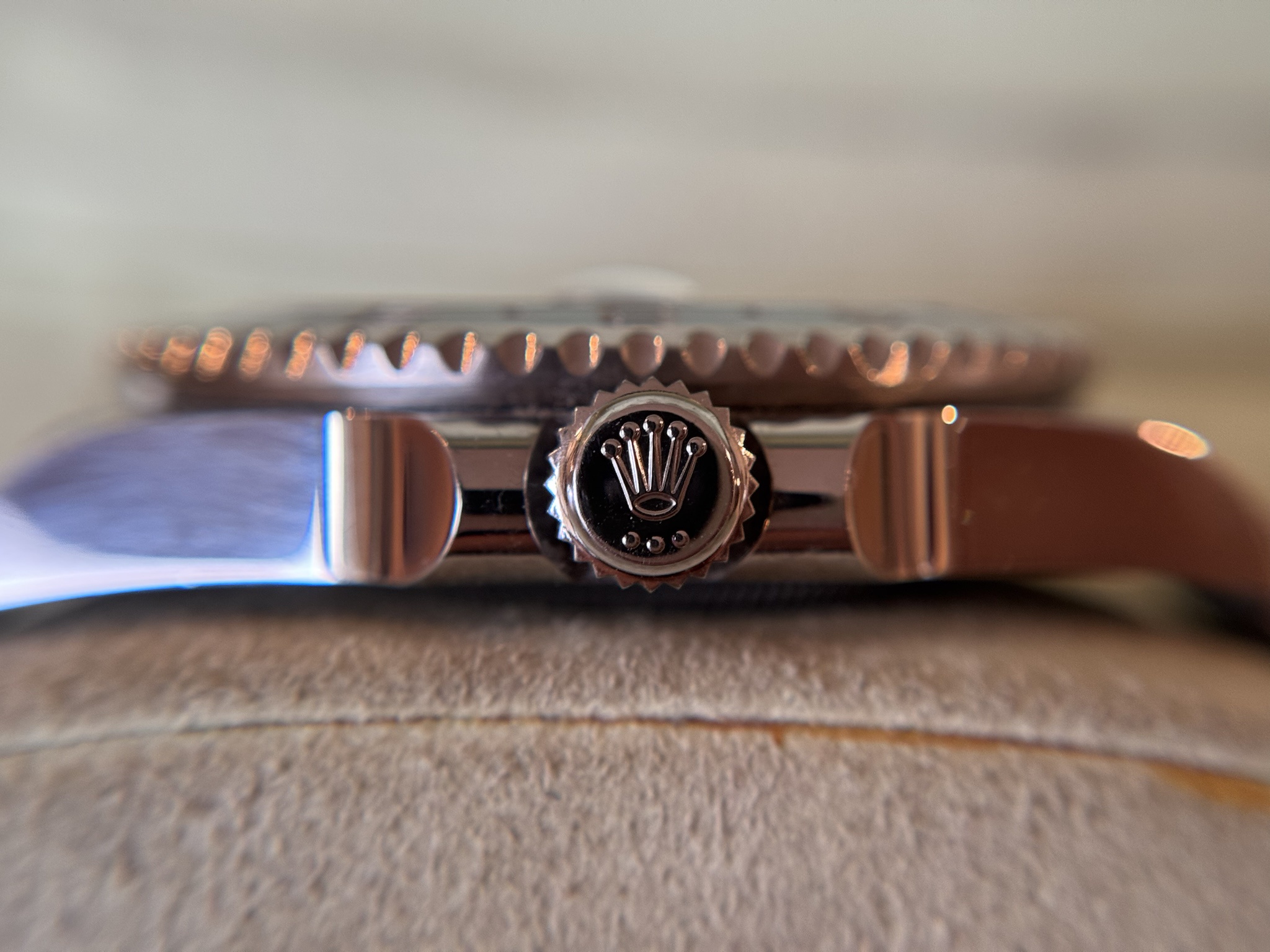

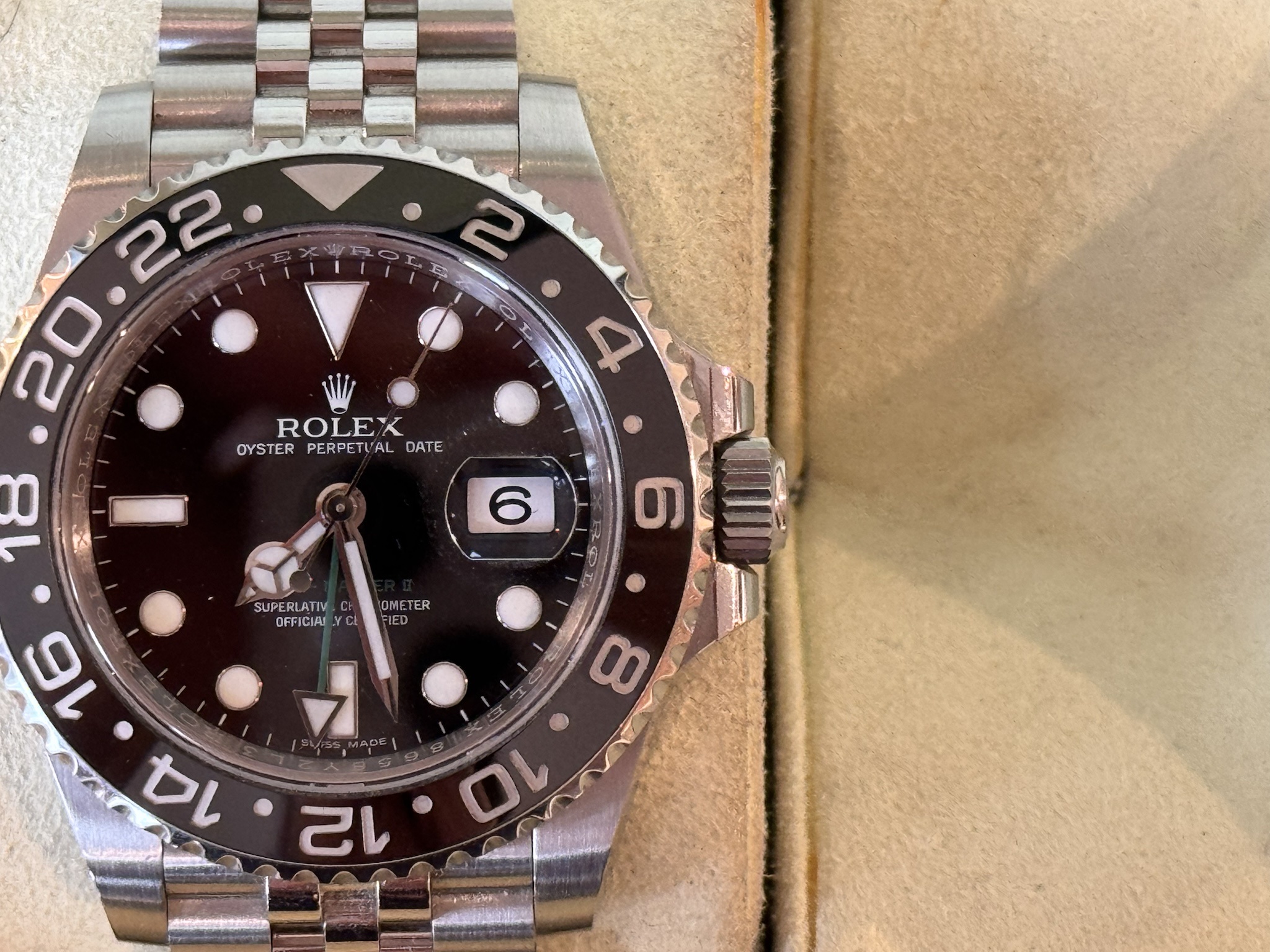

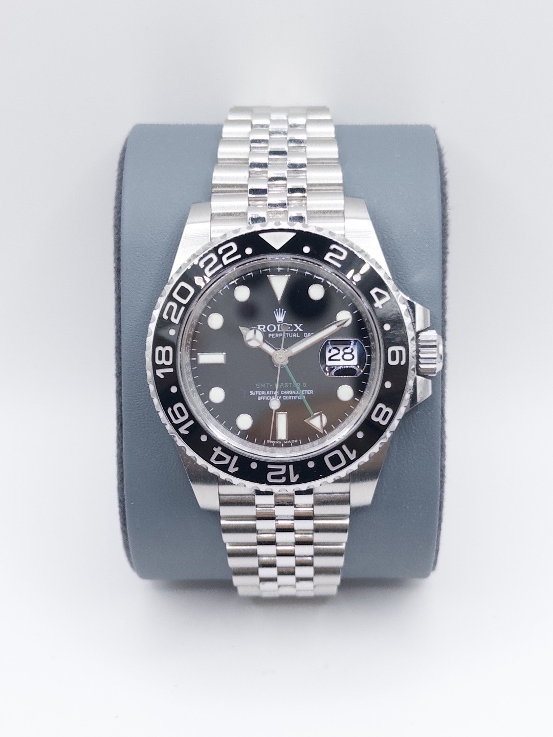

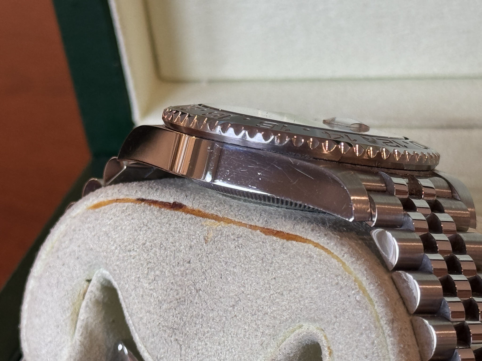

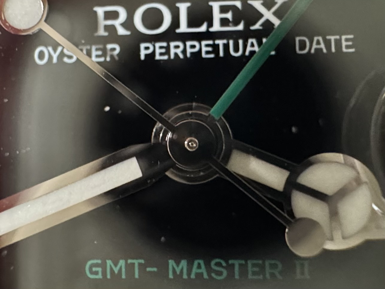

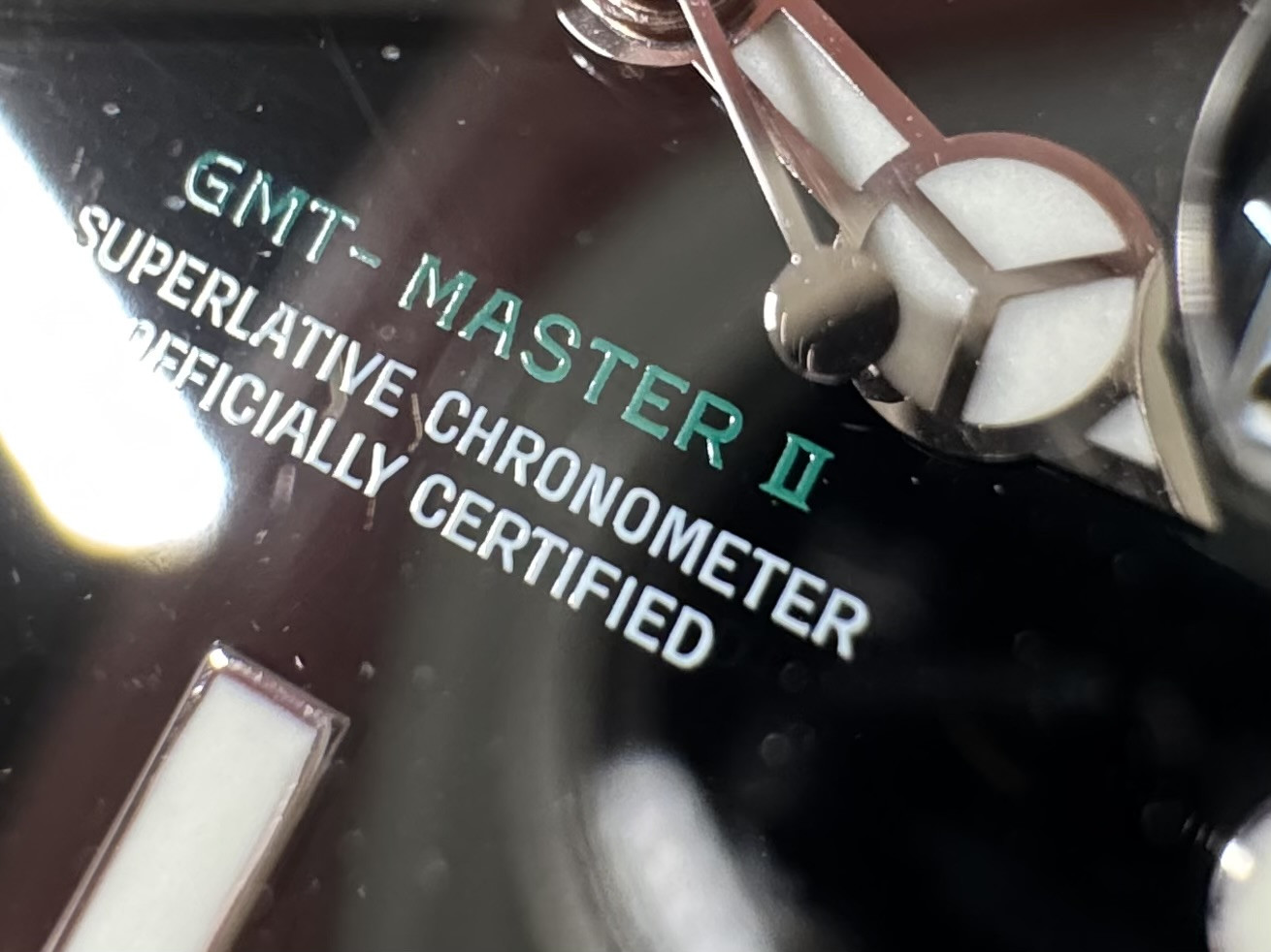

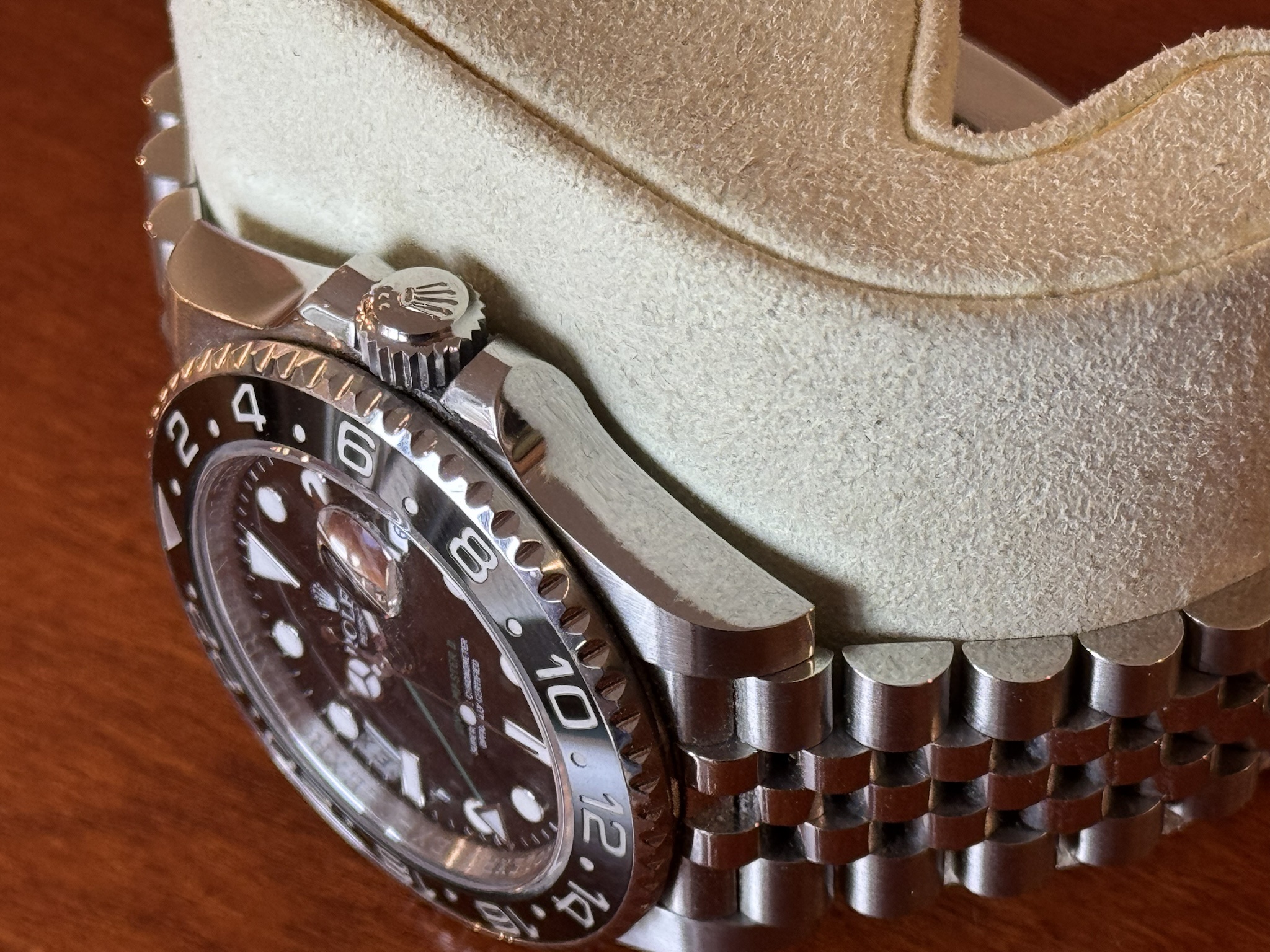

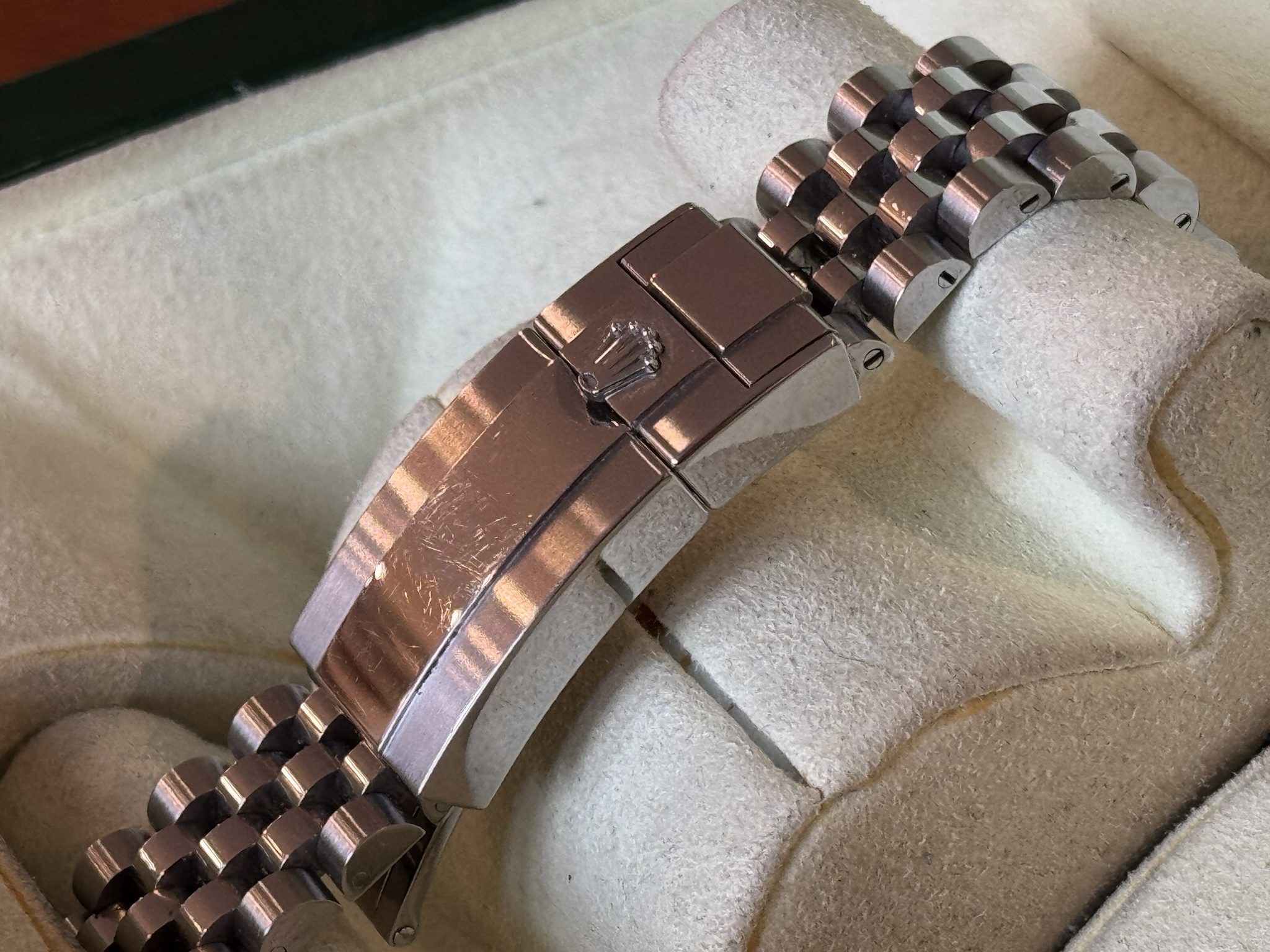

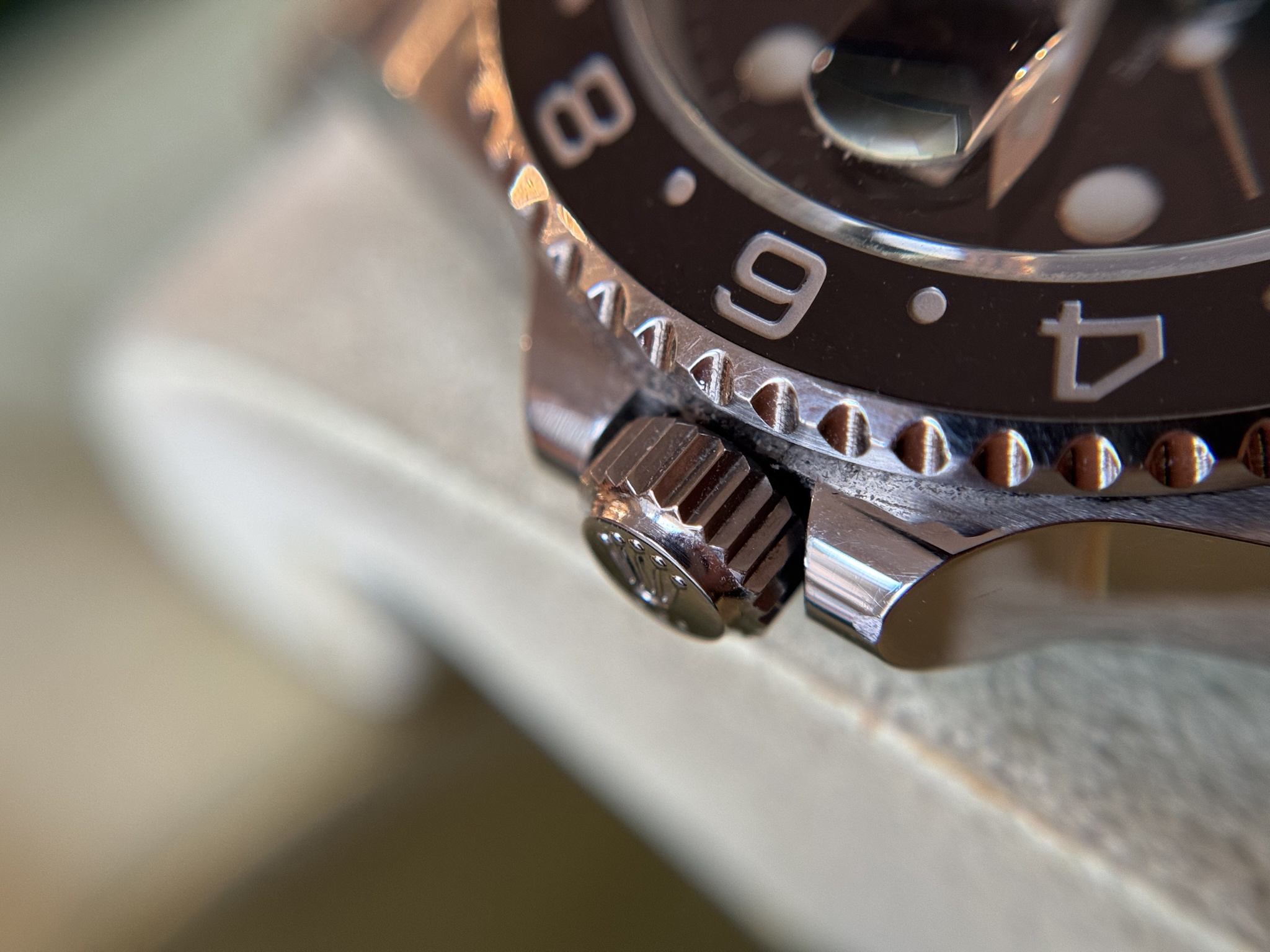

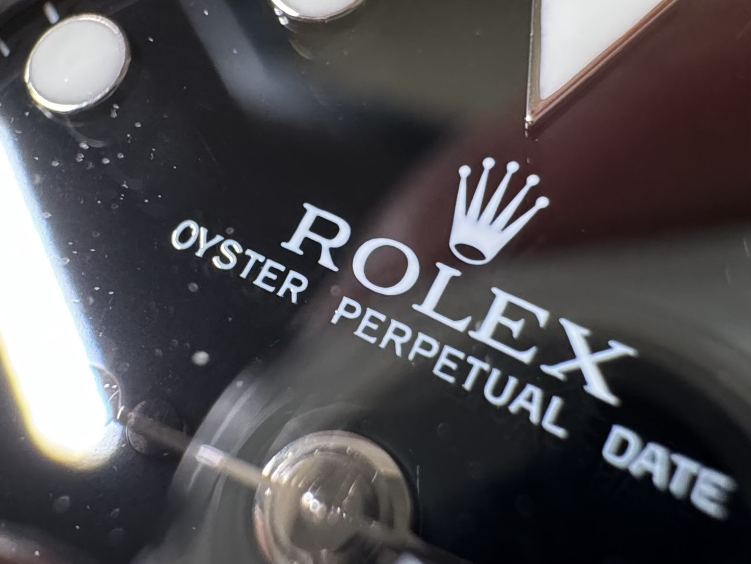

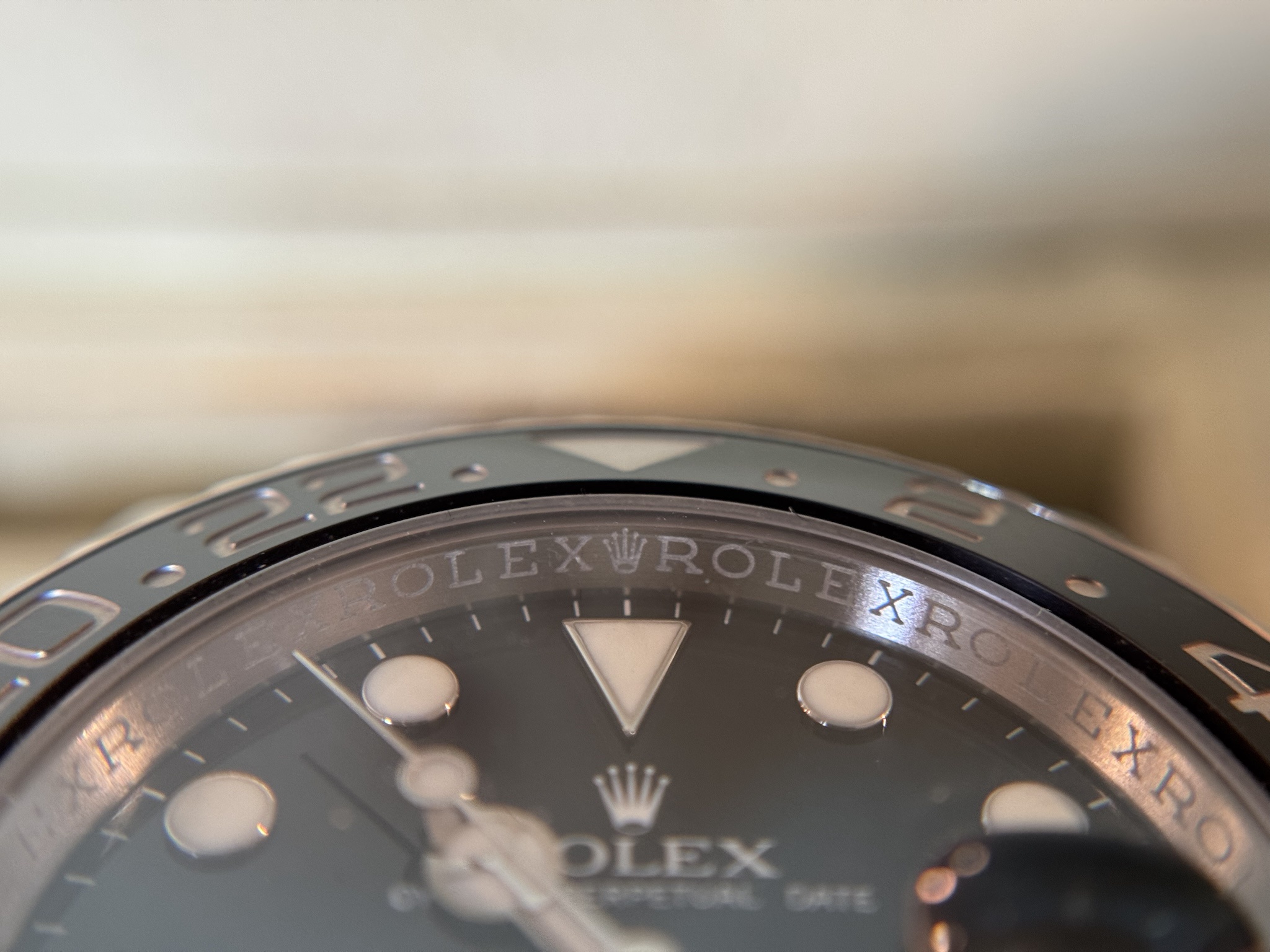

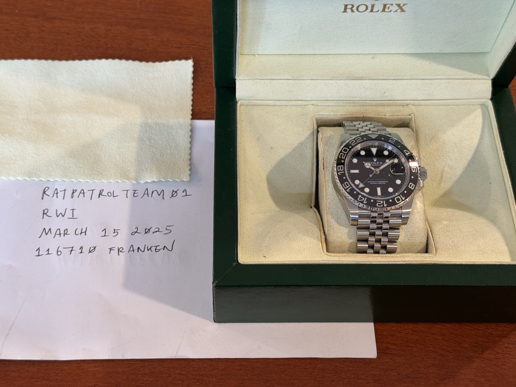

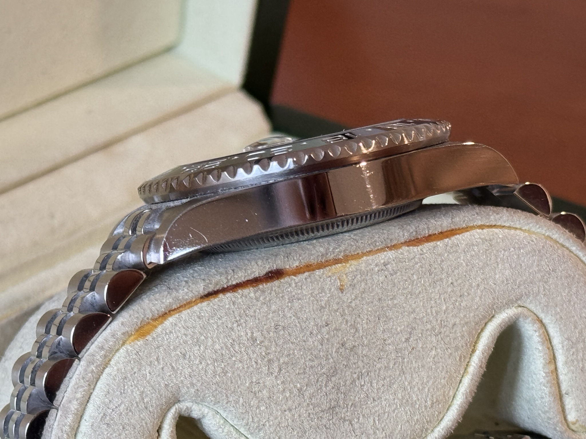

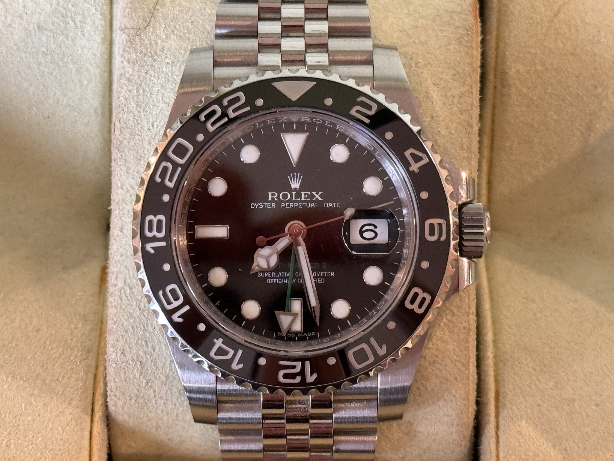

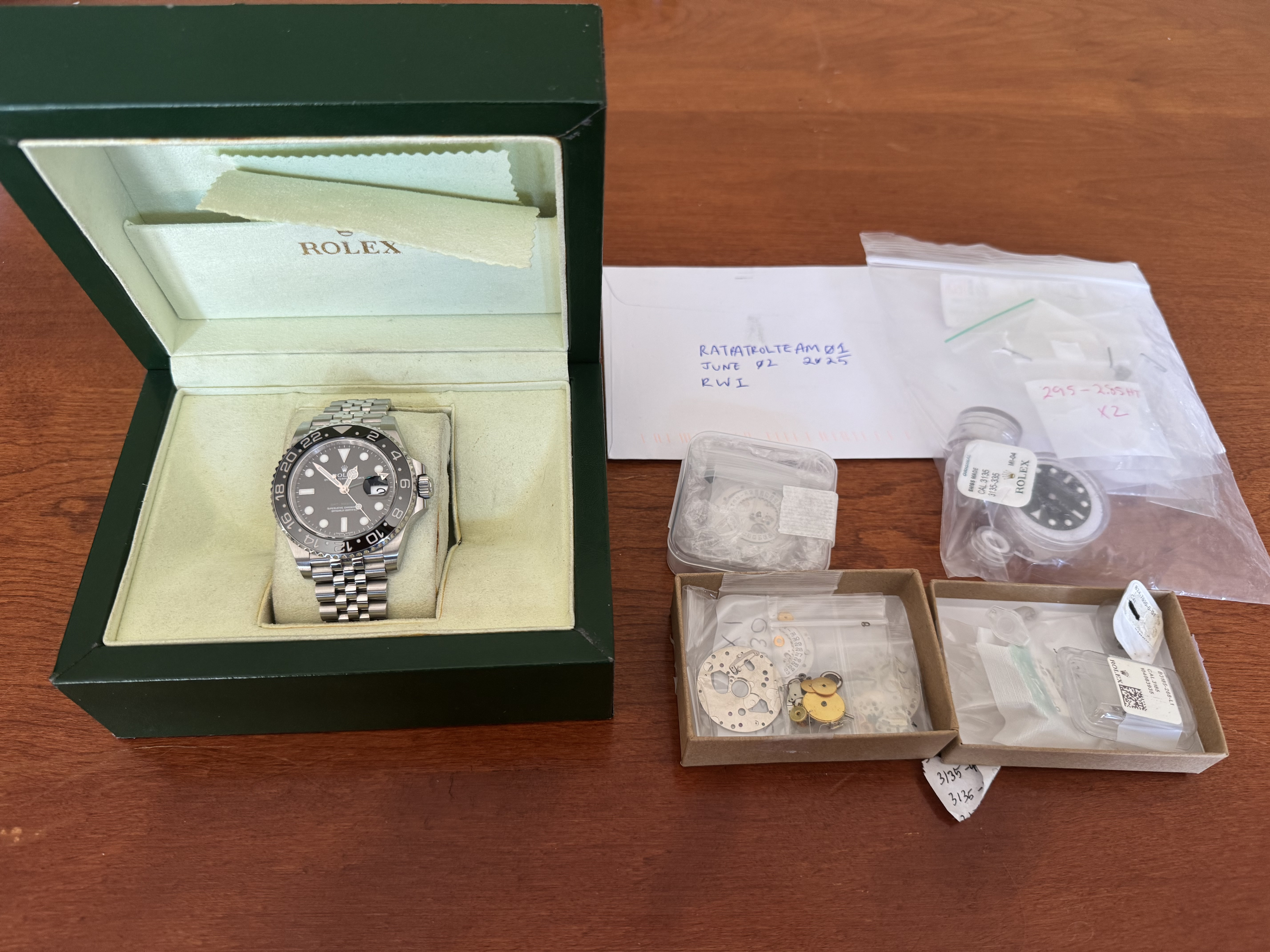

Here’s the ultimate 116710LN franken for you all.

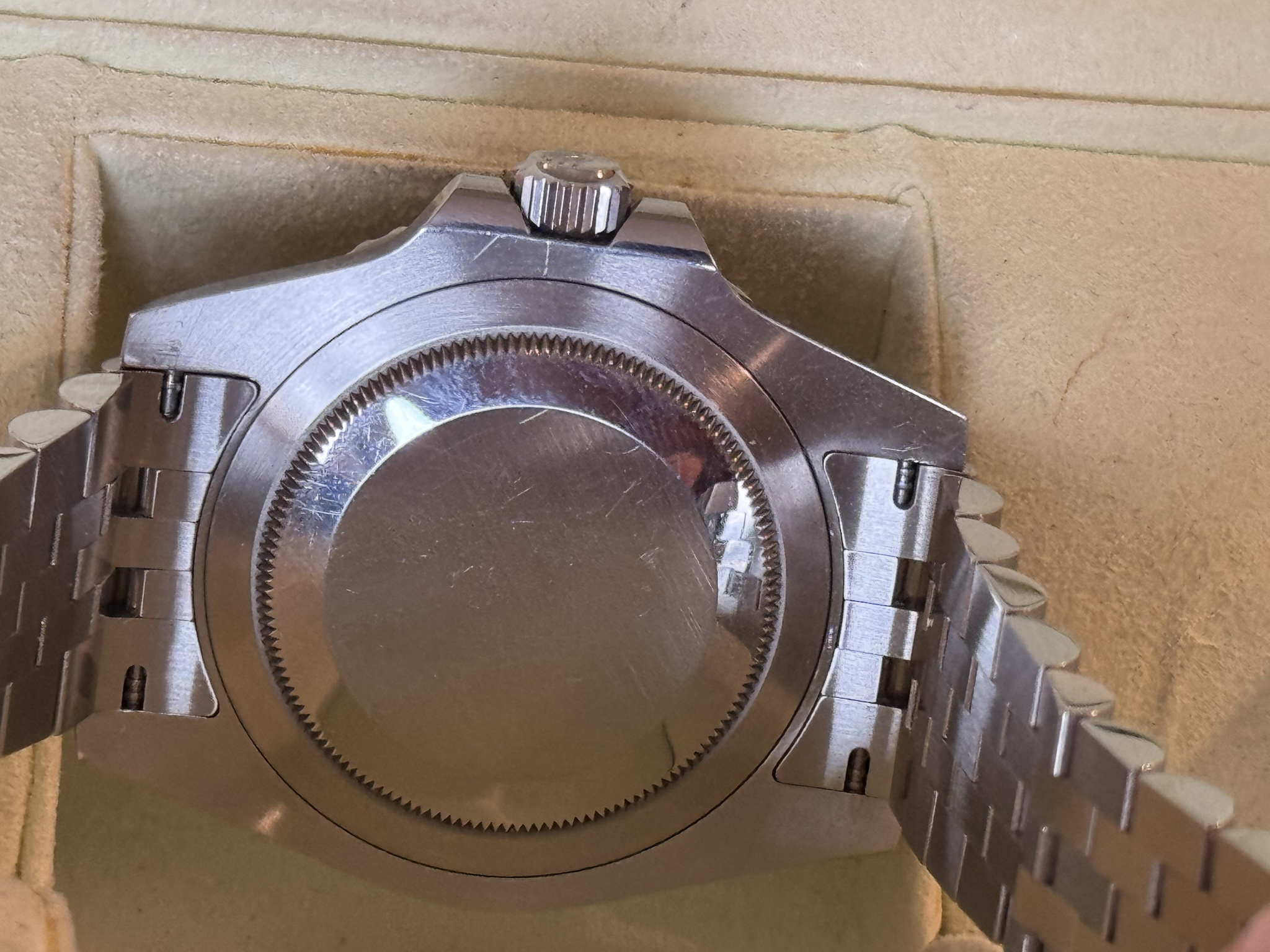

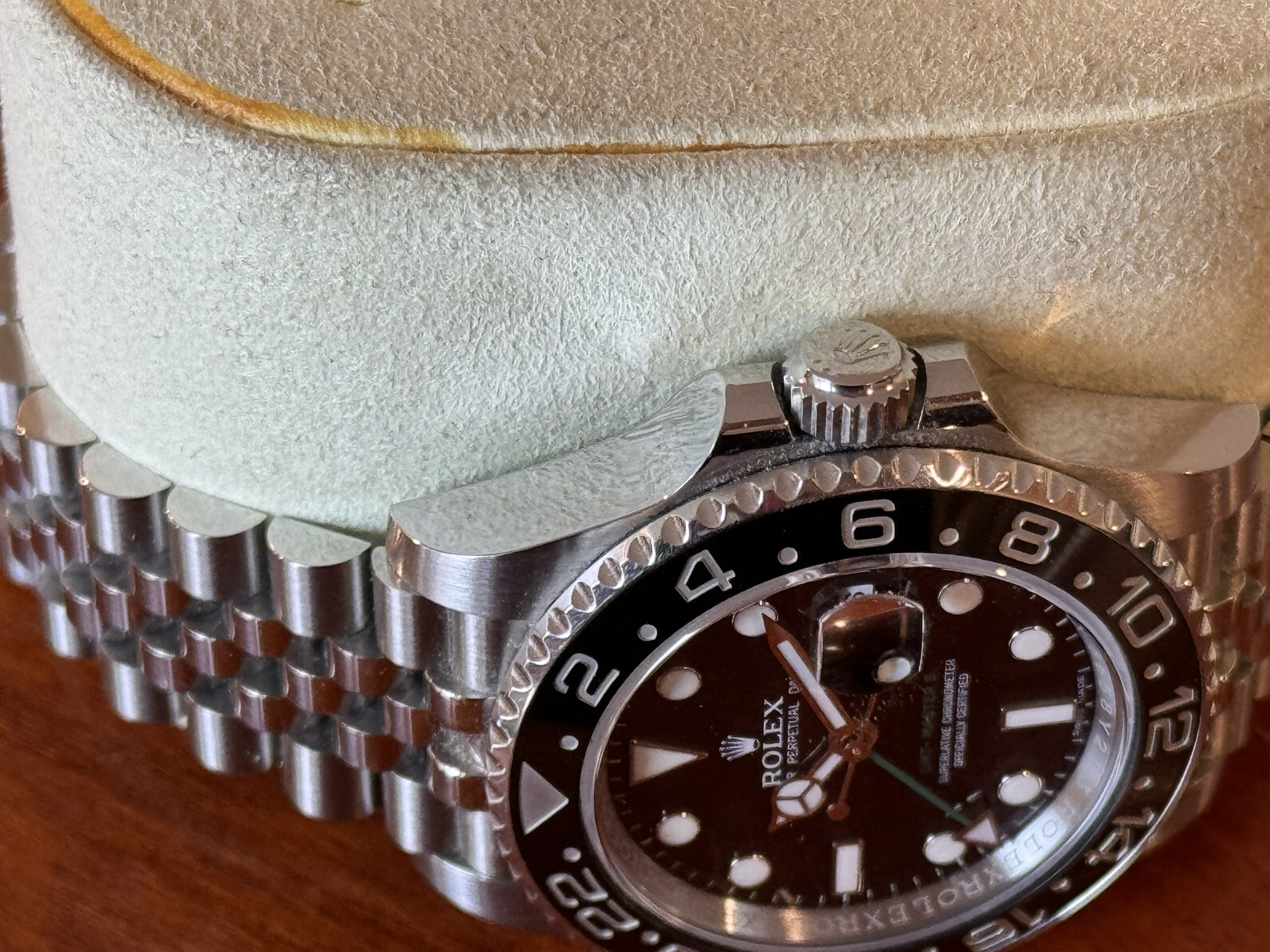

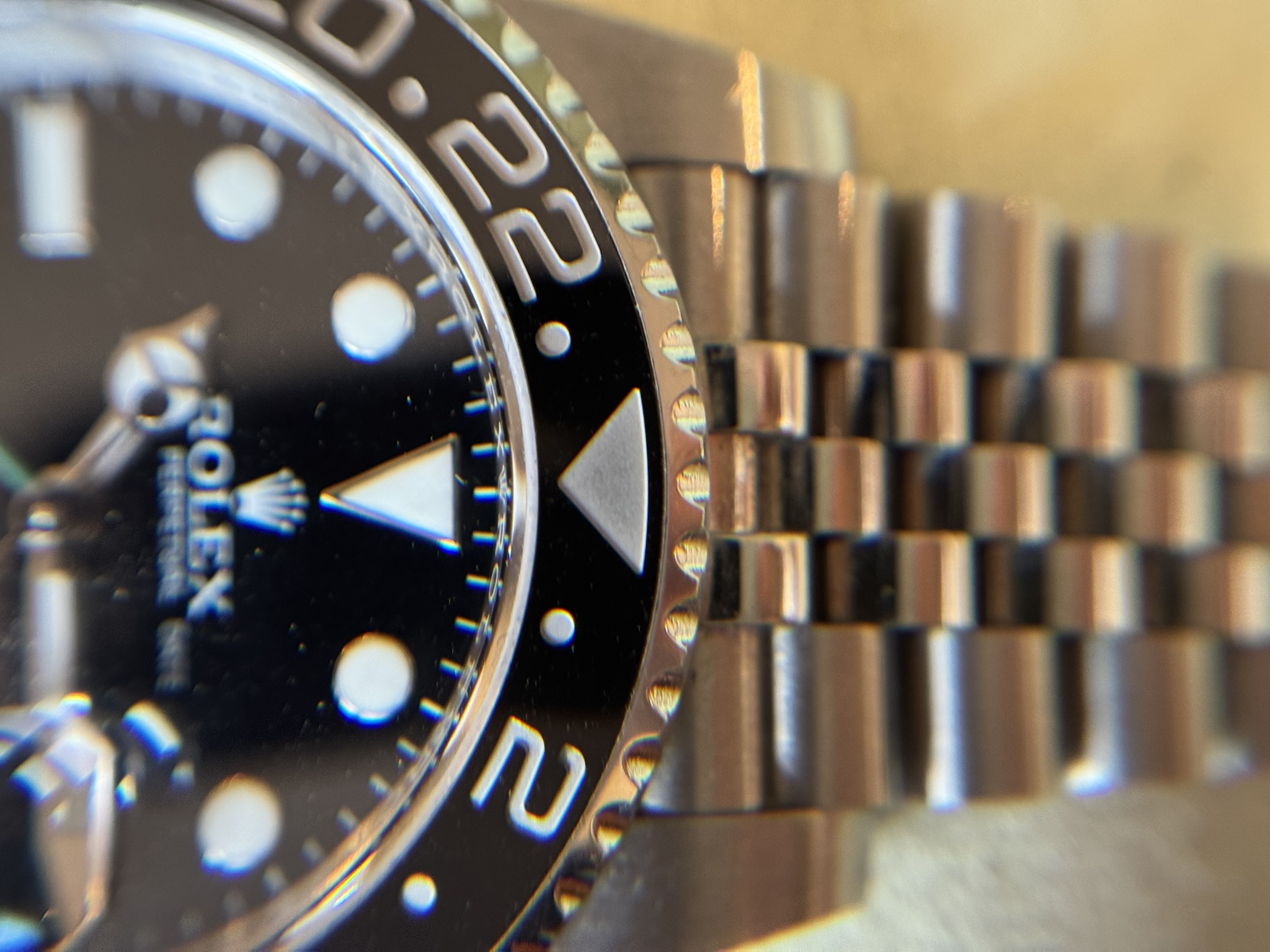

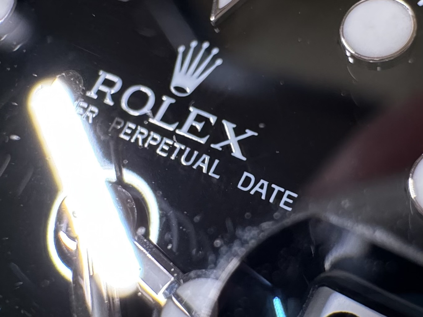

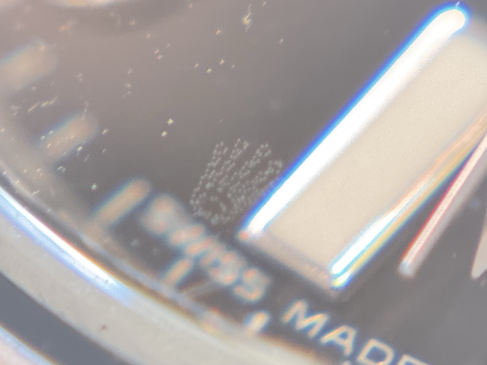

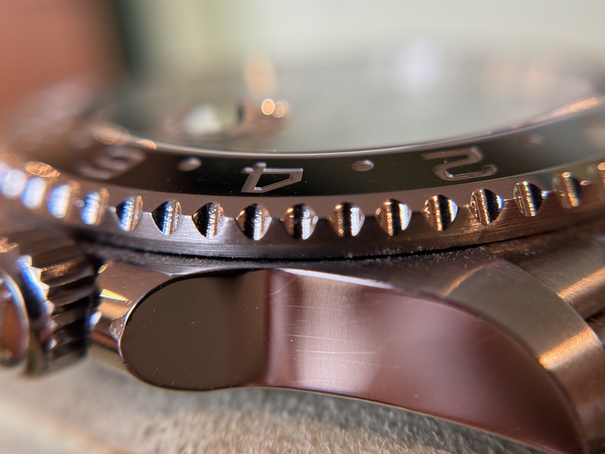

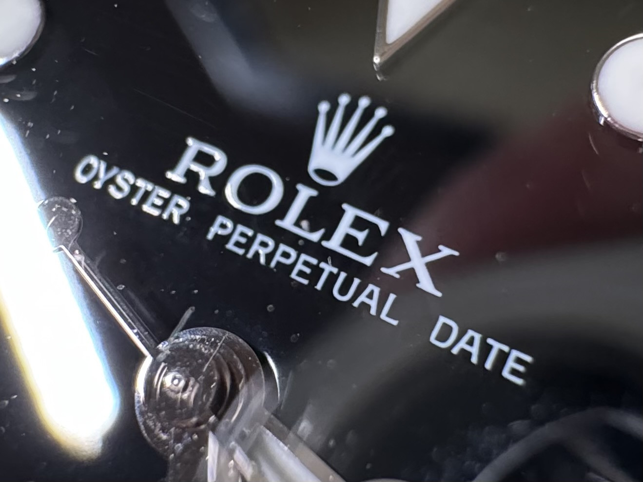

For externals, it has a gen dial, gen crystal, gen hands, gen hytrel ring, gen bezel, gen bezel insert, gen click spring, gen flat washer, gen crystal retaining ring, gen crown tube, gen stem, and gen crown. It has a 2.7mm Clark gasket. The bezel turns really well and everything is just top notch. The case and caseback are CF rep parts.
For the movement, it is a Gen + VR3186 + VS3135 franken. I had a watchsmith named MajorWilliams install the majority of the parts. However he did not install the gen balance. That’s where Mike from watchserviceny came in. He found additional rep parts that weren’t compatible; so I got gen ones and got everything else installed. The full journey is below the photos.
I have a PDF of relevant convos + screencaps of all purchases here: https://drive.google.com/file/d/1Pg-AEKkLiheOmCO2a8kZL4_xpDDv-P5o/view?usp=sharing

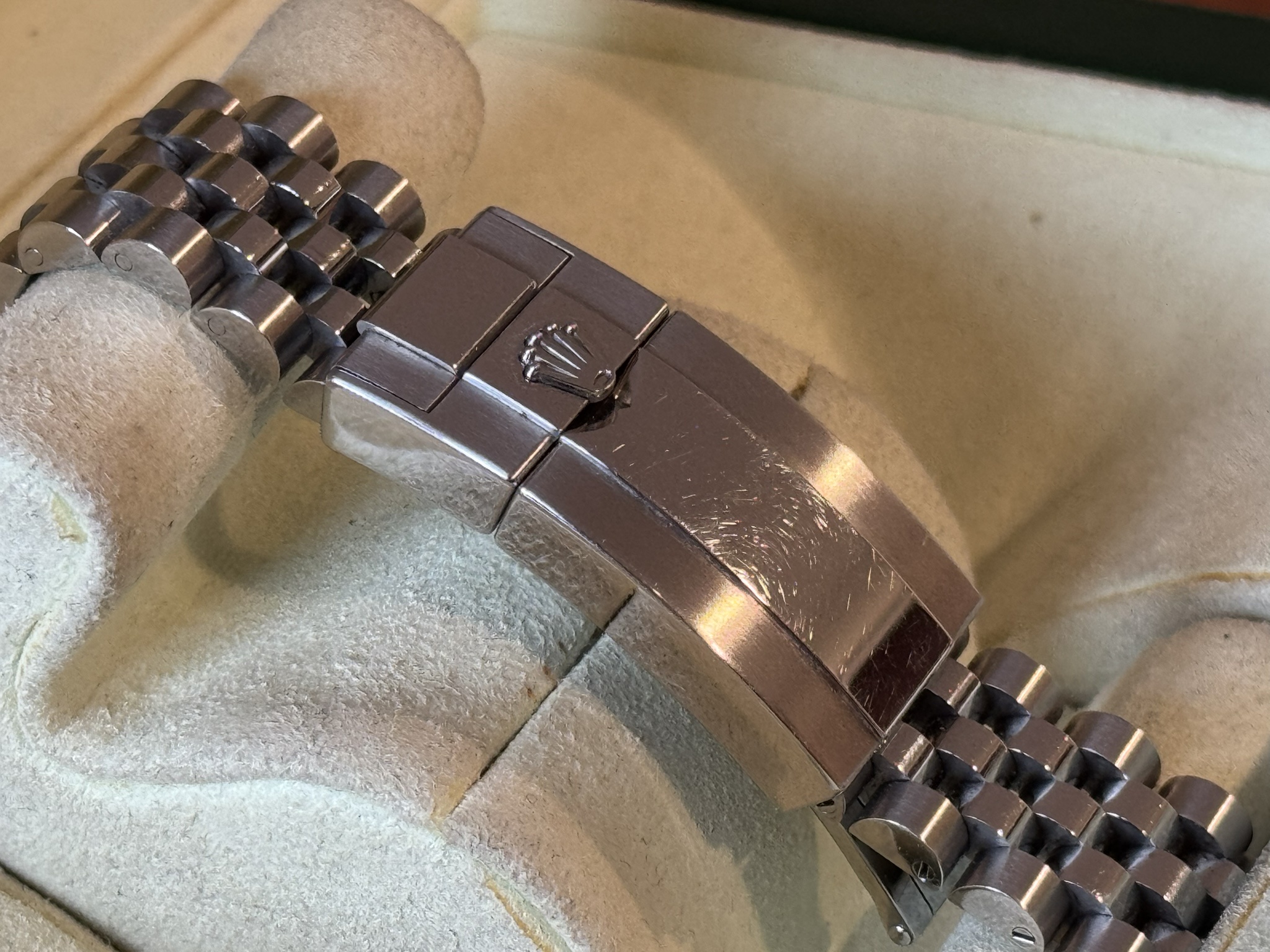

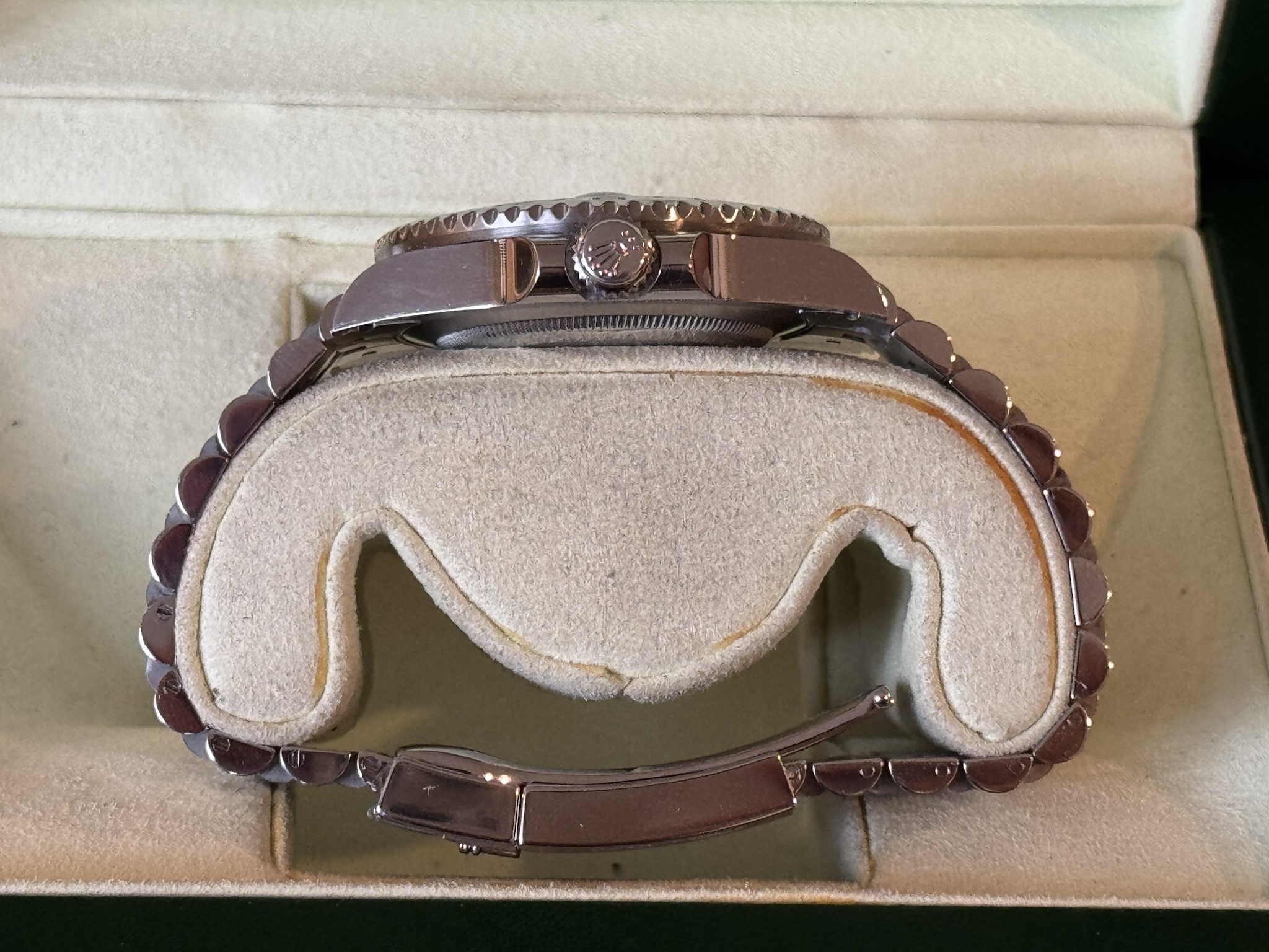

This will come with an ARF jubilee bracelet.

Here is a video of the watch itself for function testing:
Pics:
Here's the journey:

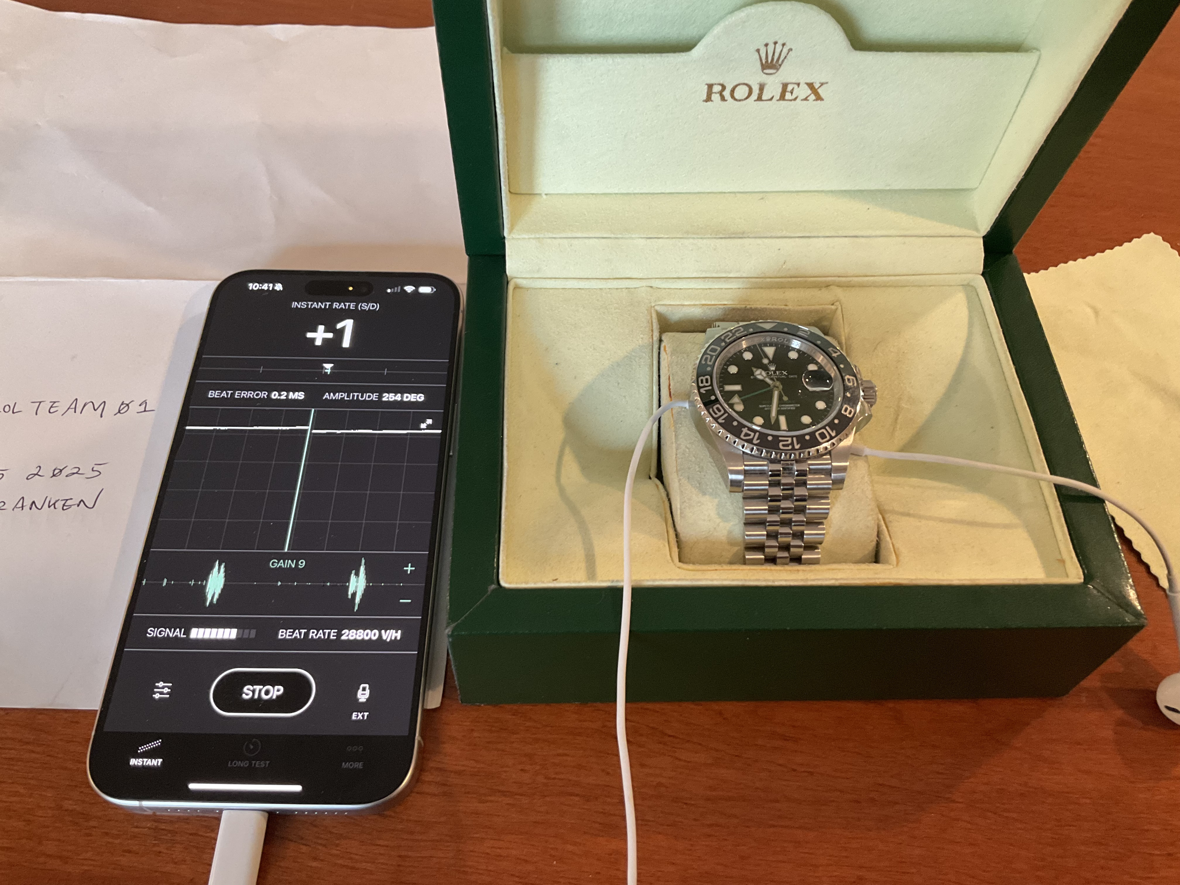

When I received the watch, I noticed the winding was smooth had bit of resistance (resolved on next stage). It passed water pressure test of 5 ATM. It ran at +2 s/d, 0.1ms beat error, and 229 deg of amplitude

After the watchmaker received them, he installed everything and it runs at 0.7 s/d, with 0.1 ms beat error, and 272 deg of amplitude. It did NOT pass his water resistance test of 9.5 ATM. But since it passed 5 ATM before, I am good with that.
I feel so good about this watch. It runs like a champ and I don't have any worries about winding, changing time, or just fiddling with the movement.

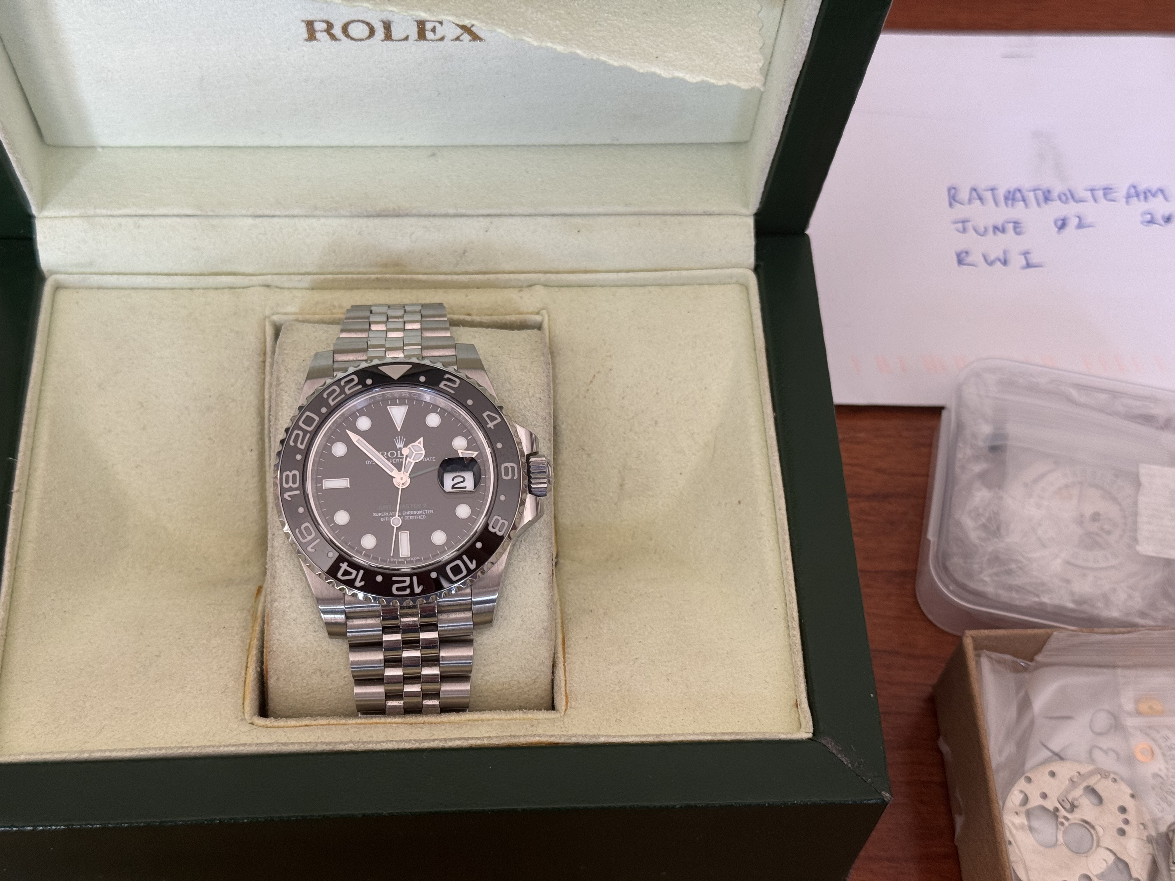

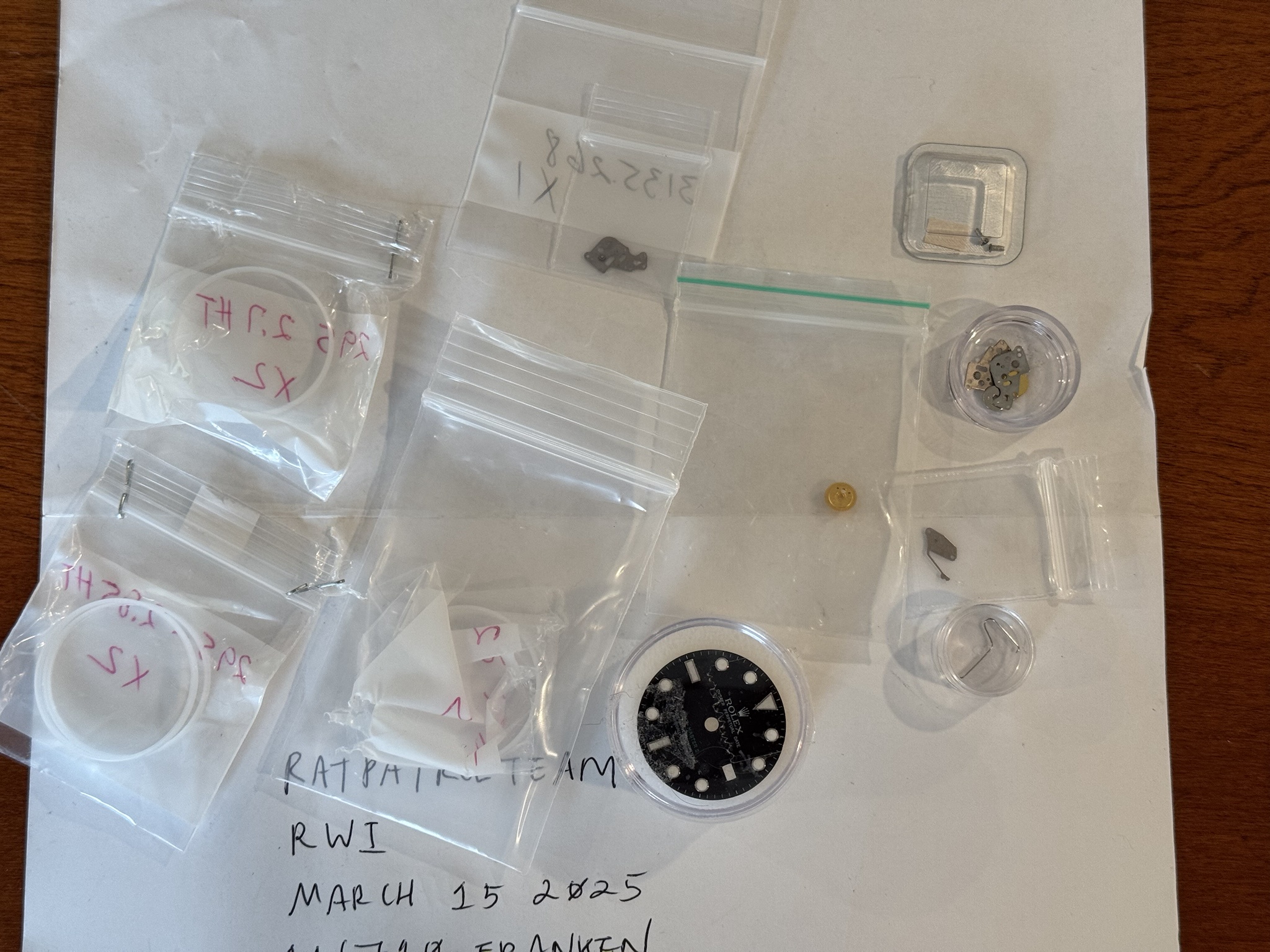

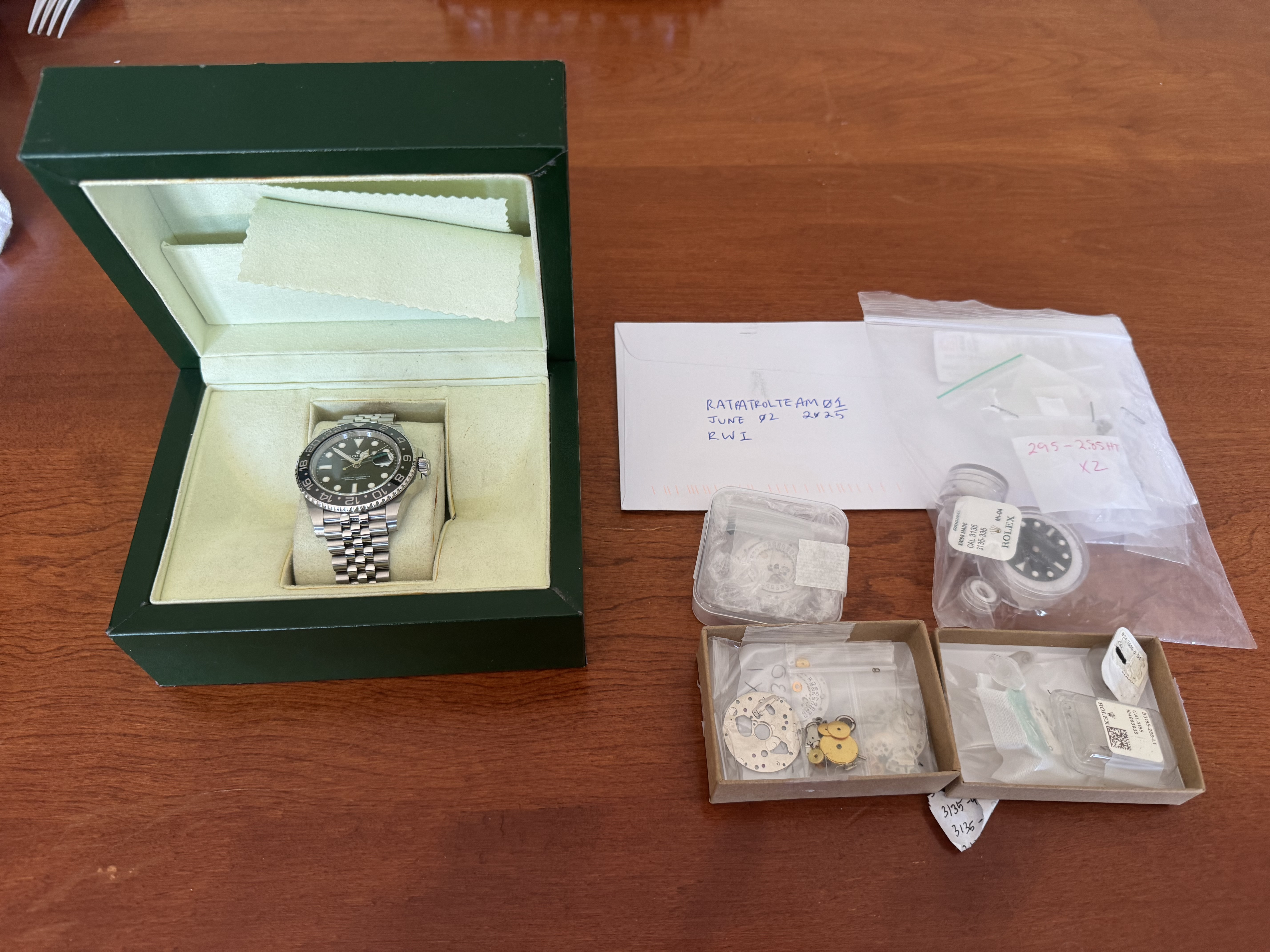

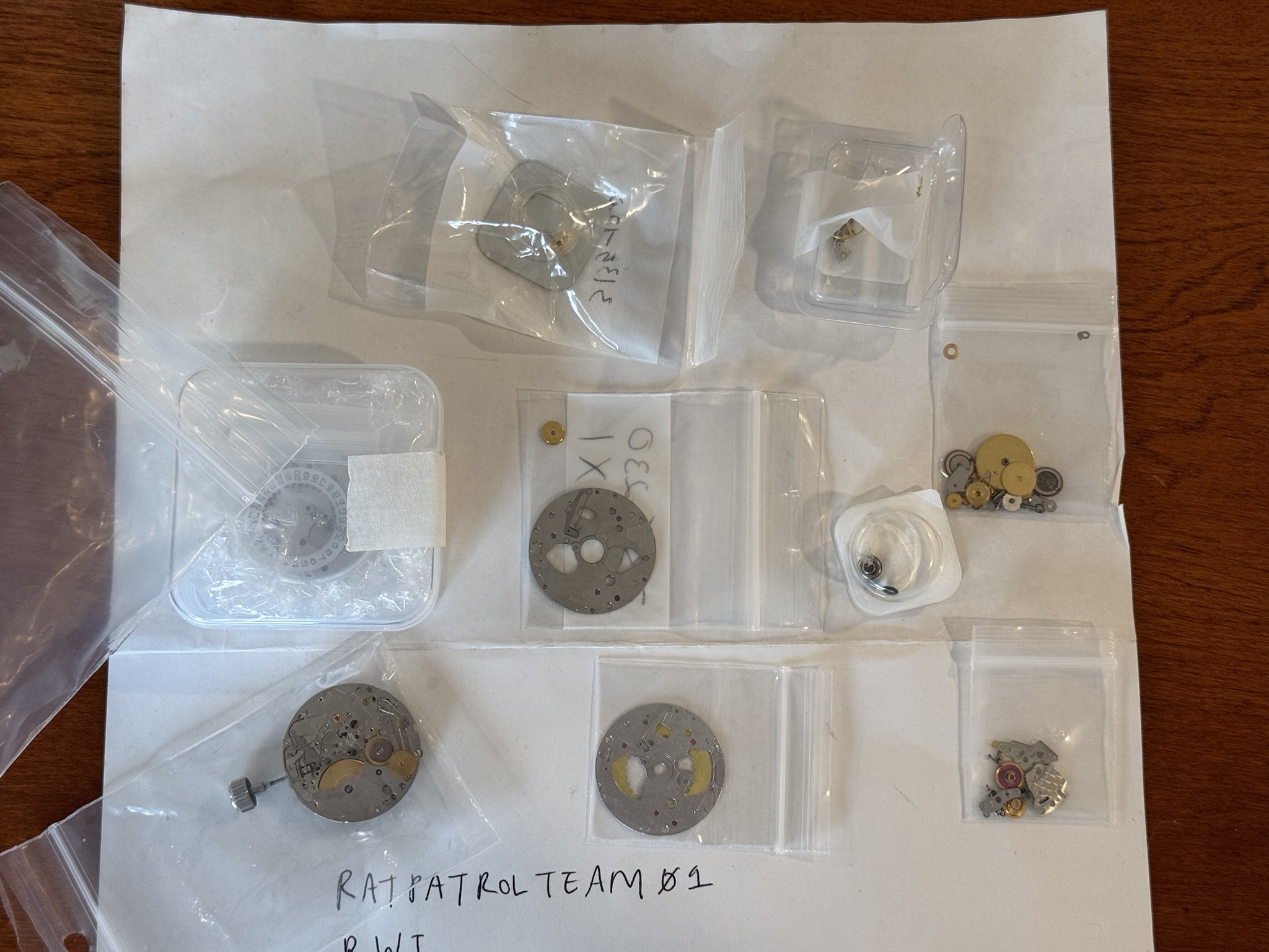

Spare parts photo:
The spare parts picture with movement / movement parts are all rep parts / left over parts with an unopened VS3135 that was supposed to be the backup donor. This is included in the listing.
The spare parts picture with the dial *should* be all gen or Clark parts. The dial is the gen dial with the scratch on it.
