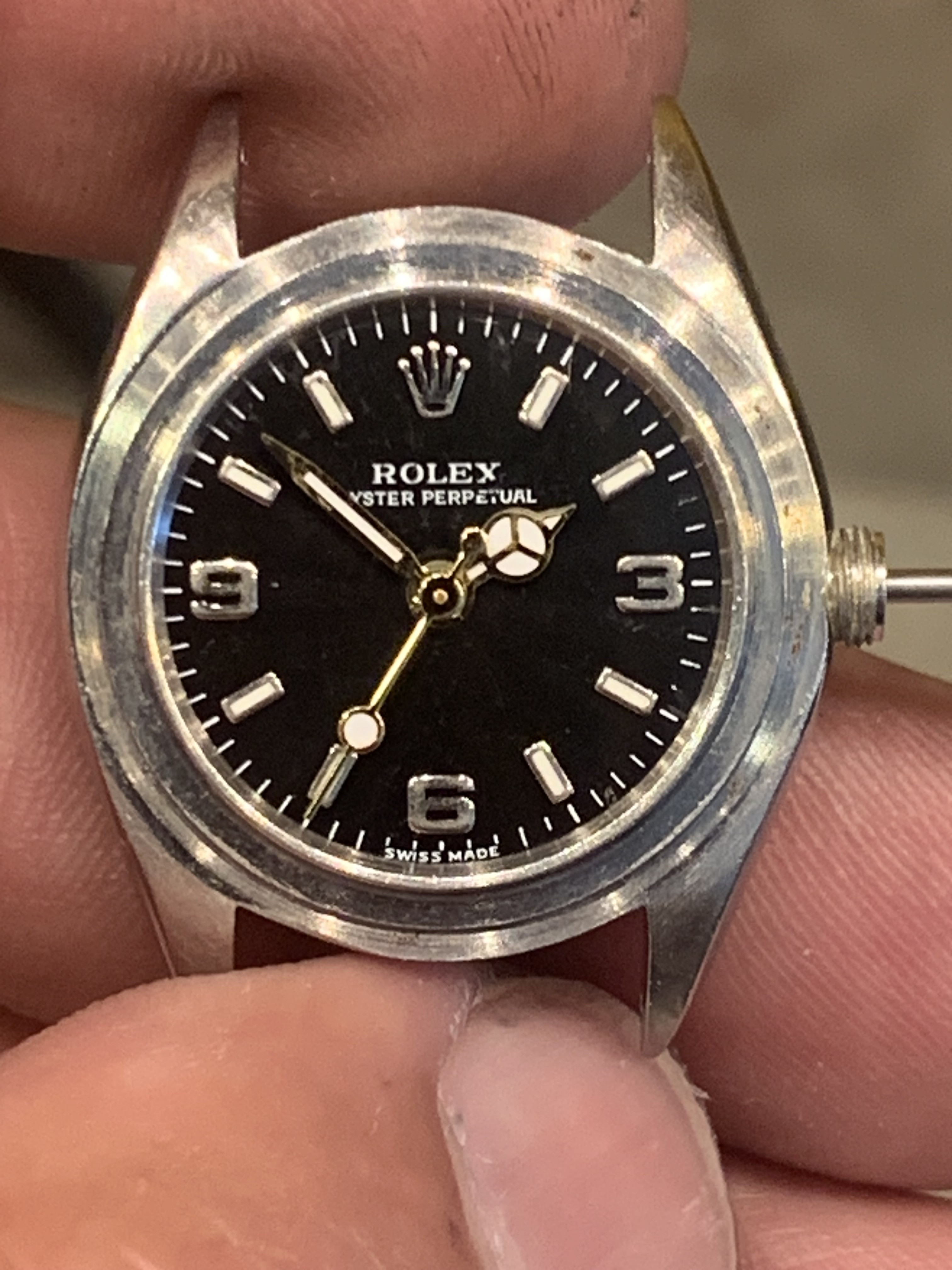

So far, I've finished a Datejust in a 26mm case and a no date in a 24mm case, using all gen dials, cases, and bracelets. The only rep parts have been the movement and hands, and occasionally crystals from Clark's, when I couldn't find a gen crystal. Still waiting on some of the parts, and some of what I've built might still be changed, but this is the first drafts:

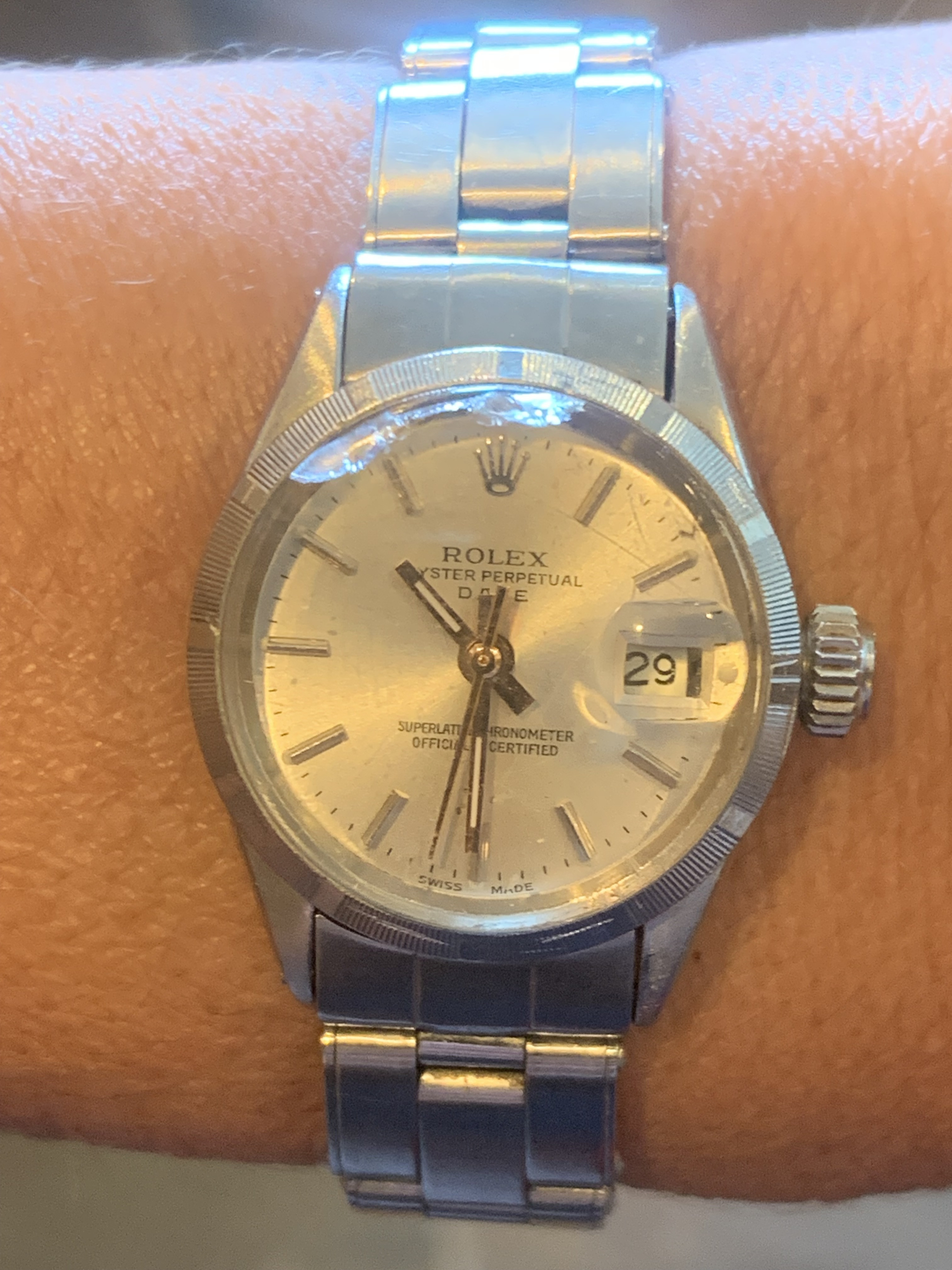

26mm Datejust (although the dial is from a "Date," I have a nice DJ dial waiting to be swapped in. Also will replace the crystal with one in better shape, and the hands with a better matched pair). The date window doesn't line up, although I made a few prototype DWOs by shrinking and printing ones from a bigger watch...I tried using gen DW as overlays, but forgot that the Rolex DW rotates the opposite way).
24mm "Explorer" style. Hands are gold and will be swapped with silver, and it still needs a crystal (from Clark's) and bezel (incoming any day now).
