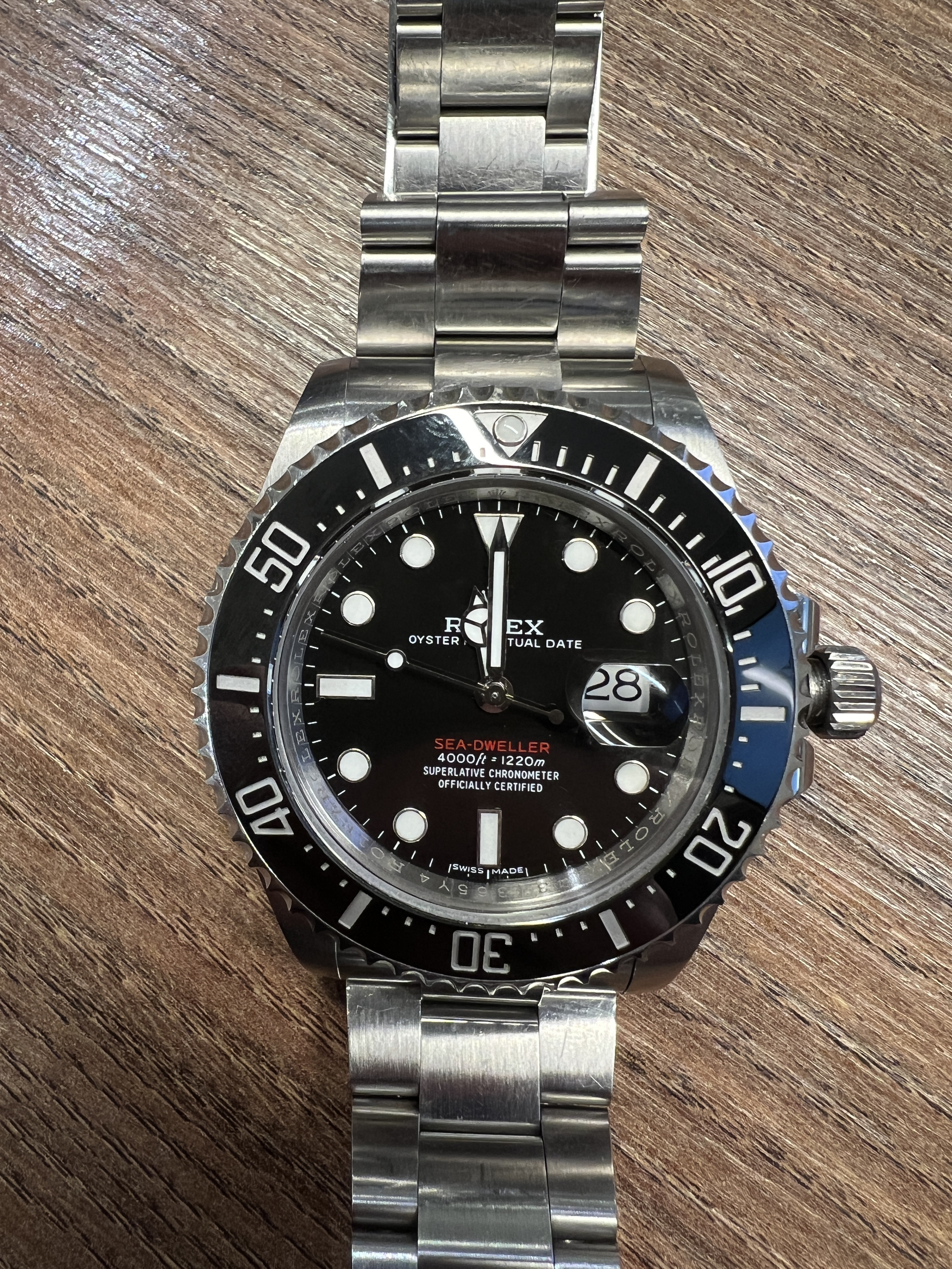

Hello everyone,
I have this replica watch for almost 4 years now and I have noticed a problem with the watch hands recently.
The type is a 2019:
ARF v2 Red Sea Dwller​
They don't align anymore at the 12 hour mark.
Is this something I can fix myself?
If not can you guys recommend a service point? I live in Belgium.
Thank you very much in advance!

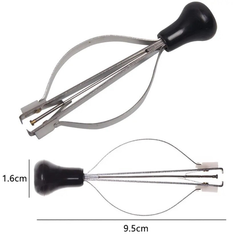

Depends on your watch making skills. I have the tools at home and have removed and set hands successfully, without damaging the dial, on cheap watches.
On an ARF, I'd probably do it myself. On a gen certainly not though... 😅
You'll need tools (a hands press, a case holder, a movement / casing cushion, loupes in different sizes —ideally ones that you can wear like glasses—, hands pliers, case opener(s), watchmaker's screwdrivers in different sizes, a Bergeon dial protector, plus probably a few other tools I'm not thinking about right now... ) and some basic skills. So, generally speaking, if you have never done it before, it's highly recommended to take a few old Quartz watches first to practice on those how to remove hands and to re-apply them without screwing up the dial or hands...

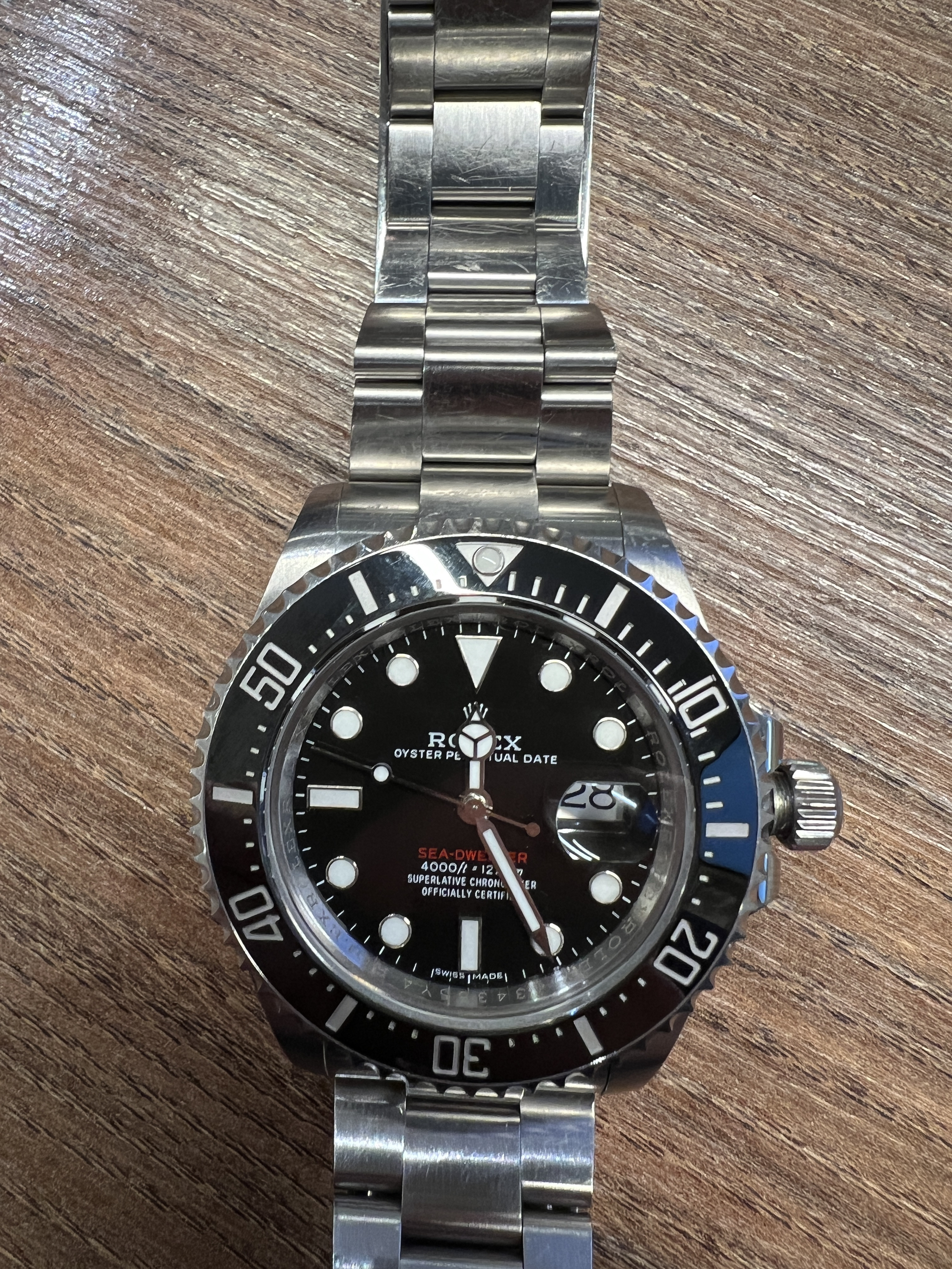

does anyone know what the cause of this could be?
Of course I’m just speculating but I noticed that I was doing something that could cause something similar to happen. I was using my left hand to beat my pack of cigarettes against to pack the tobacco. I also was doing that to bust some ice cubes up that had frozen together in a metal cup. My left hand was like the anvil that I beat stuff against.
The thing is that the hands only have to be a hair to big or the pinion a hair smaller than spec. Mostly I’d bet it’ll fall somewhere into the “shit happens” category.
I have also no clue of how this happened :D
Probably like Zeta said here.
Winni1611
15/10/22
1,633
2,420
If the hand has been moved by beating against the case then the hand hole may have become wider
During the time. In this case you may need a new hour hand.
