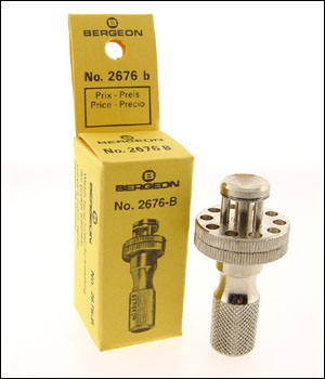

In the case when I have modded the hands (mostly from A7750 to ETA7750) I used following tools and a thin plastic film to protect the upside of the hand when clamp it in the 2676-B tool:
It works good if you are care full and only take little material away (It's about 0,05 mm on the 7750 movement.) I don't know how much it is on the 2892 but it can be measured by the second pin with a caliper.
