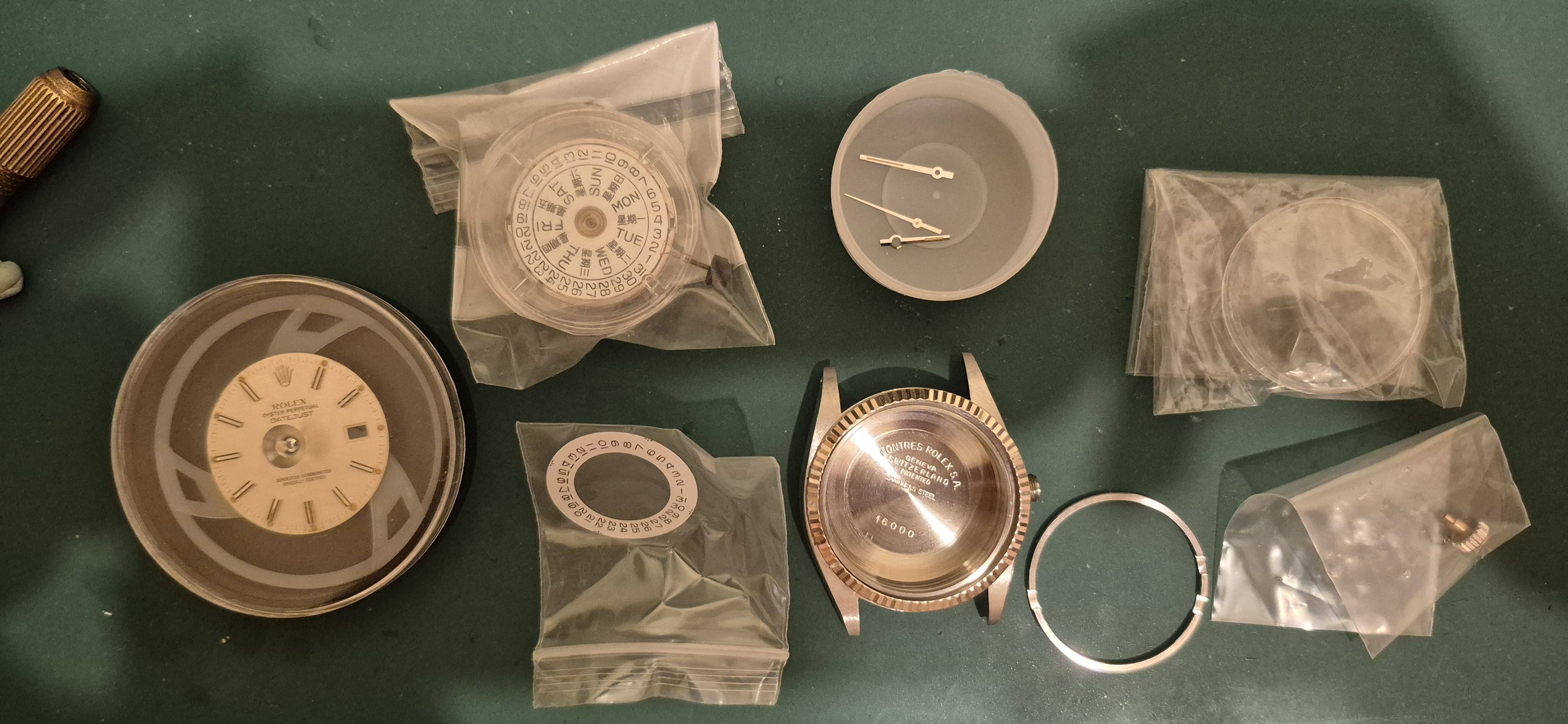

Here are the build specs:
- Gen 16014 case set (mid-case, caseback, 14k fluted bezel) (the case appears to be unpolished and in excellent condition)
- Gen linen dial (excellent condition)
- TC dwo (new old stock)
- Clarks dress hands
- ETA 2836-2 movement (new)
- Aftermarket Swiss 25-135 plexi
- Helenarou movement ring
- Aftermarket 6mm 600 crown

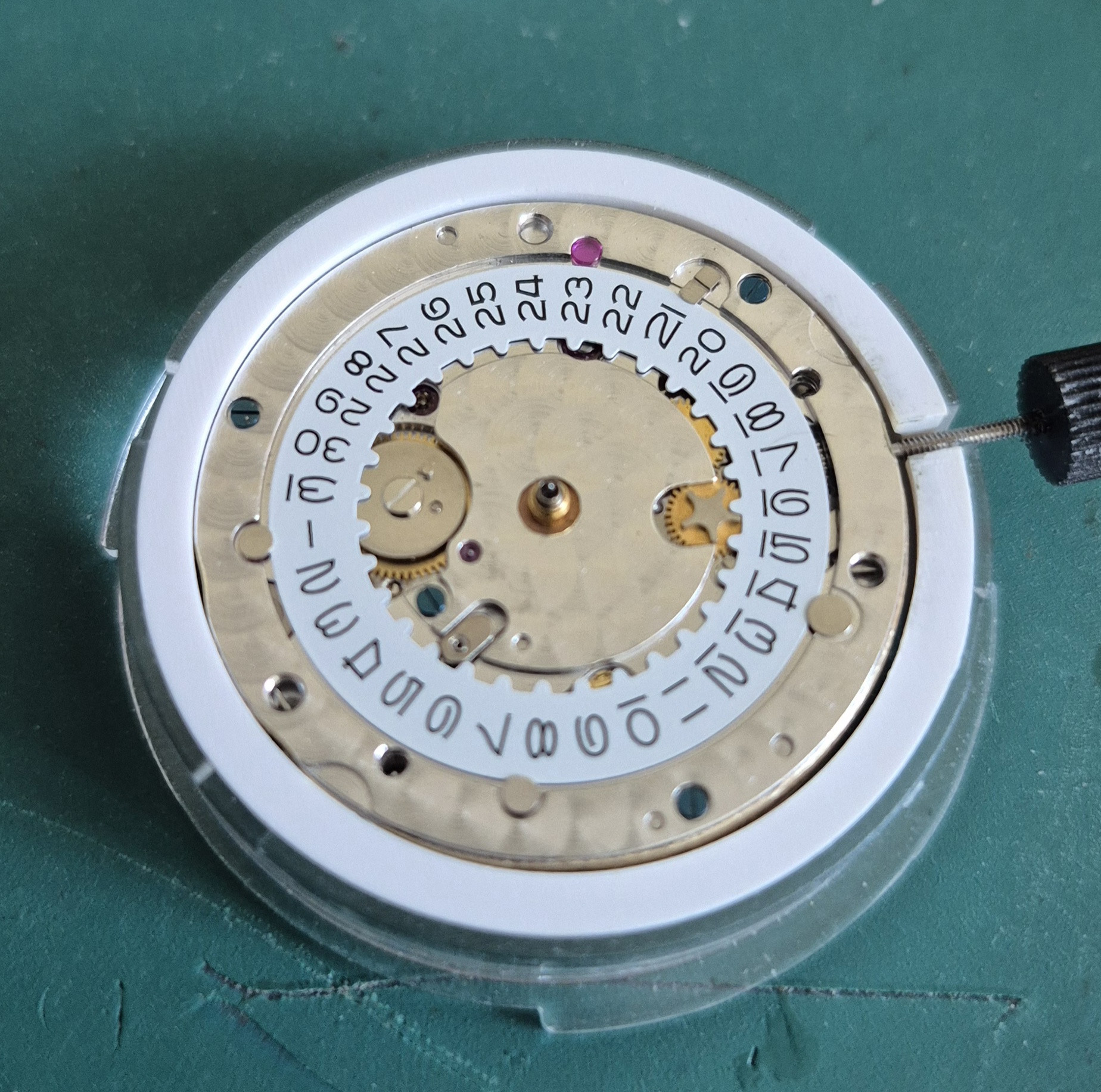

Ultimately, I decided that using an ETA 2836-2 is too easy/ boring, so I decided to try to shoehorn a VS3135 movement into the case. I was inspired by this post: https://forum.replica-watch.info/threads/franken-rolex-datejust-build-with-vs-3135.10919812/.
Since I am using a VS3135 movement, the build specs were changed:
- Aftermarket open 6/9 3135 date disc (https://www.aliexpress.com/item/1005007655696180.html)

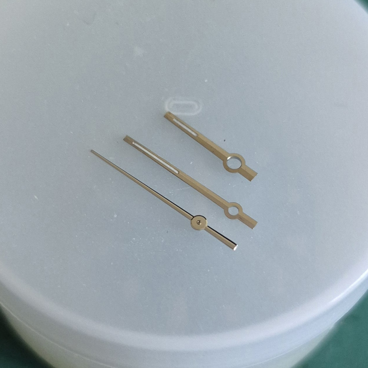

- VERY gen-spec mix of hands (including external dimensions, dimensions of the lume plots, finishing, and the cylindrical feature on the seconds hand)... let's just call these pompompurin V1 datejust hands
- VS3135 movement
- Silian 3135 tab/ screws
- High quality aftermarket 6mm 600 crown

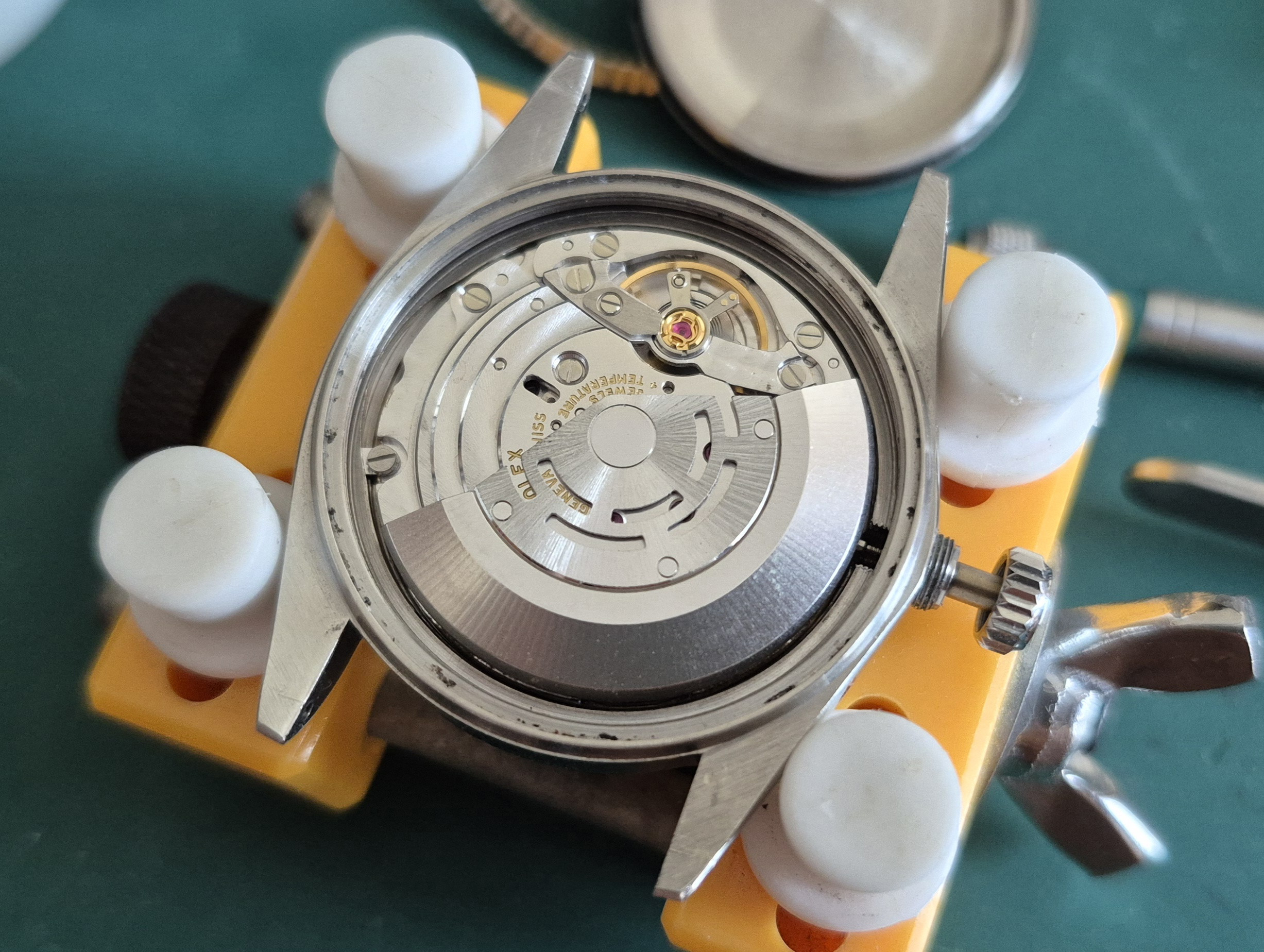

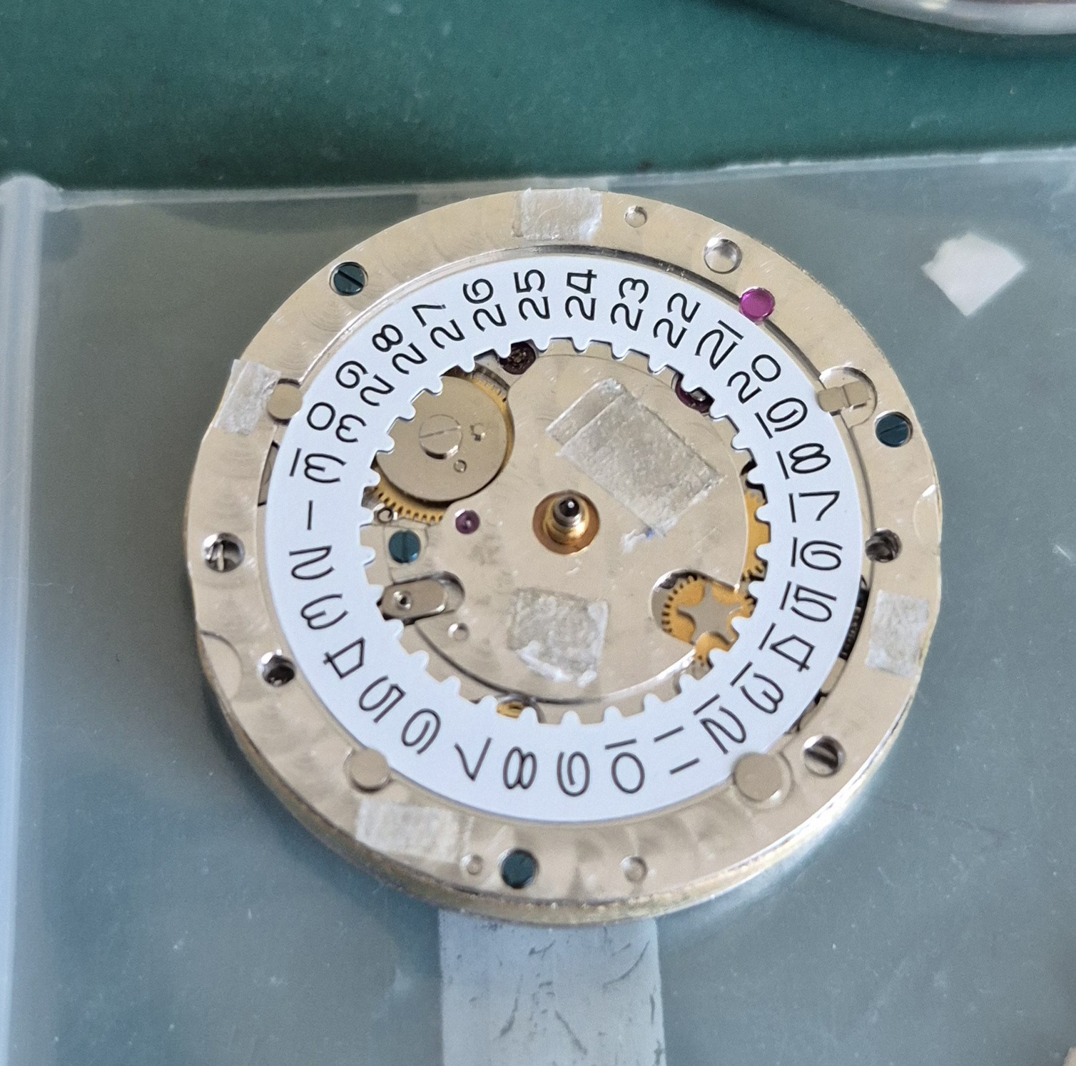

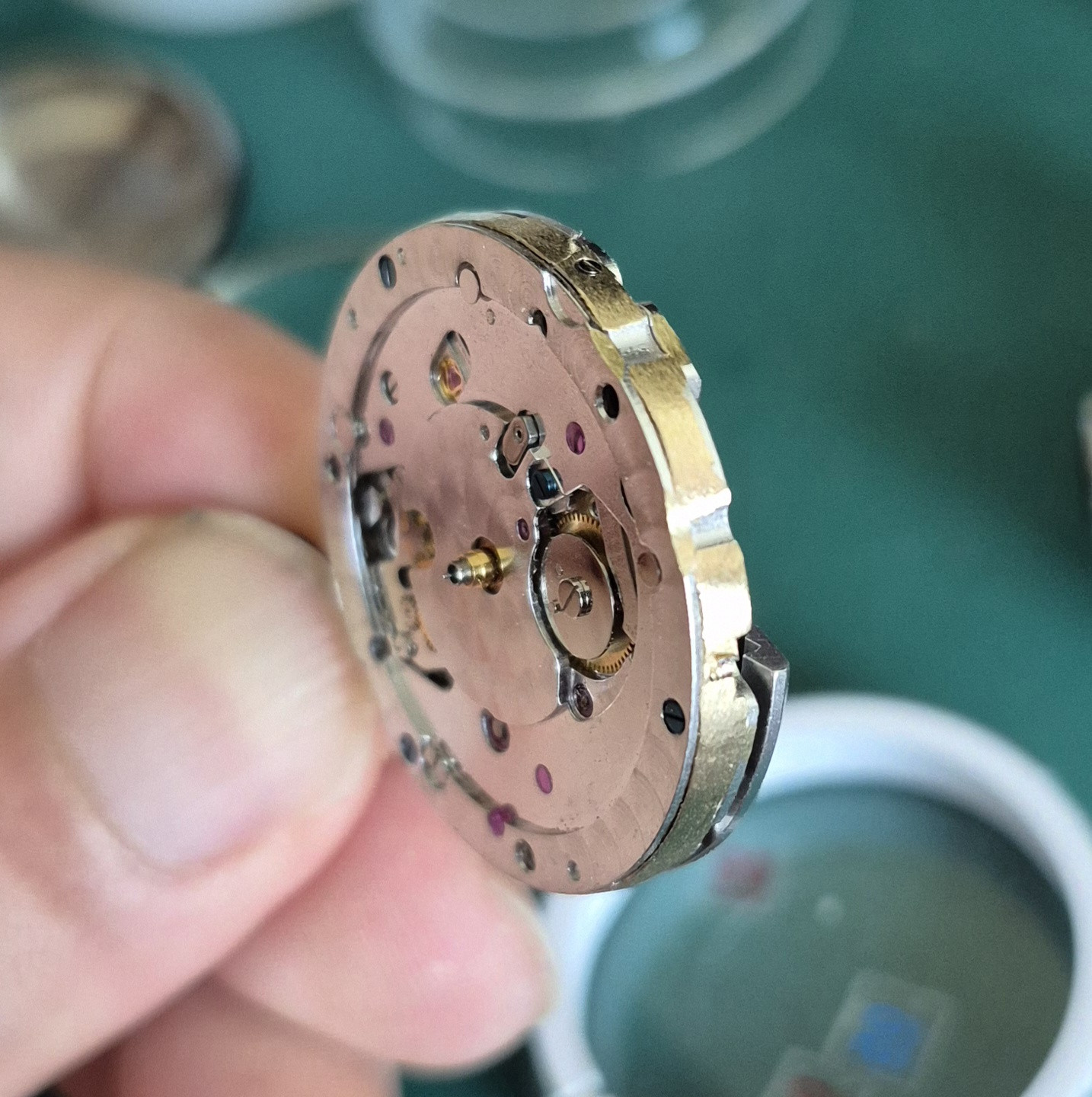

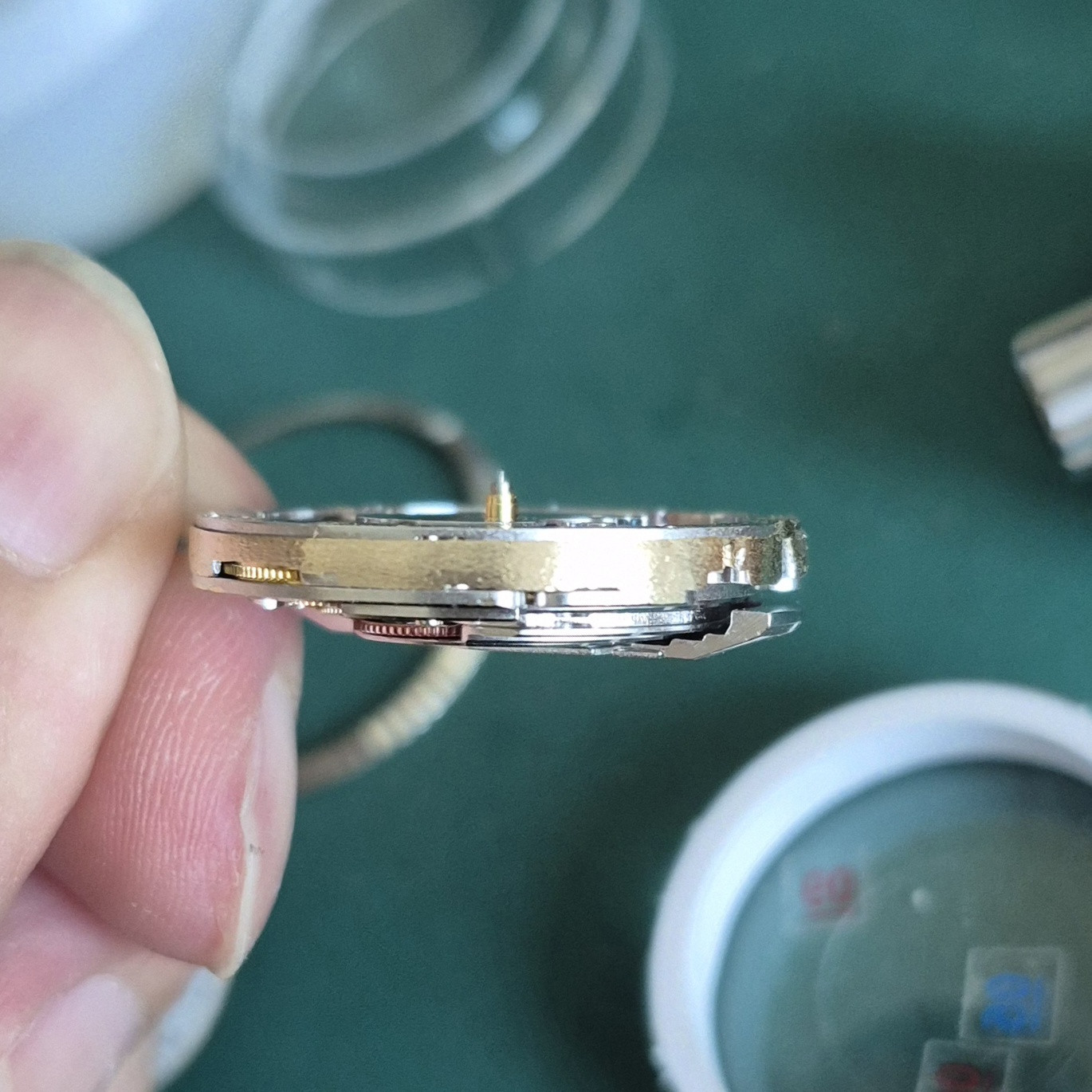

The VS3135 movement was partially disassembled and taped before using a dremel to reduce its external circumference.
After trial and error and various attempts, I managed to make the VS3135 fit inside the gen 16014 case set.

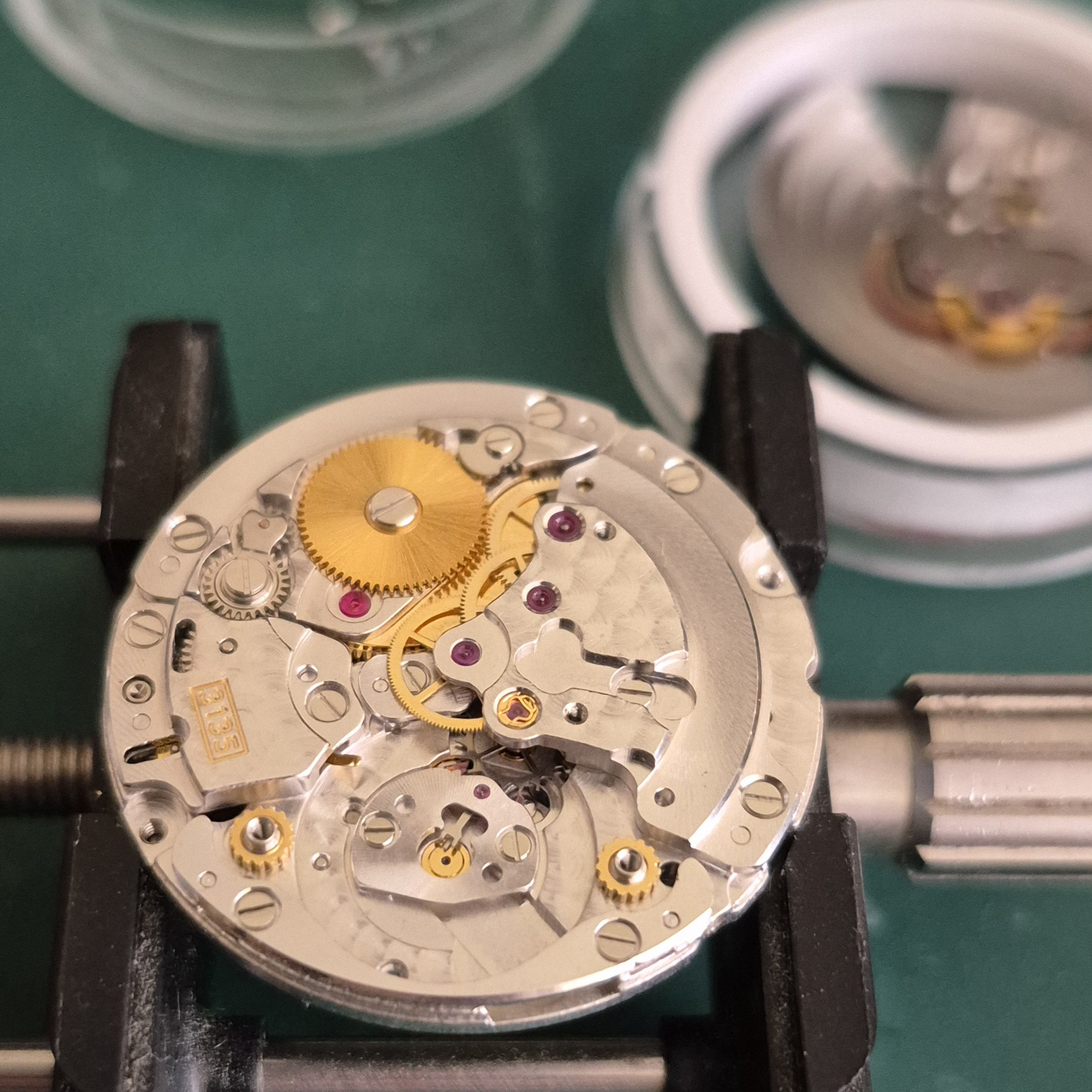

The movement was reassembled and tested. The Aftermarket open 6/9 3135 date disc was fitted and tested to flip properly at every date and 12:00am positions.

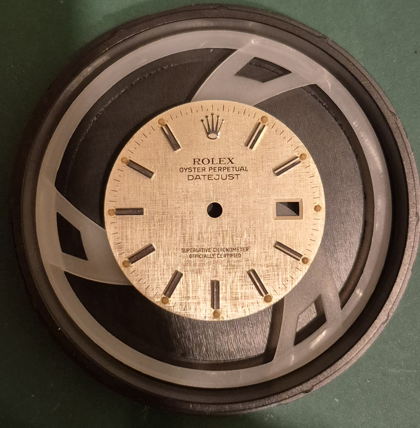

Since 3135 movements' crown/ stem/ tube height differ to 3035 movements (and the gen linen dial that i am using for this build does not have dial feet), i added two layers of double-sided sticky tape to act as shims (to align the crown/ stem/ tube height) and to mount the gen dial onto the movement.

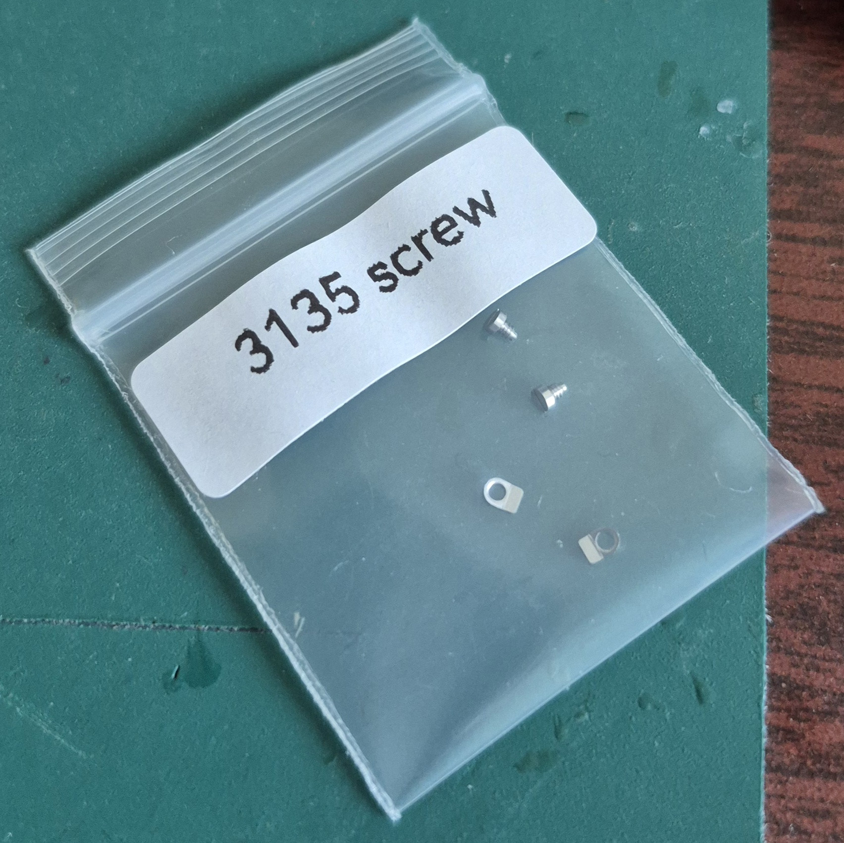

I also used silian's 3135 tab/ screws to align the movement inside the gen 16014 case set (https://www.alibaba.com/product-det...-Clamps-Securing-Screw-Fit_1601442652554.html).

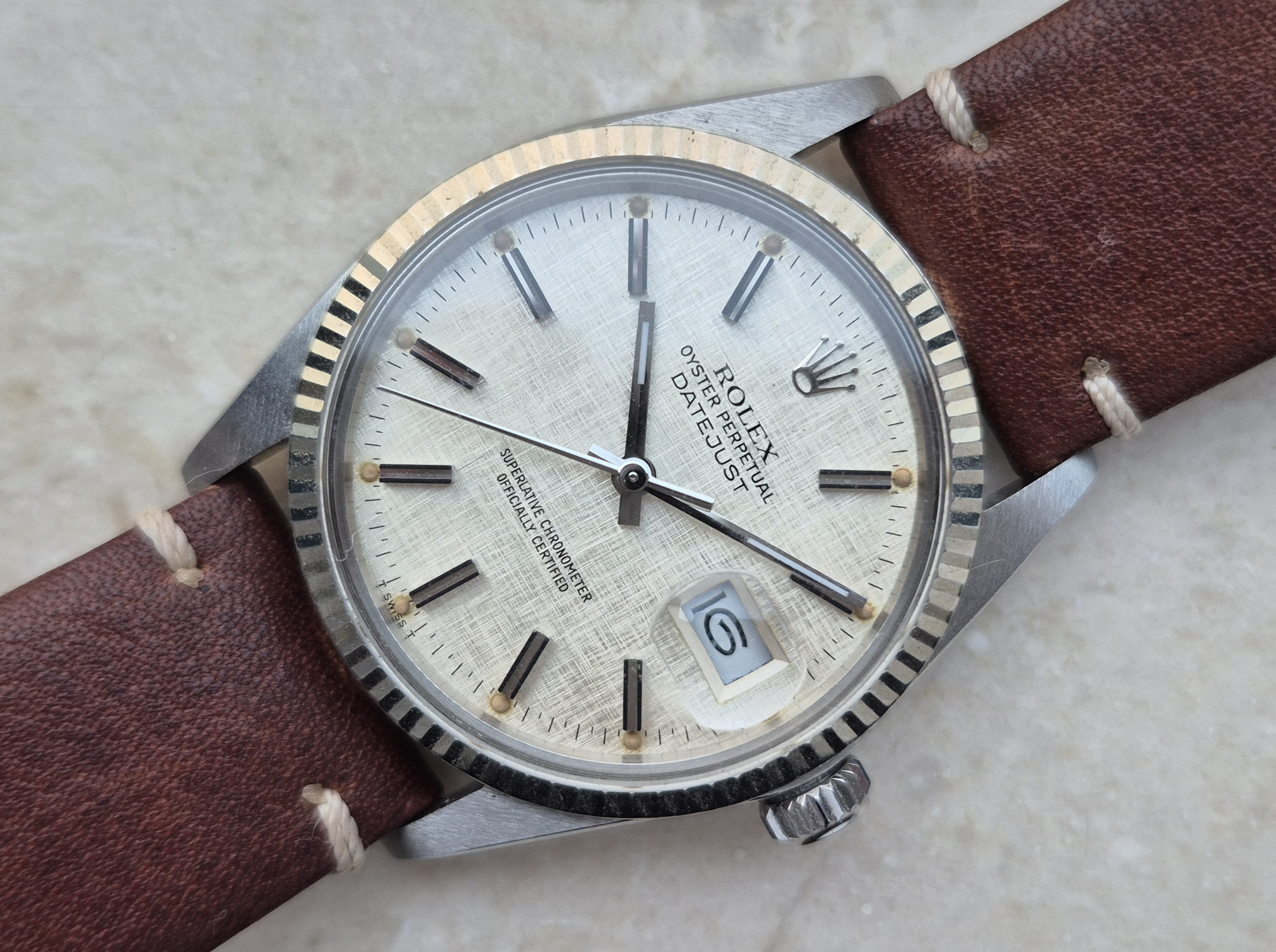

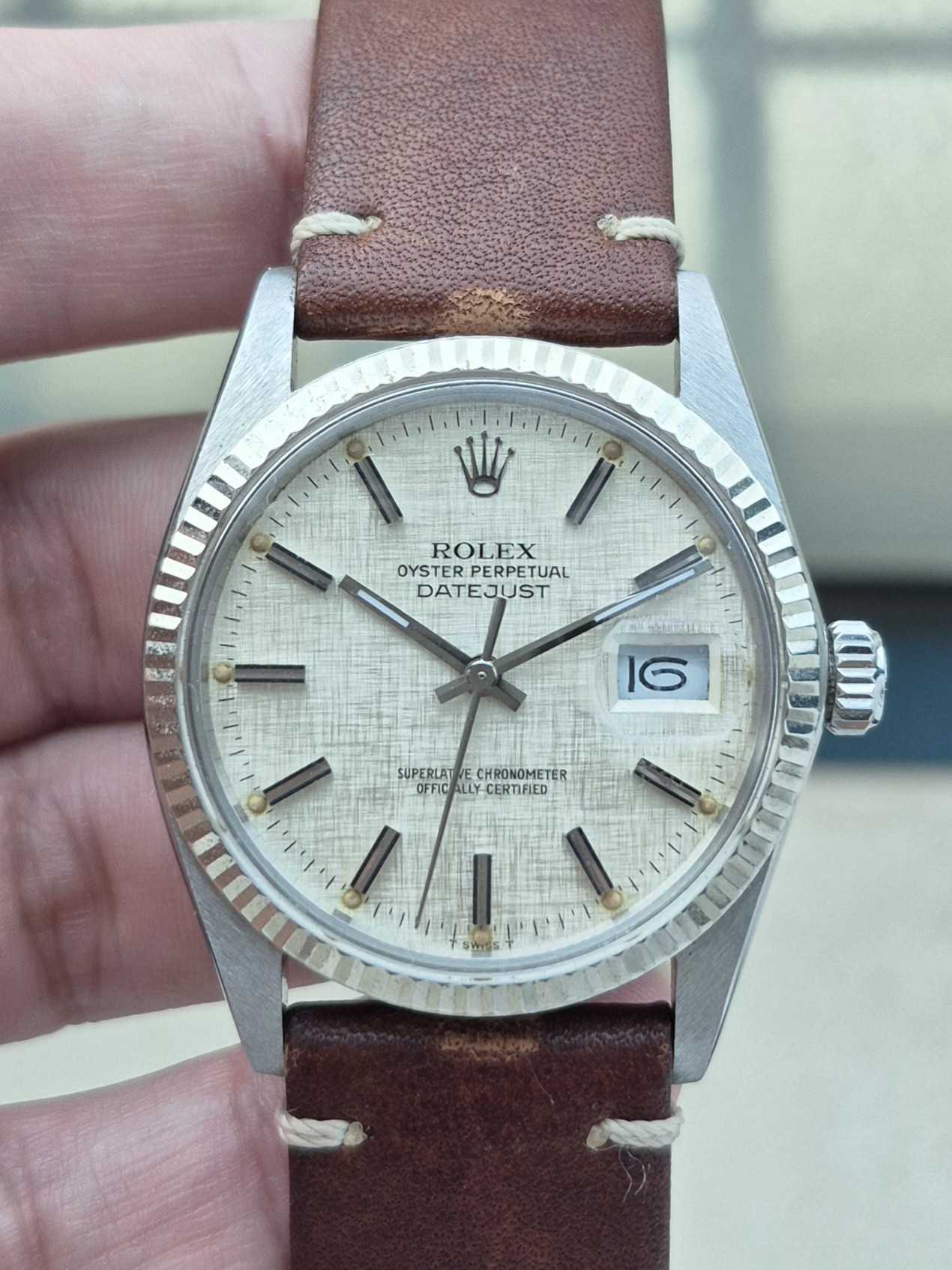

The crystal, hands, and bezel were eventually installed. I decided to use my pompompurin V1 hands (which were already lumed by me, using Swiss C1 superluminova). Superluminova hands on a vintage Rolex are within gen parameters because there are vintage Rolex that were serviced by RSC (Rolex Service Centre) and have replacement superluminova hands (service hands). Also, due to added layers of the double-sided sticky tape, the movement sits lower and the minute/ seconds hands were bent slightly to clear the dial indices.
The watch is now complete!
