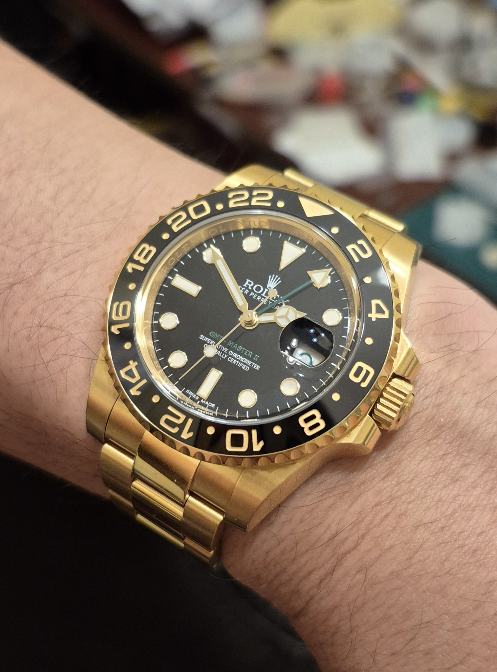

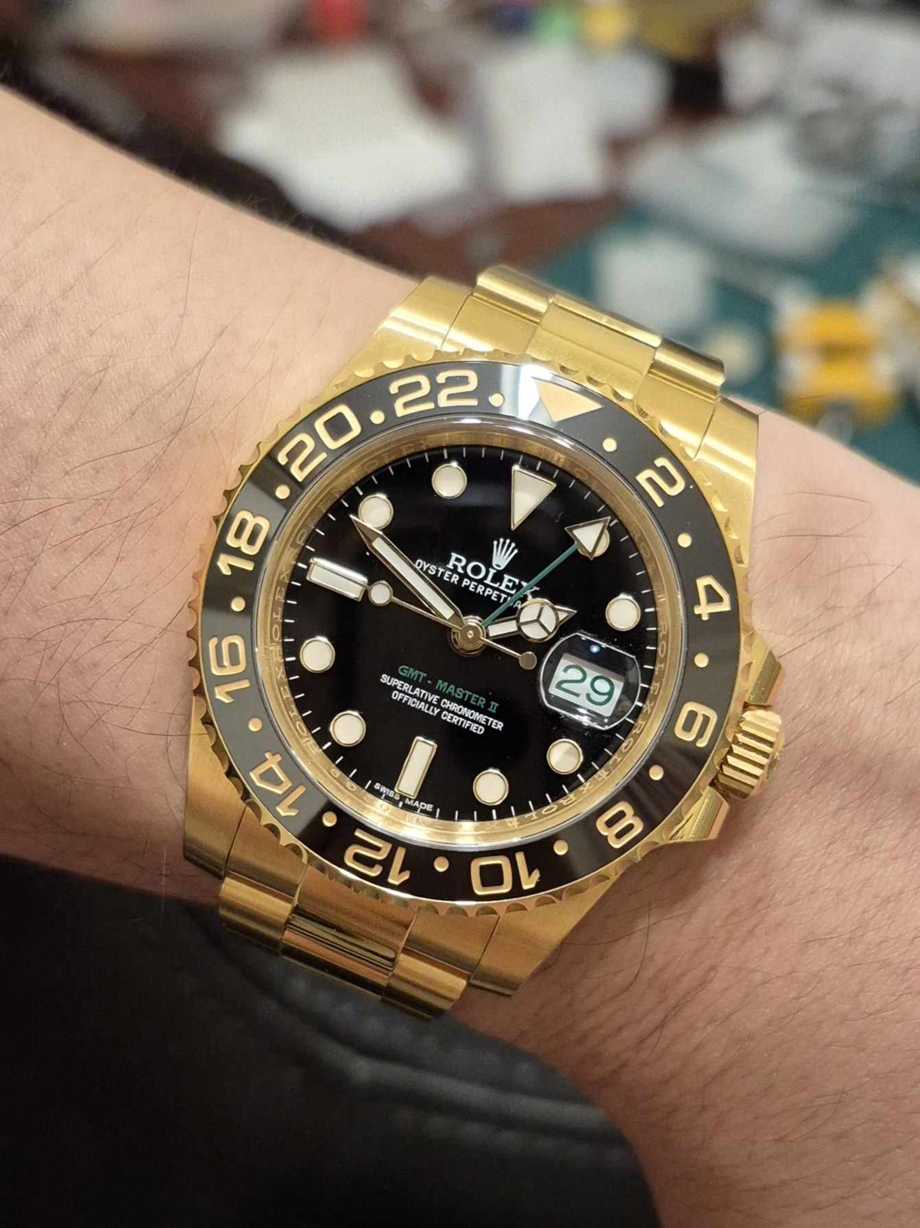

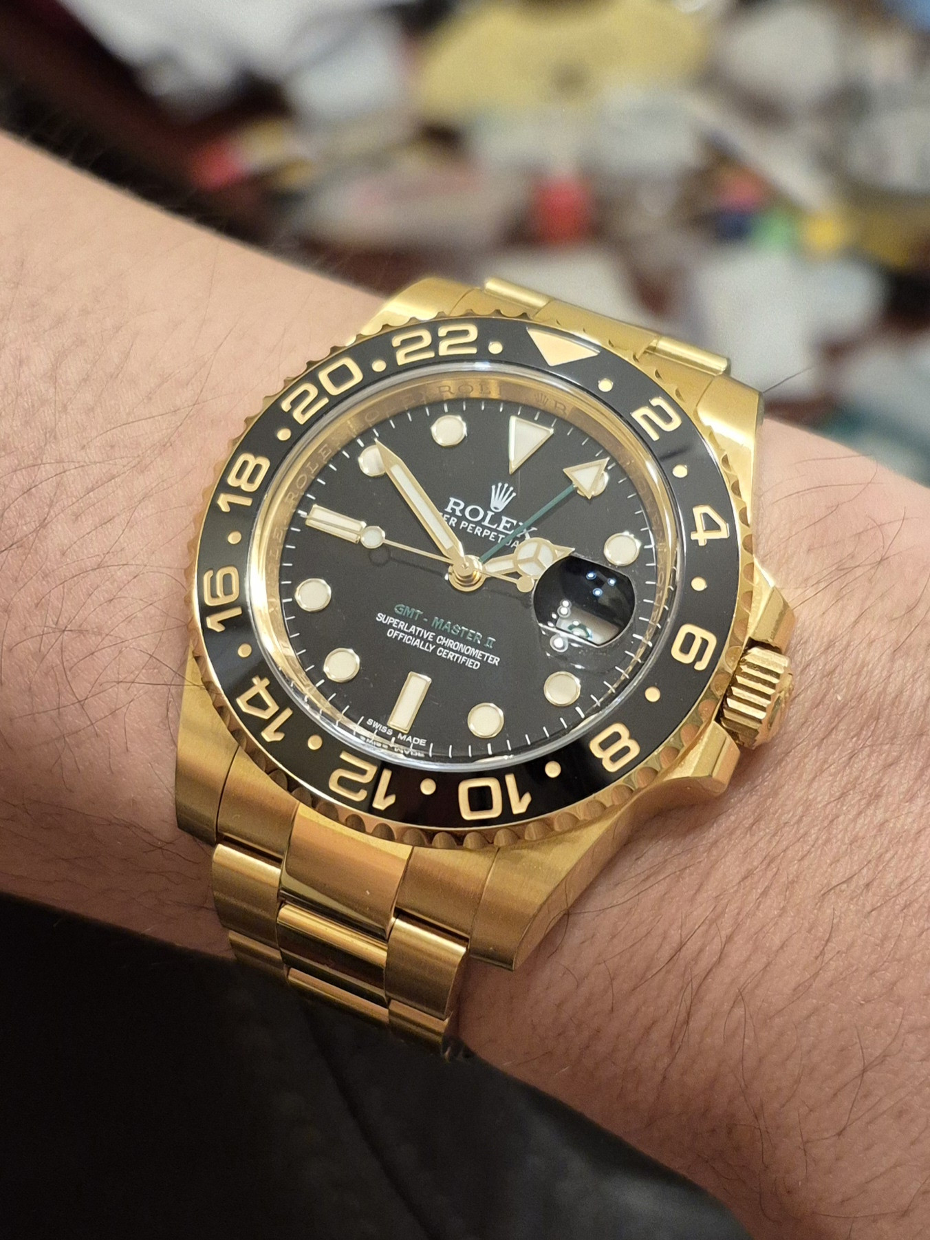

Recent breakthrough! A non-TD informed me that they could source a custom Gold Factory 116718 (gain weight) with oyster bracelet and green dial. I immediately pounced onto this opportunity and ordered it. Within a few weeks, the watch arrived.
Here are a few quick snapshots of the Gold Factory 116718 (with oyster bracelet and green dial):
Apologies for the poor image quality as the pictures were taken at night and under indoor lighting.

Very nice work bro, looks awesome. What crystal did you use? And how is the bezel action on the Gold factory case?

Very nice one. Congrats. The gold tone seems a bit yellow - but crown is gen, right?
A very nice piece. What’s the weight with all that tungsten parts? Especially the rehaut on the case looks very nice considering the material
Thank you! The crystal is stock. It looks nice like a deep crystal. The bezel works fine, and it is smooth to operate.
The crown is stock.
Total weight of the watch with all of the links installed is around 198g.
The watch head is very heavy, whereas the bracelet feels like the weight of a normal plated steel bracelet.
