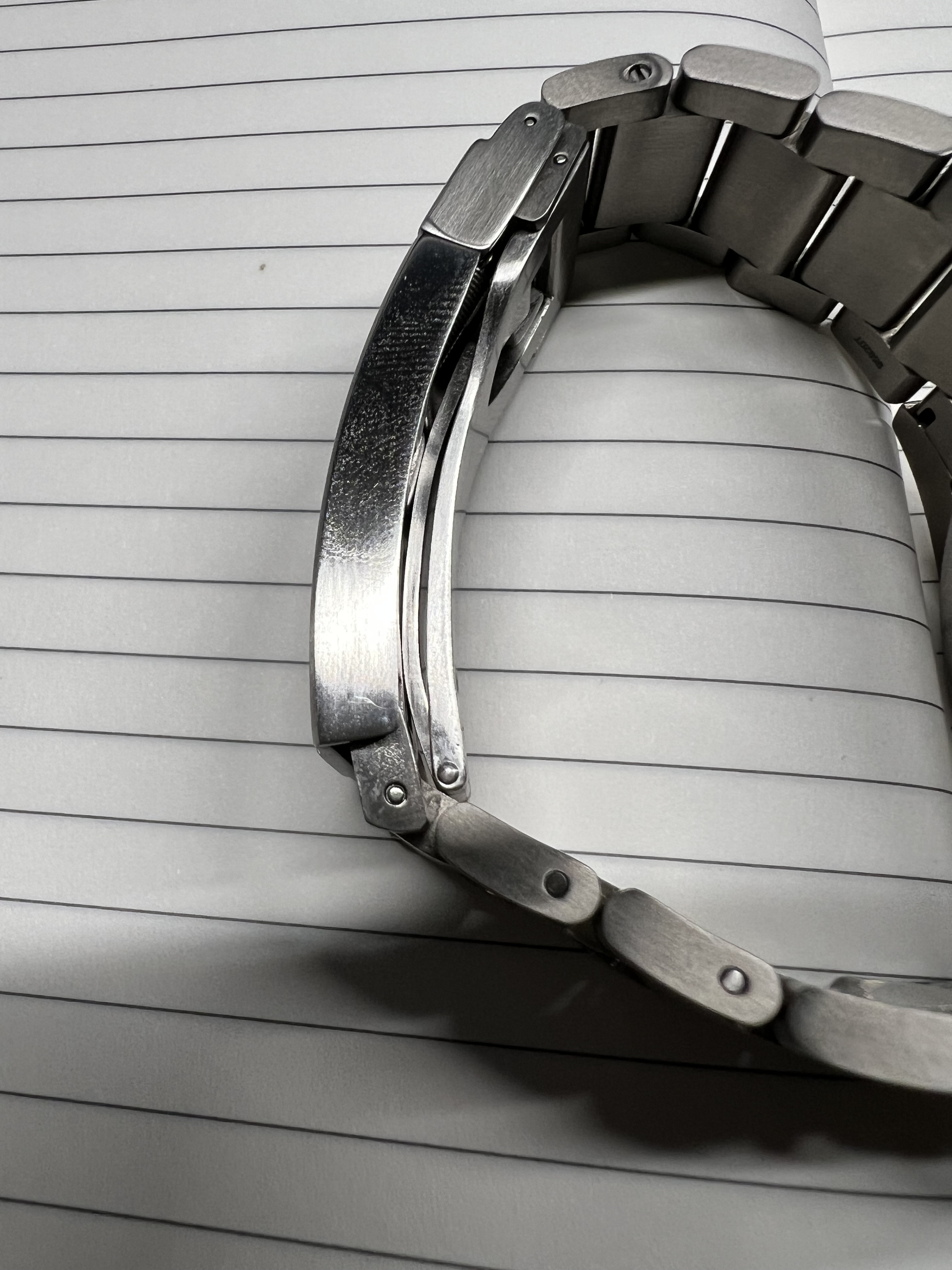

I have given up on the Titanium bracelet supplied with my XF Pelagos! It’s the Clasp!
Between the bulging at 12oclock issue and the inability to get the perfect fit, I have grown to hate this ridiculous thing.

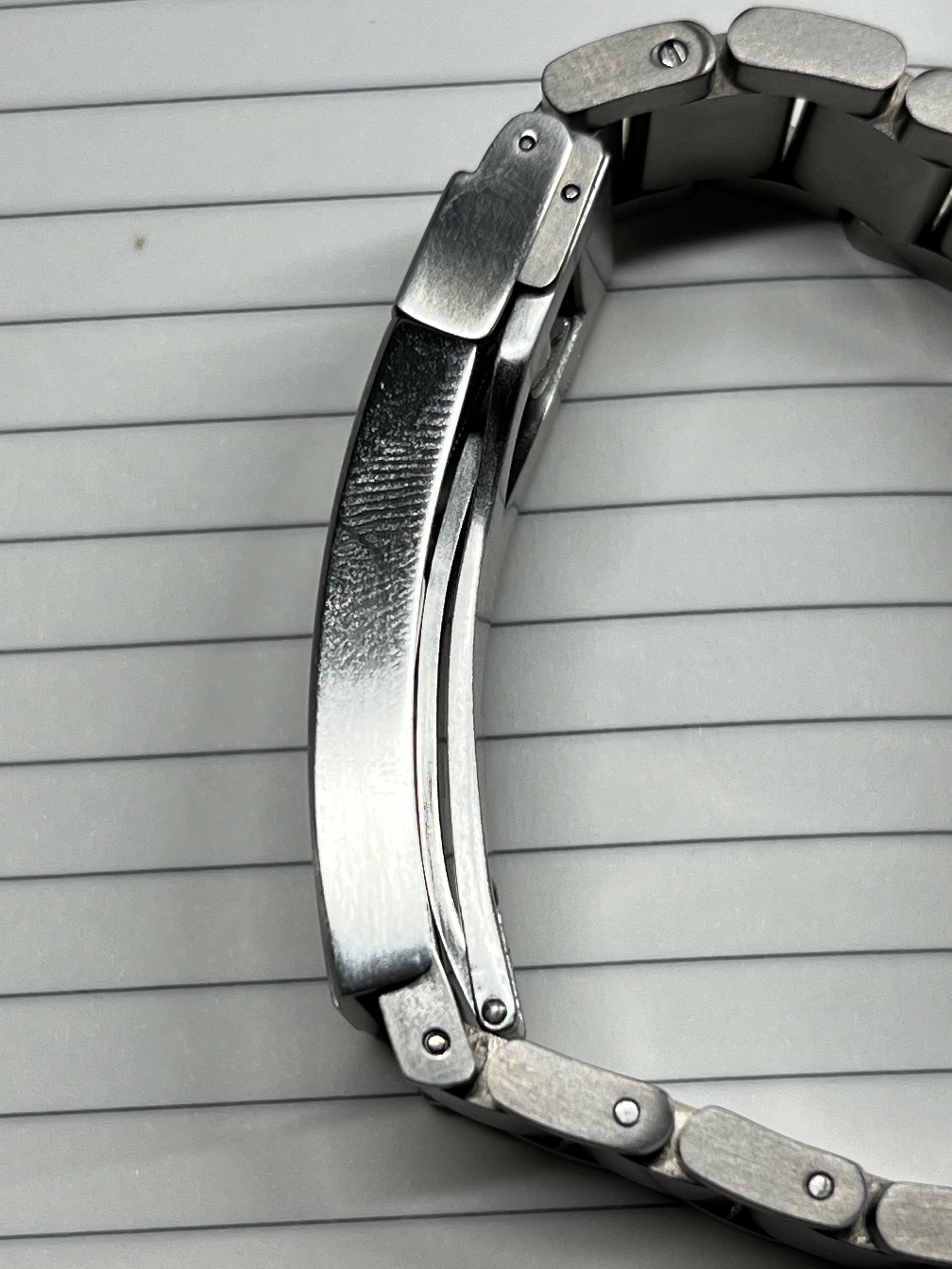

The issue is not the links or half-links. It is the clasps design.
The correctly folded inner parts of the clasp do not nest cleanly and securely into the outer shell.
There is no way to prevent the parts from flexing in and out and causing an annoying gap at the 12 side when on the wrist.
The inner arms on the bracelets of my gen Rolexes all sort of snap into the outer “shell” of the clasps. This feelscso much more secure and looks better as well.

^^^ Photos show the gap. It can vary a bit with wrist position. There is nothing securing the clasp "shell" at the 12 o'clock side. :(

I have the same issue on my Pelagos 42mm. The clasp sticks out when closed. I love the watch but the clasp doesn't sit flush with the bracelet. The pictures above is exactly what I see on mine. Its like the "folding t-bar" is too much on a curve/bent to sit inside the clasp.
So in good news, I was able to bend the arms of the folding class ever so gently and it looks to sit about 2 to 3 mm closer now. Definitely took a risk doing that but it worked out OK. It looks like the titanium is malleable, I only use my thumbs and pressed with support of the clasp. I’ll take some pictures later and post when I’m back in front of the watch.
I did the same thing except I took the clasp off and used the edge of the counter to bend the arms of the folding arms it just a little bit, taking out the slight curve. Try that but don't bend too far or the clasp lock will be hard to open. Mine still lifts a little but a lot better now.
