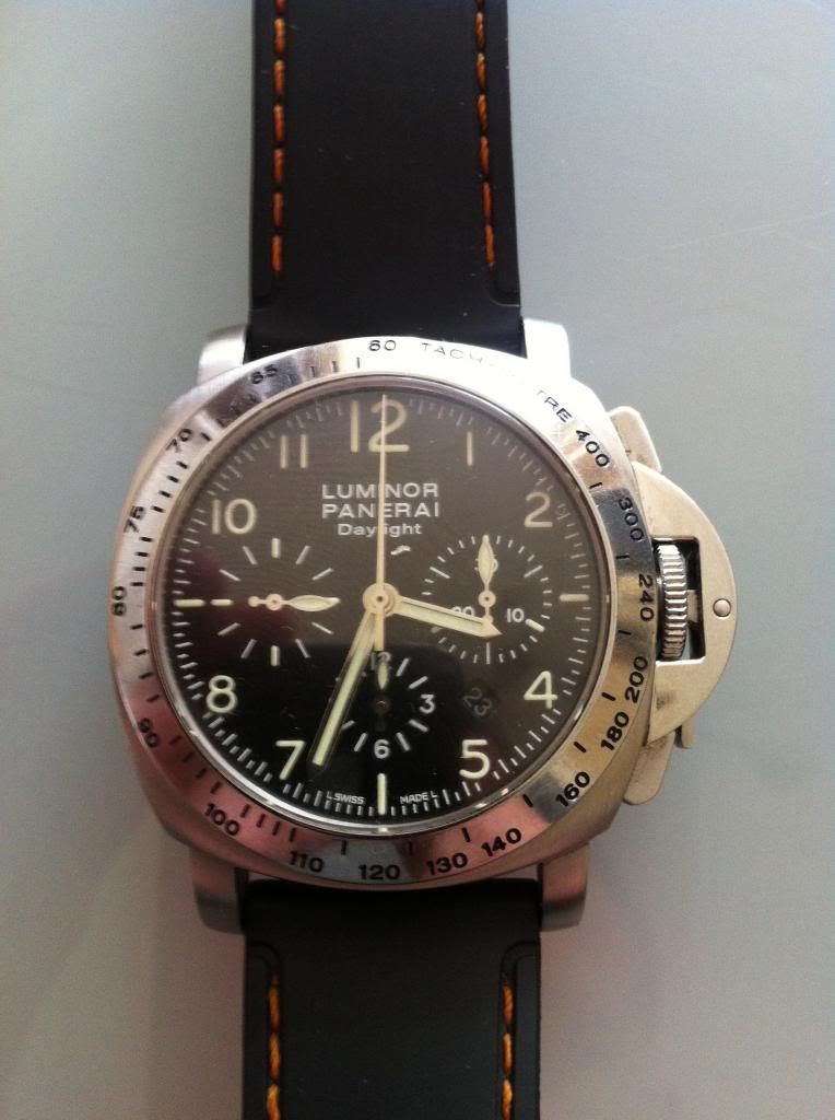

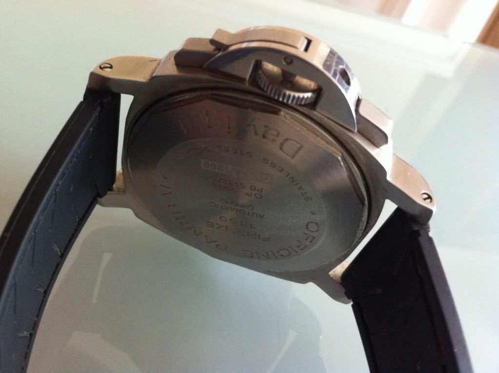

Hi,
I am new to the forum and didn't realise there was such an interest in good quality replica's.
I have a Panerai that I have had for a few years now that has a broken stem that has snapped off inside the crown leaving none sticking out to enable its removal and fittment of a new stem. I have been told by Ryte Time watch repairs (found on the net) that he can not get a new crown so it can not be repaired :facepalm:
I am really hoping that someone on here can direct me to someone who might be able to help, as I love this watch and it would be such a waste to just bin it !
Apart from the broken stem the watch is functioning as normal.
Couple of pics of watch for reference.
Thanks in anticipation of some good news?

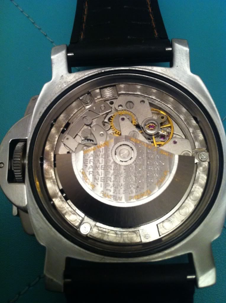

No, this is a 7750 movement so Jackson probably doesn't sell them.
You can buy a new stem from ebay or any number of internet sellers. They are pretty cheap.
Finding another crown might be some issue. So it might be easier to try dissolving the remaining part of the stem in the crown.

Can you take it appart? I have a junk pam that i was trying to get rid of and if the stem will work i will take it apart and give it to you. Can you take pics and measurements. Thanks!
that is a Great gesture.. clap clap .. but you hv to check that it a 7750 movement ..

Hi, thanks for your generous offer. I will get back taken off and post some pictures here as I don't know what the said movement looks like compared to any others!!
Chris6210
9/5/13
Hi, I hope this image helps ???
Chris6210
9/5/13
Ok I have taken the watch movement out with help of YouTube video.
How do I find out thread size of stem I have removed ? I am going to try the dissolve method with the crown and see how I get on.
If I can get correct stem and can clear breakage of stem in the crown I will be sorted !!!
