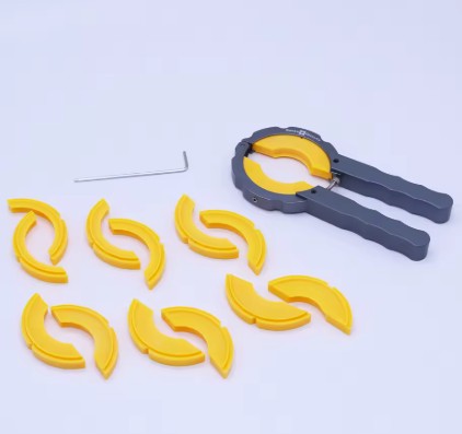

do you know if tool will work for that job ?

I have never removed a bezel from that particular model or manufacturer- but there is no reason that that tool should not do the job- it is effective. I do not believe these models have a ball and spring click system like the Rolex subs- but like anything when fiddling with watches- be very mindful of stuff flying off into the ether- perhaps do it in a large plastic bag.
You MIGHT need a crystal press to get the bezel back on. IF so- you need to remove the bezel inset first before reinserting to avoid cracking the ceramic.
many of these have a thin washer that needs a little increased bend in it to help increase tension on the bezel. There are many threads about this- the best way to search RWI for me is not the search box above- but google. simply type in your query followed by "site:replica-watch.info" (no quotes).
I hope this helps

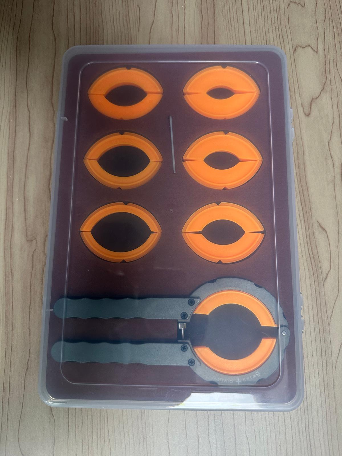

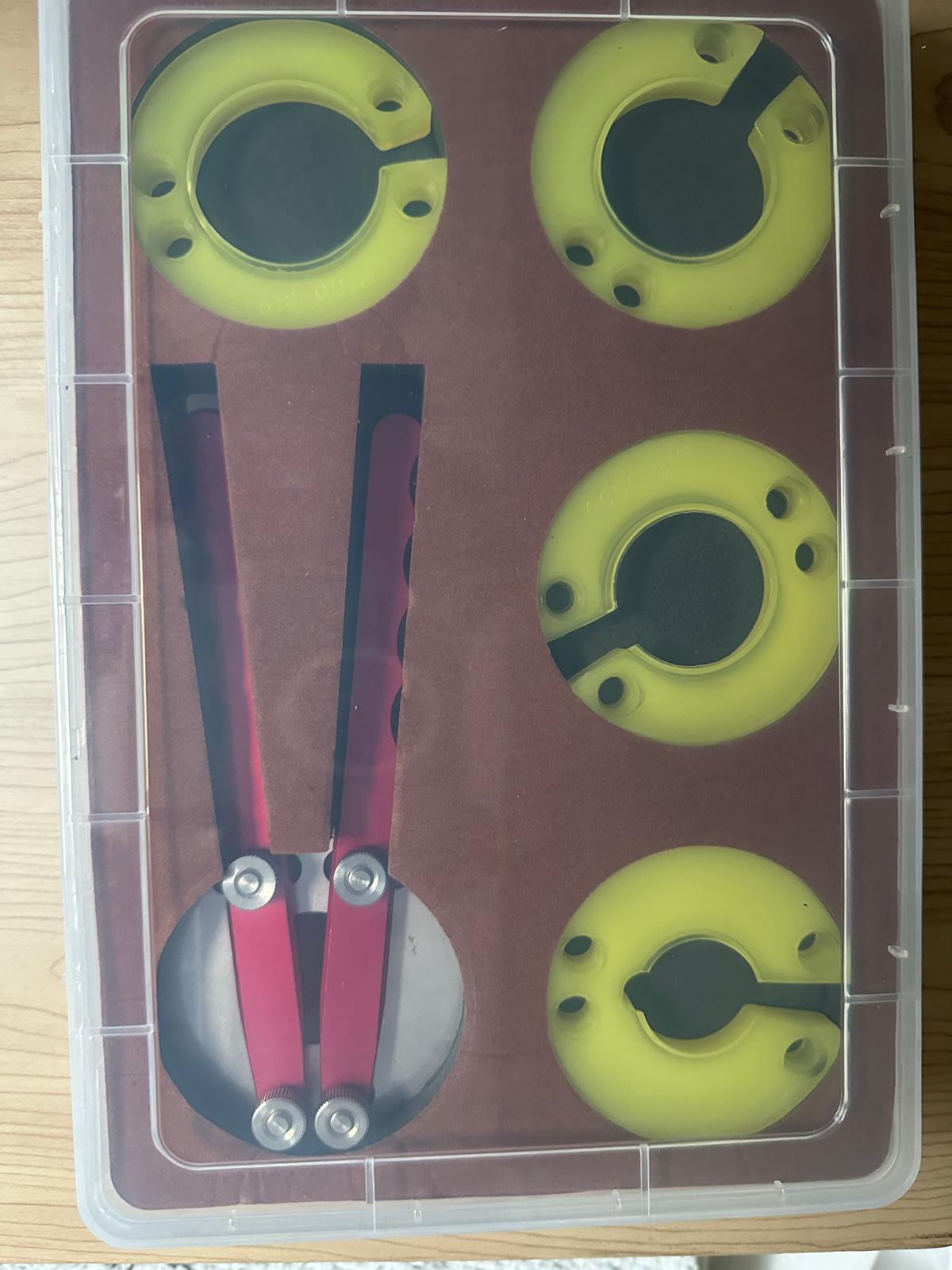

again massive thanks, I managed to remove this bezel, thanks to the videos you sent from YouTube. I bought 2 types of devices for this on Ali. I definitely recommend this red one. This gray one can be thrown in the trash. This red one did the trick right away.
