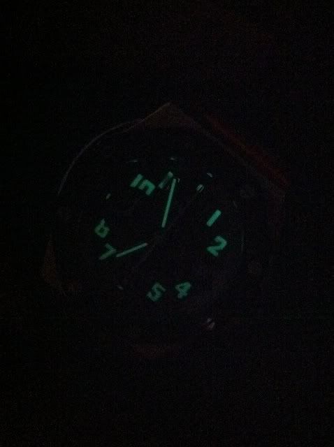

I got a little excited after ordering my Volcano and decided to buy another piece.
I picked this up from a user on another forum and had a question about the movement. Is it just me or does the seconds at 12 look a little jumpy for a serviced movement? Just click on the pic to play the video (sorry about the background noise, forgot to turn off the TV).
On another note, the lume looks great!

LOL yeah, those do look rather jumpy for a serviced watch. Did you get any proof (receipt of any sort) of a service being carried out?

There is definitely an issue with that movement, sorry to say that.
In the first moment I even thought that was quartz.

should send it to domi for a service a jewel fix that will sort it out :)

I figured as much, even though I am a rookie I did a ton of research about these things and kind of knew that was off. But as always it's good to get a second opinion.
I took the person at their word it was serviced by Francisco so I will shoot him a message about it. I've read Francisco's forum and saw his video from the movement fix and this looked like the before video...

Sorry mate but you watch has the sec@12 syndrom :) so you have to send it to a modder for modification ....
