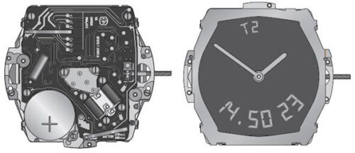

Thank you a lot for the link!
Curious that the display of those 988.431 are square, while my display is round.
But on my movement is a print: "988.431"
While all movements with round display I have found so far, show the number "988.432"

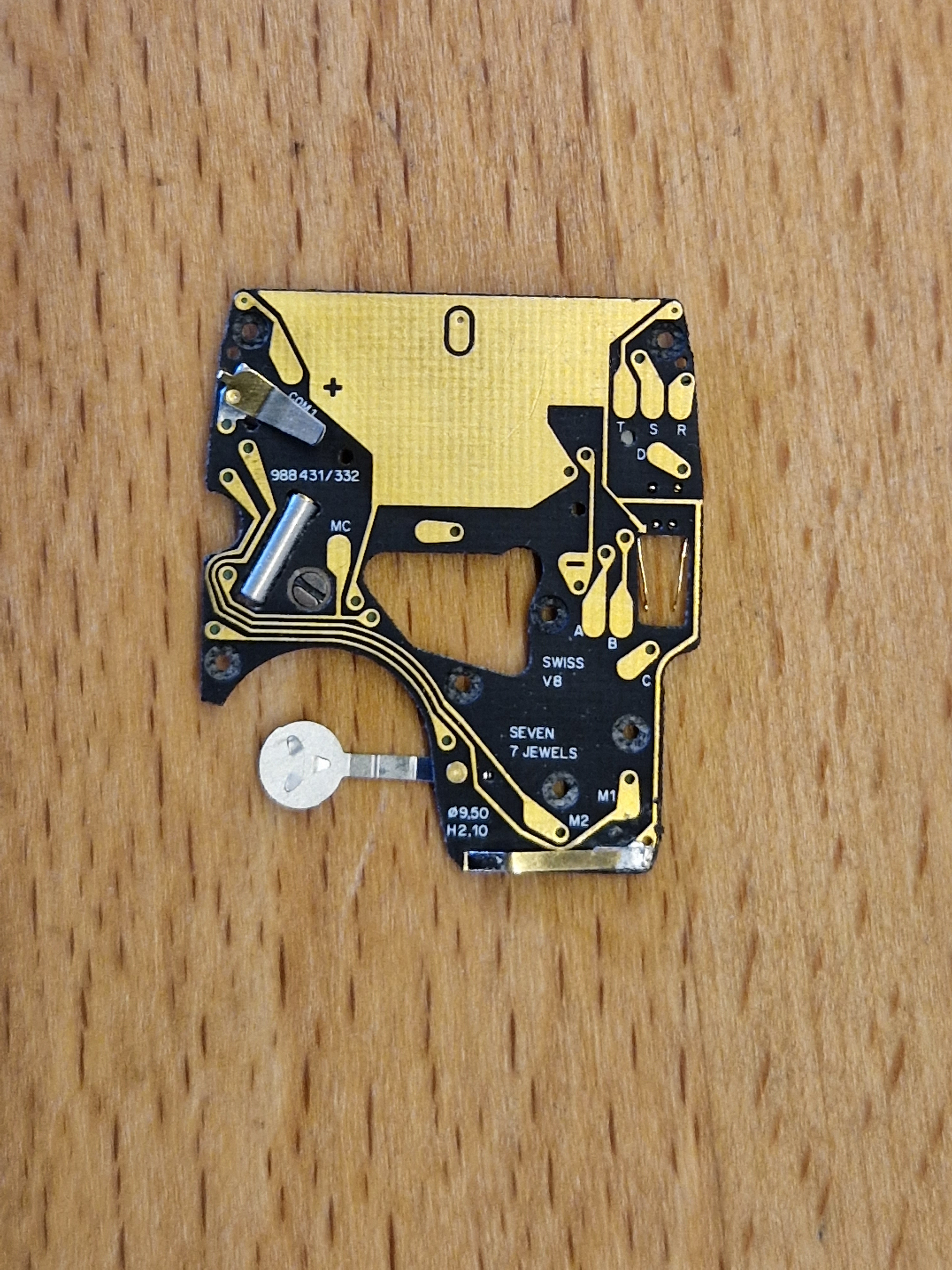

It turned out that the number 988.431 refers to the ETA movement beneath the Electronic circuit. 988.431 is the round display while 988.332 is the square display. The Electronic board seems to fit both versions. Therefore both numbers are printed on the circuit.
I sourced the electronic board only and changed it on my watch.
The old circuit was broken. After installing the new circuit board, the watch came back to life!!! :)
