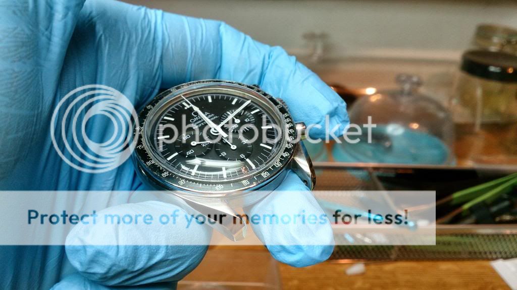

All parts in line!
During the installation Matej noticed the problem with the lemania 1873 and i decided to switch to the 861 movement instead... Here is the baby!
This gear needed a little cleaning
Dial and hands installed
Checking the lume
A check at the back
Into the case they go
Regulating the movement
Antimagnetic cover on
Caseback
An attempt to paint it. The engraving was shallow though, and got even more shallow after the polishing and brushing.
Well kind of expected result but it suits the whole vintage look!
Almost there!
Plexi was polished also. Too many scratches all those years...
Glowing!!!!!
And here is a couple of shots i took, in the next days i will post some more with the bracelet on. I having a hard time fitting the 633 links and i don't know why they wont fit... If anyone has a tip for me please contact me!
I hope you enjoyed the thread, because i had a great time building it. Although you all know how much i love franken projects, be really careful if you decide to build one like this, estimate the cost before buying the parts, you can go close and even more the price of a gen and it will be too late when you understand it... I have to admit i was very lucky not making a bad invest with this project, so be sure you will find the parts in very low prices else it doesn't worth the trouble...
See you in the next project!!!
