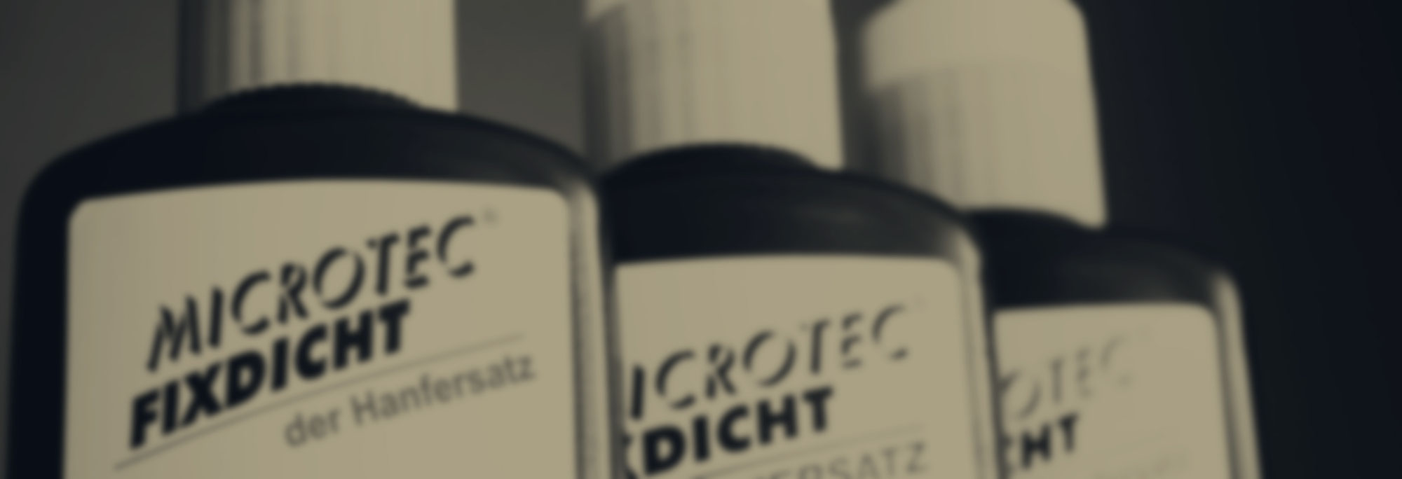

Expocid resin is really heavy. I sealed my 300 with a liquid seal from Microtec. Remove the movement, unscrew the helium valve, apply the "fixdicht" and screw the valve back in. The watch passed the water test at 50 meters, The advantage is, you can always put it back.
(I used the TEC-500)

Here is an example from practice:
two VSF Seamaster 300 checked to 6Bar.
Both models show no bubbles and are therefore waterproof. The helium valves were treated with the above mentioned agent. The watches are therefore suitable for splashing, showering or the summer rain walk.
