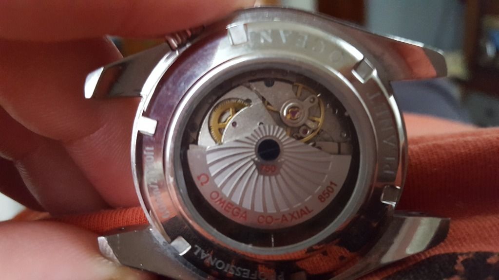

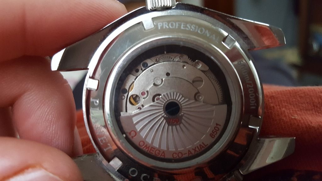

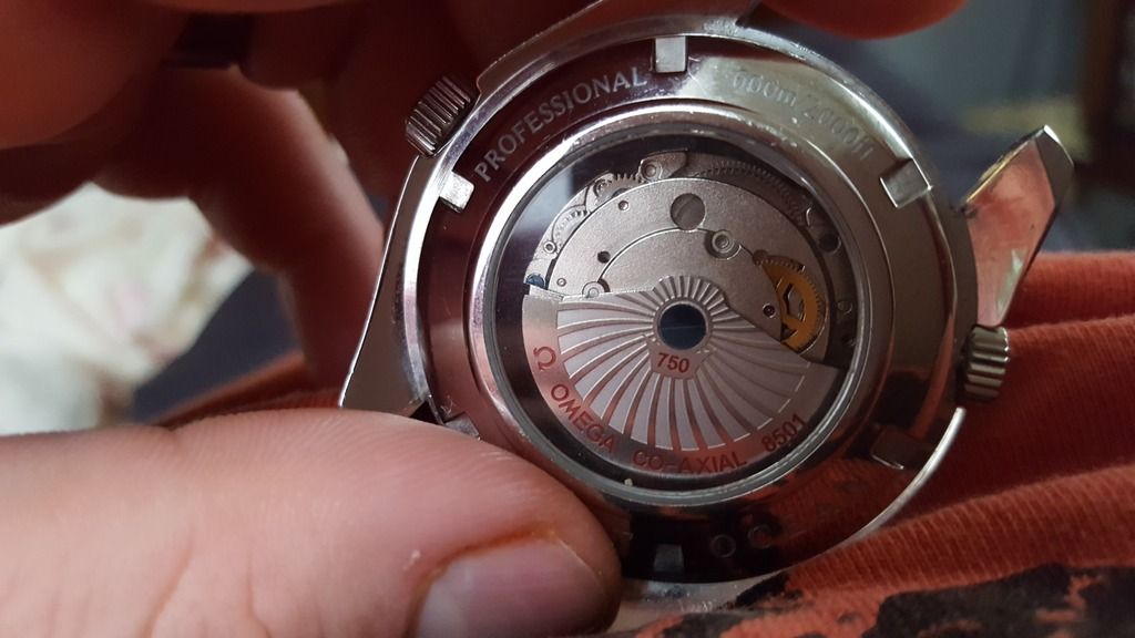

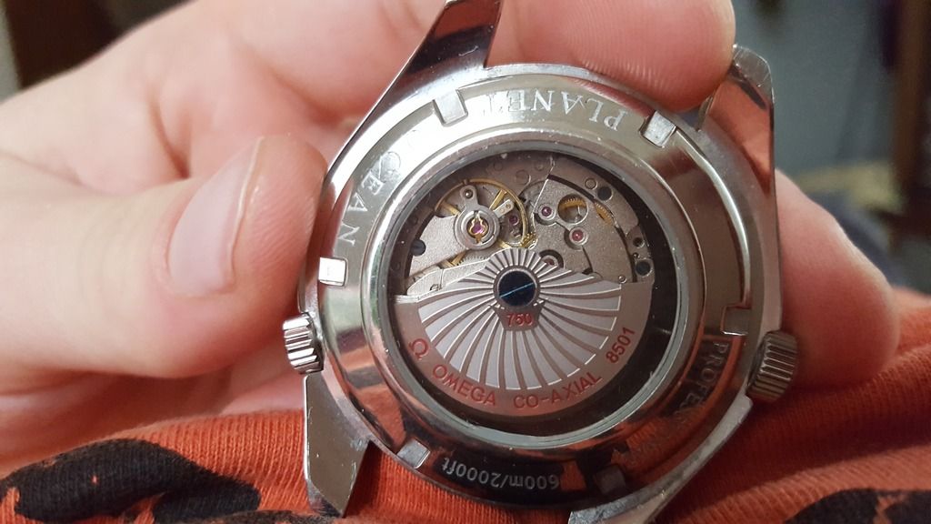

Hey all, I recently recieved this Omega Skyfall open caseback, everything but the handset....I have been looking to source the appropriate broad arrow hand set, but have been having some difficulties. To be sure I am looking for the correct size hands, I wanted to check with the pro's as to what you believe the movement/handset would be. To my knowledge it looks like 21j, and was looking for a 1.50/1.00/0.17 hand set. Does this seem correct to those more experienced??
Thanks for any assistance! Any info on where to source the hands as well would be much appreciated! Below I have some shots of the movement!

Yes, it's a 21 j. DG2813 or a variant. Hand sizes are hour 1.50, minute 1.0, and sweep second .17 mm
