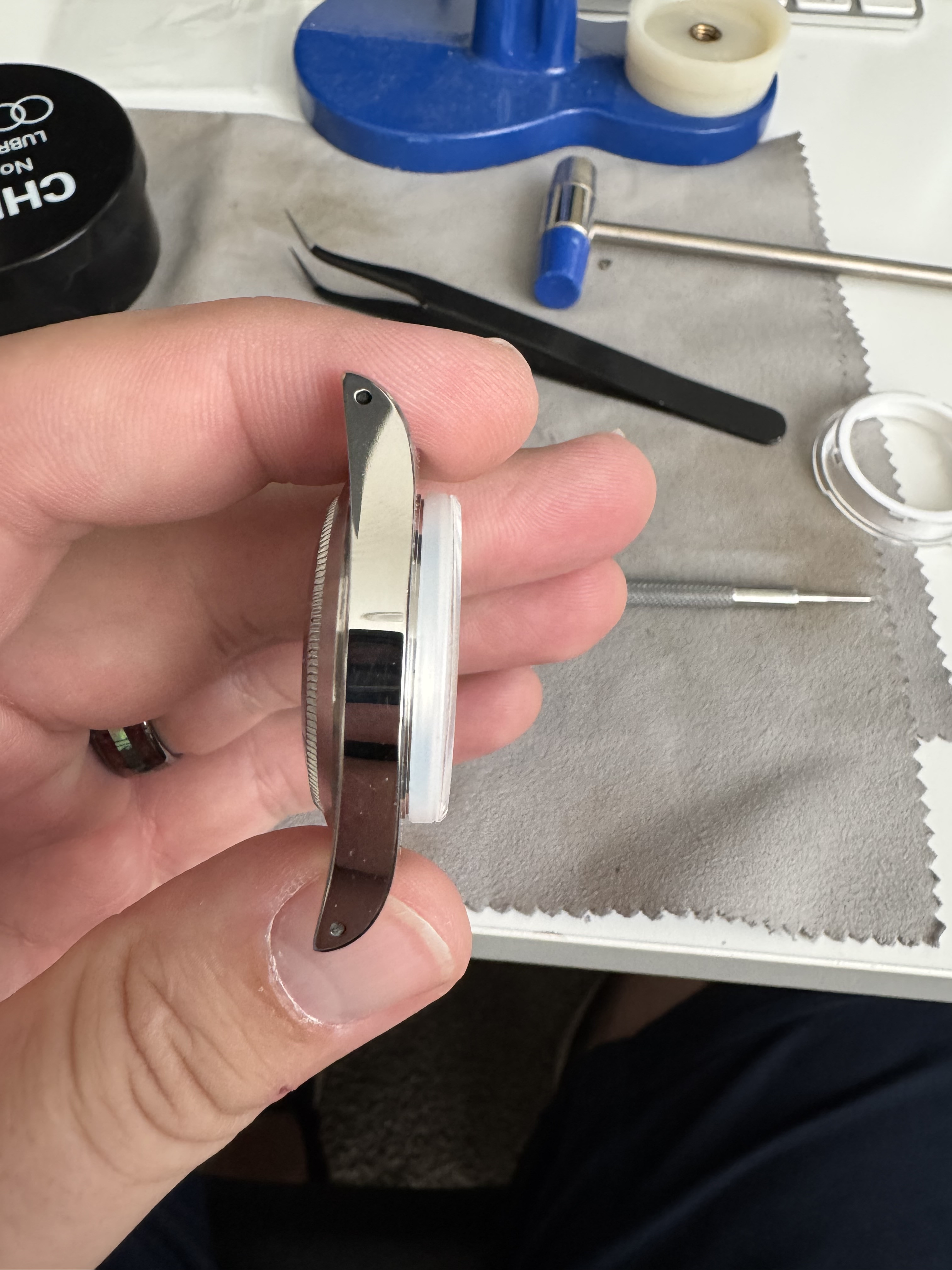

The link you posted does indeed show a 1675 (BP) case, which would also be accurate for a 16750 as that case did not change from the 1675. However the BP 1675 case is not very accurate to gen. The BP side profile does not have the right curves and the CGs are crazy skinny. The BP acrylic crystal is correct for a 16750, however the rivet bracelet is not. The 16750 was only offered with oyster or jubilee. The BP dial coronet is wrong (affectionately known as "frogfoot" due to the outer spires being shorter) - this type of coronet never appeared on a gen GMT dial.
Your mention of this model being available with a 3186 is the first I've heard of it but if Ryan says so I would believe him. BP does make a 16710 case with a 3186 movement, you might want to verify that the case will stay the same. The 3186 has the hour hand on the bottom, which is correct for a 16750. As pictured in the link, that 16750 has the GMT hand on the bottom, which is not correct for model.

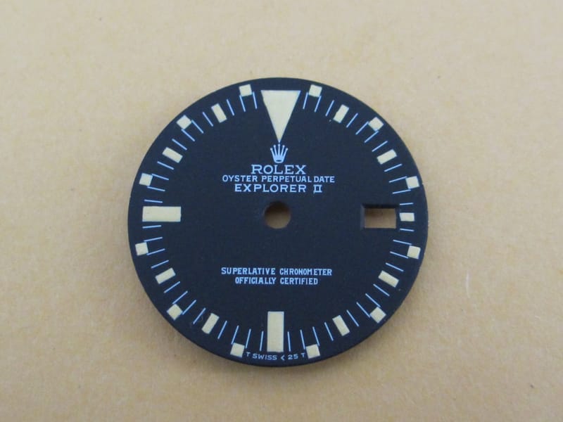

I am planning to swap the dial, I see members used Mochacha, any other suggestions?
Does anyone know if the 1675 and 16750 dials available in the market (diameter 27.3mm?) fit the BP case / A2836 movement well or any dimension issues?
Effectively I would have a BP 1675 case with A2836 movement, [Mochacha] dial, and blueberry bezel (fat font serifs version). How does it sound?

BP dials tend to be slightly larger than gen spec if memory serves correct.
Like most Rolex models there’s a touch of crossover with dials. The 1675 and 16750 shared the same case and dial for the first year or so.
You could do a mochacha or yuki 1675 dial if you want a painted style. You will have to either reposition the dial feet or just adhere the dial to the movement.

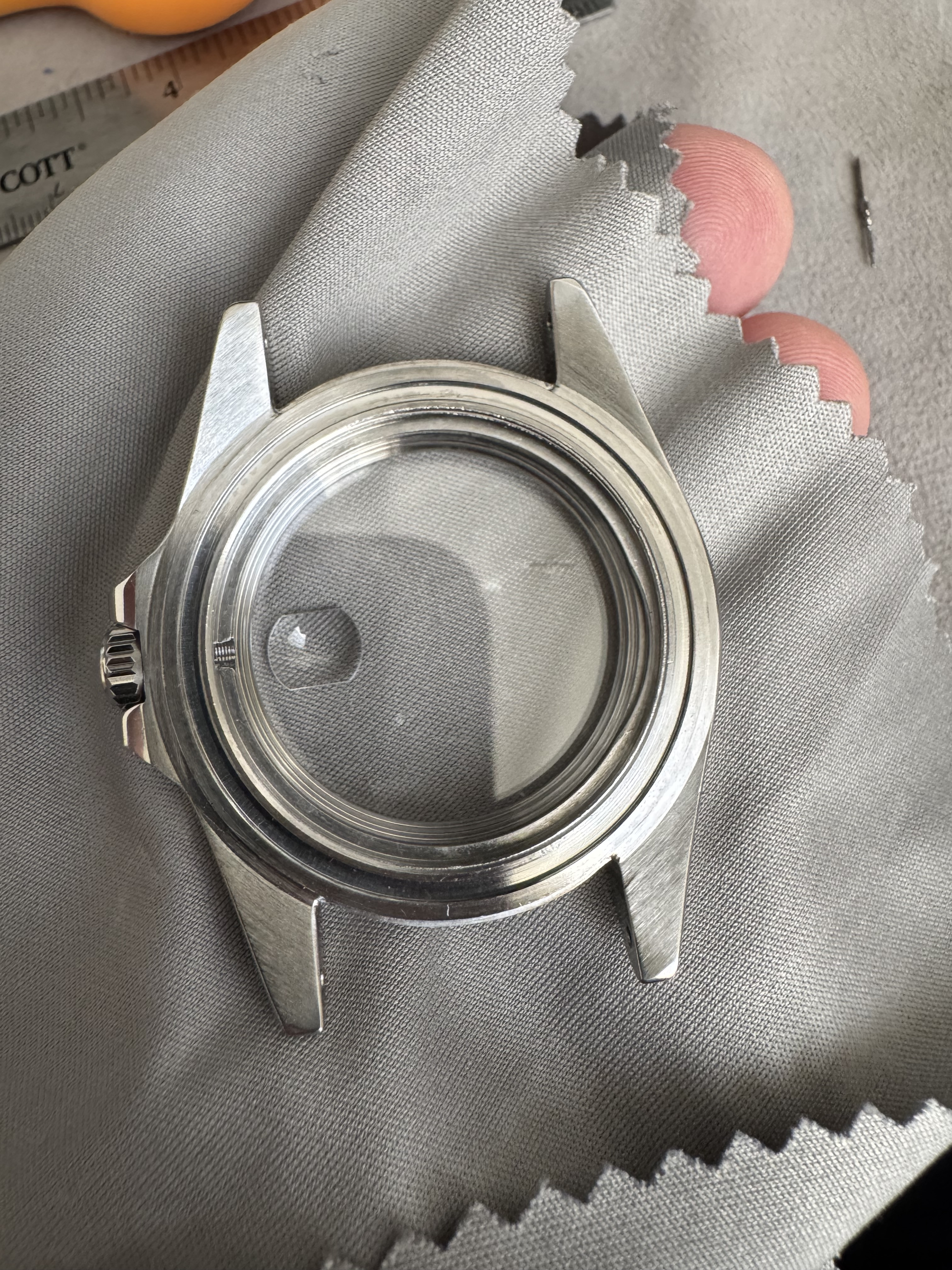

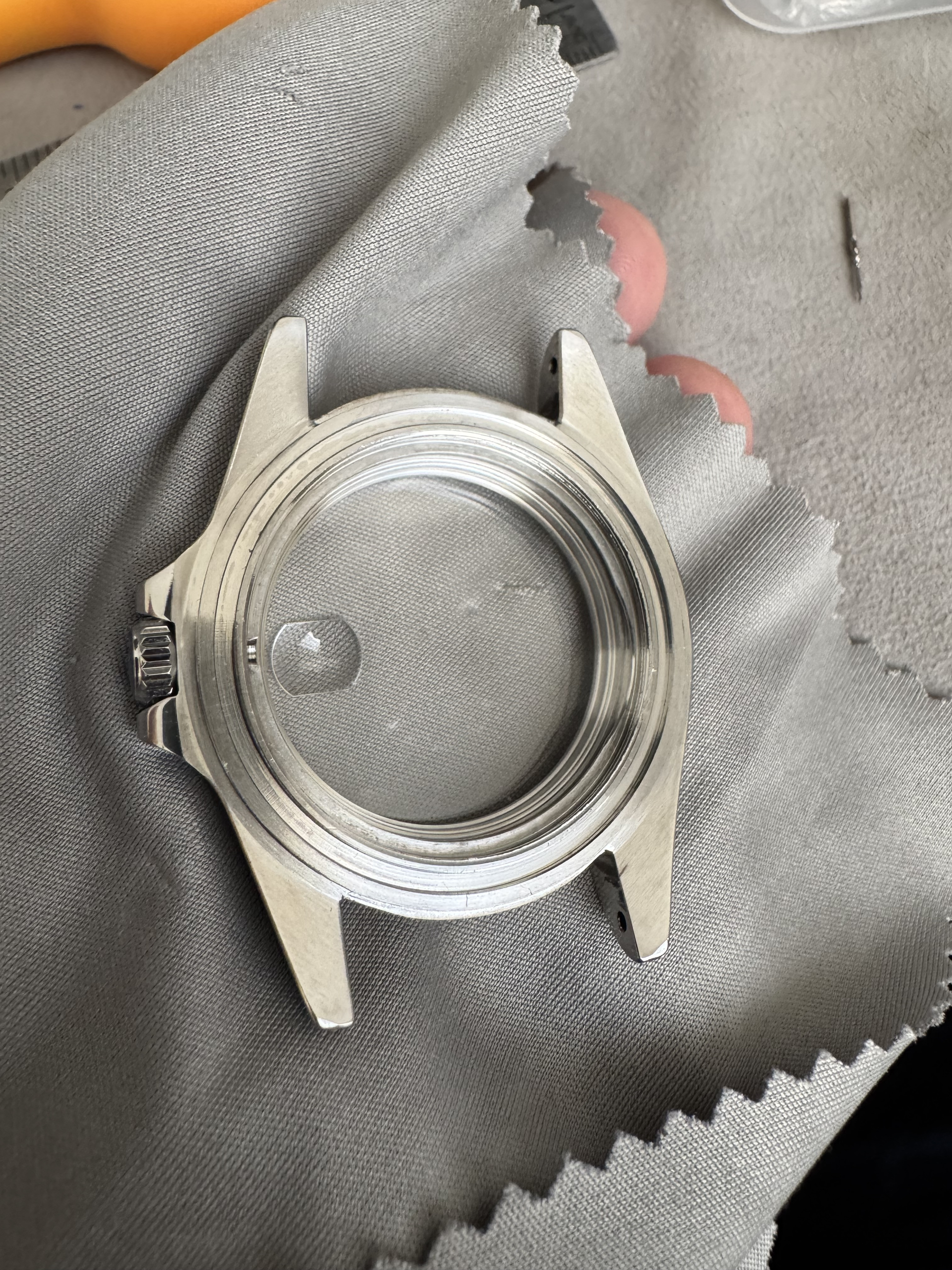

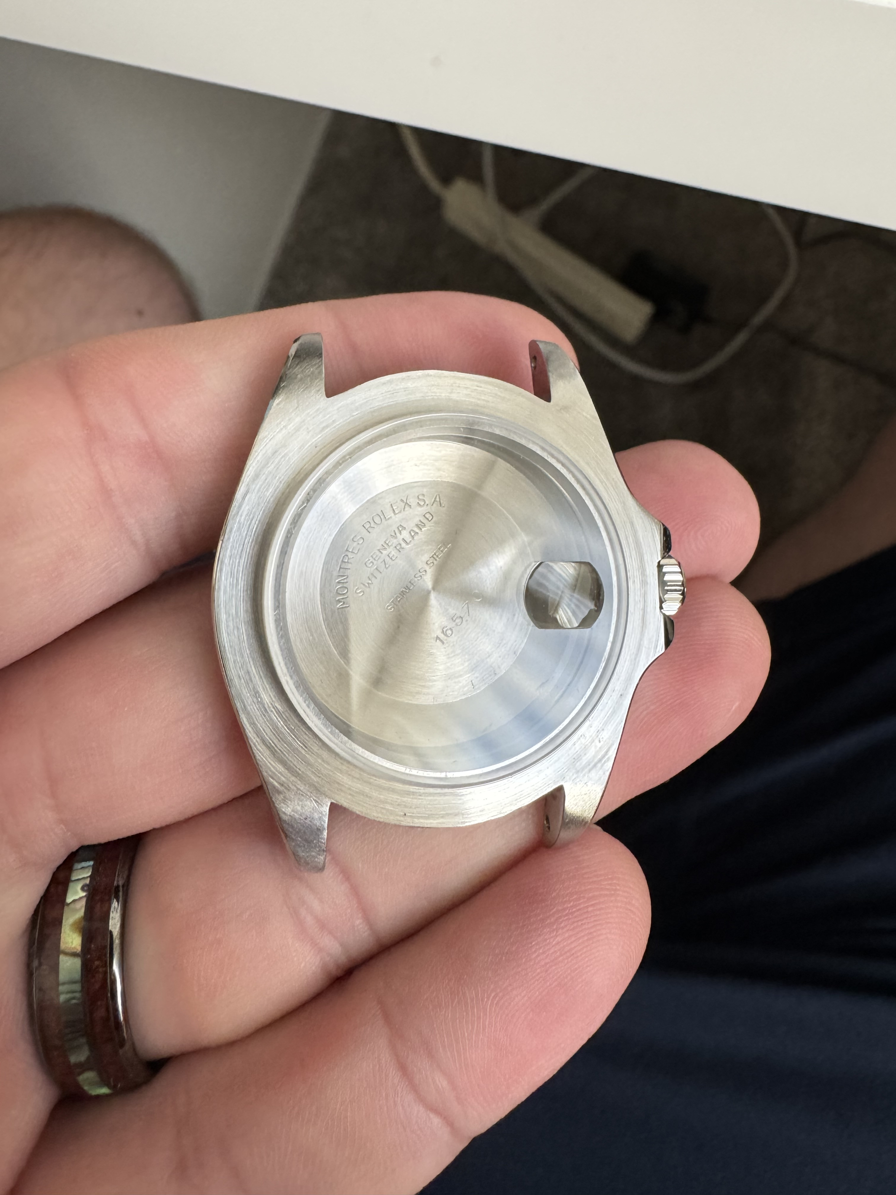

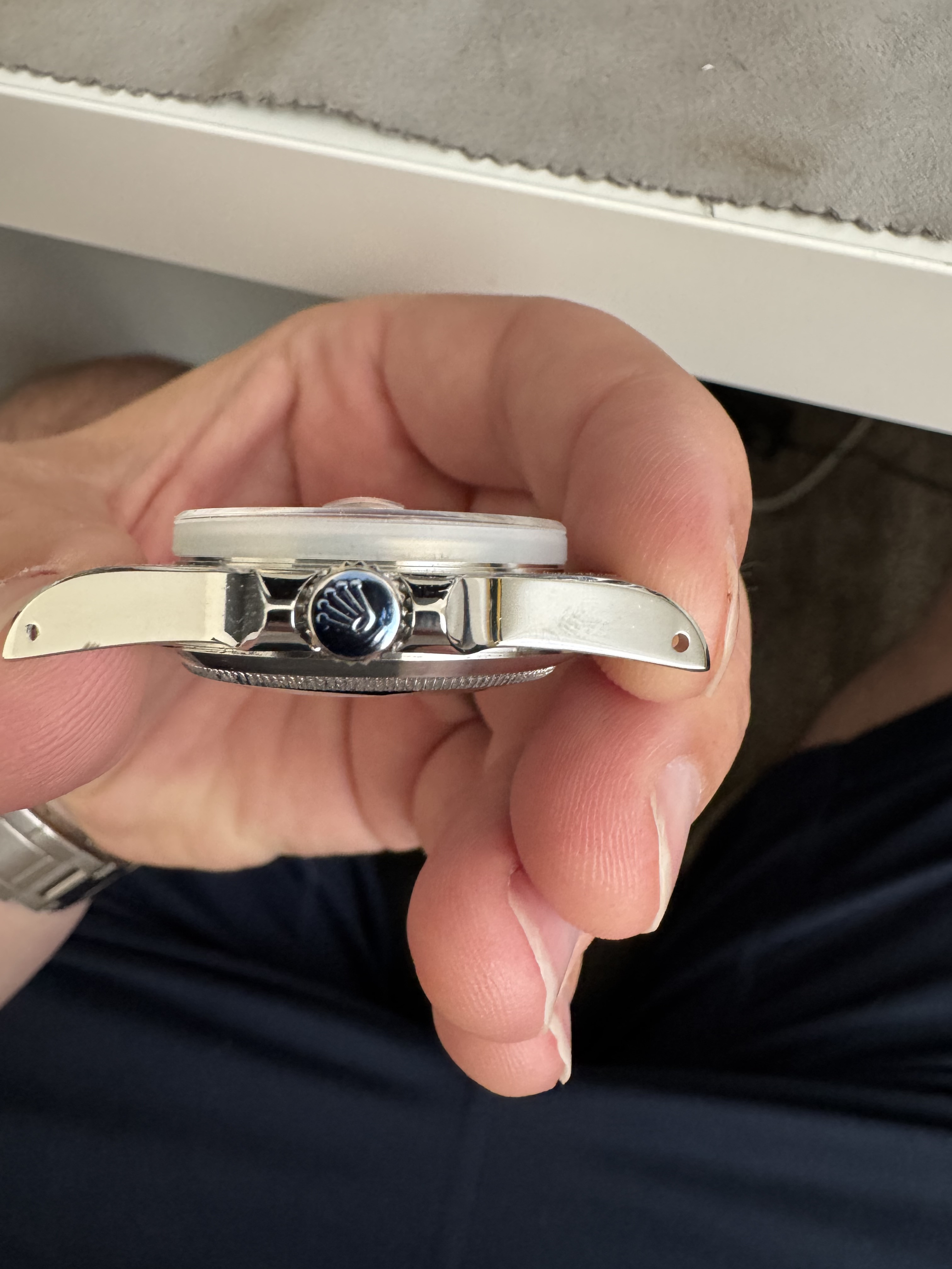

Great idea. I was thinking the same thing. Maybe with a 3186 with the DW switched to open 6 & 9.
Oh for sure open 6/9

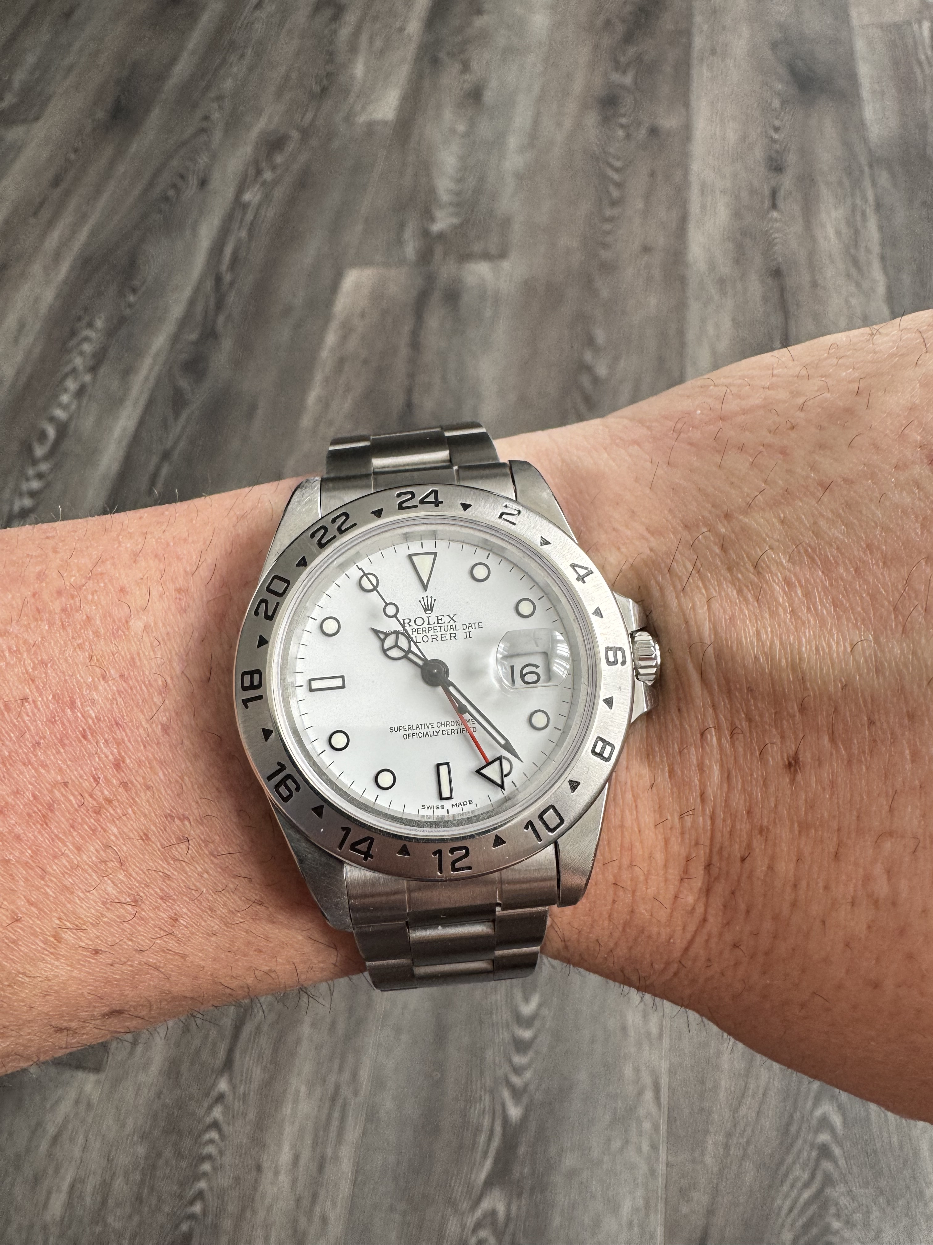

It’s on the list of projects. I’m working on a 16700 and 16710 currently. After just finishing up my 16570 Explorer II
bowtiefanatc
2/11/12
1,295
1,423

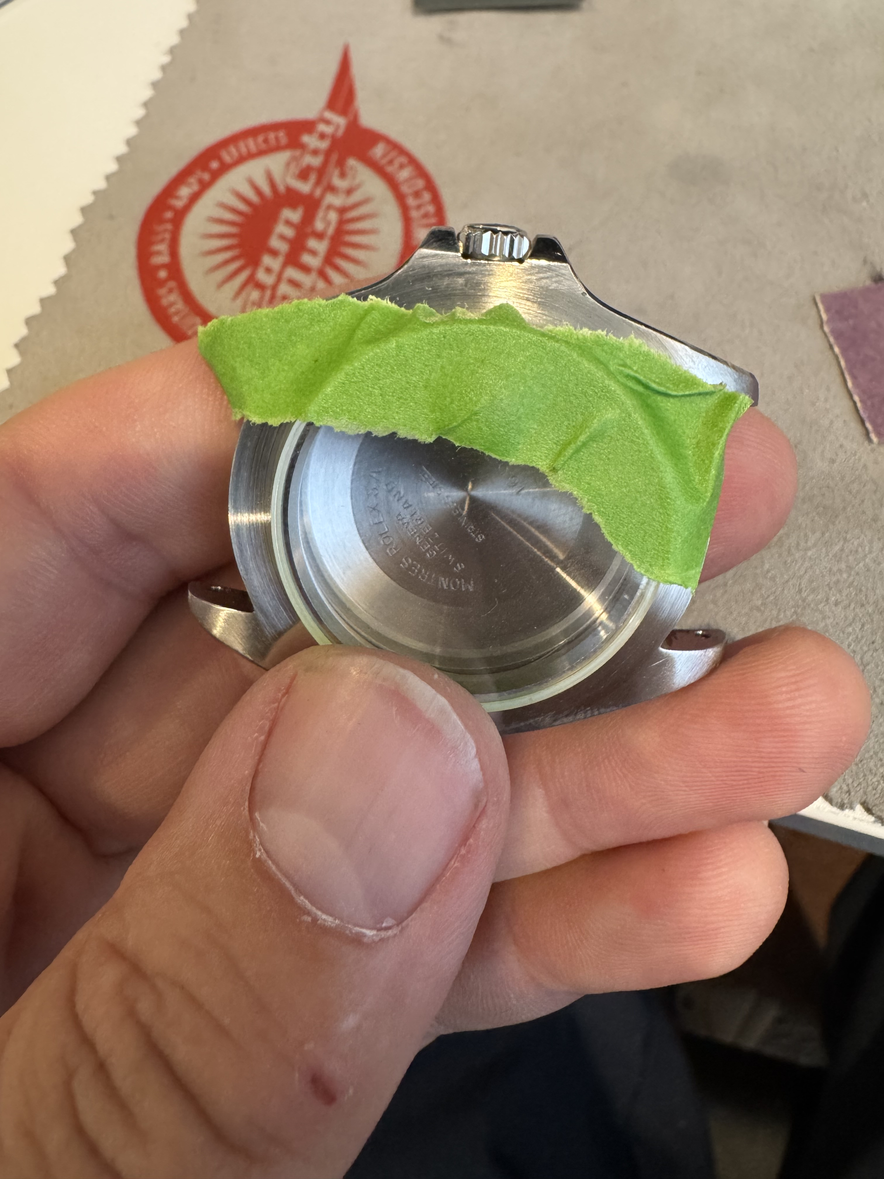

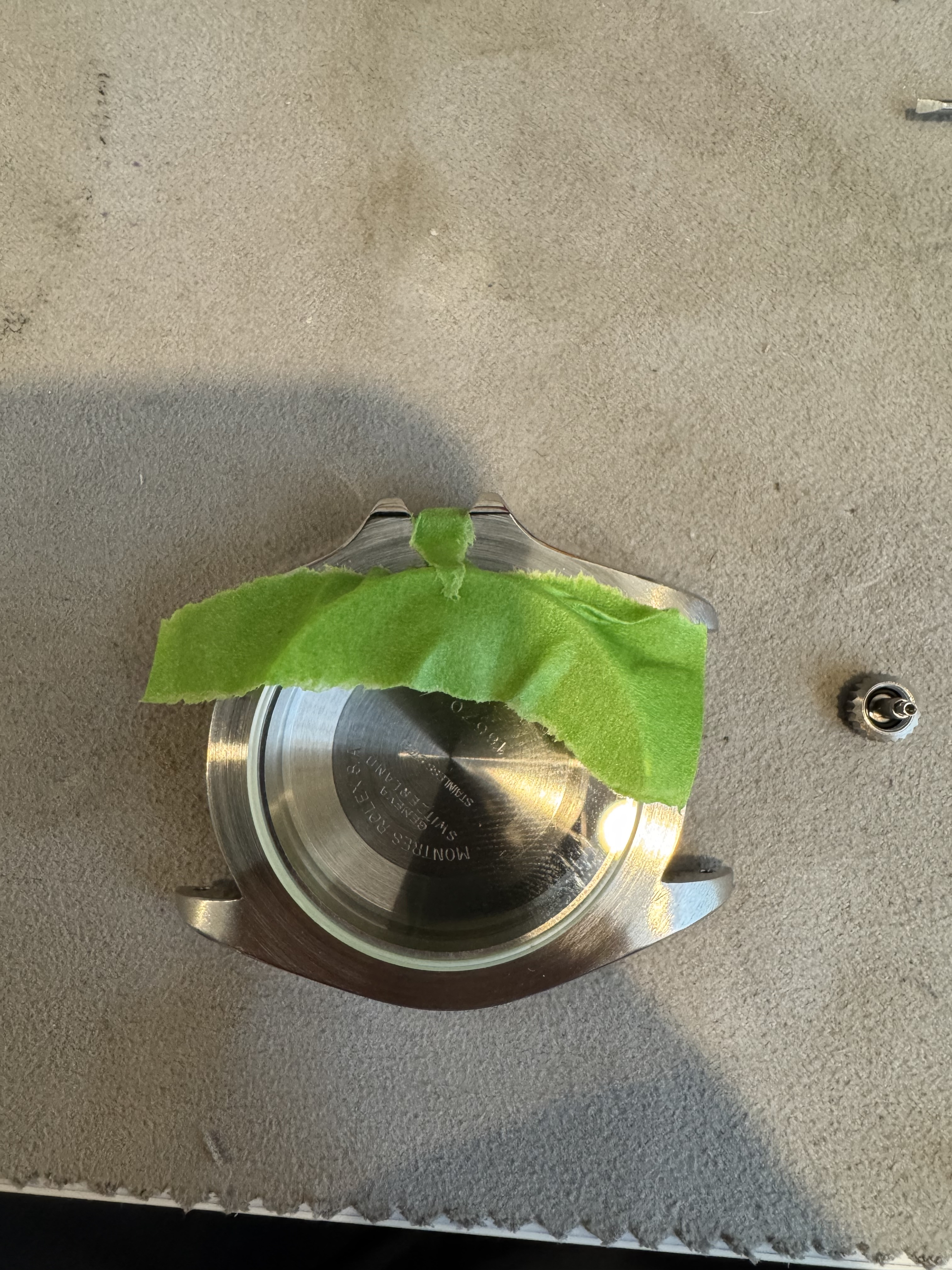

Is the 16570 case from BiVintage? If so, have you been happy with it?
Yeah, I got it from Bivintage. Quite happy with it. You do need to open the crown guards up ever so slightly. But being it’s the only option and it’s around 1/2 the price of some Viet cases. It’s a solid choice.
I decided to not use their bezel since I had a gen bezel which fit perfectly.
Reactions: Nur-Uhr
Nice job! Thank you for sending some pics. It looks great! I’ll get a case soon and get to work, I already have a gen 93250 bracelet.
