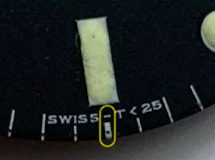

To me this is a fake because in the first pic the “SWISS - T < 25” marking at the bottom of the dial you can see that the minus is not centered with chapter ring.
In addition the lume job is a crime, who could been able to do a poor job like this on genuine dial ?

It's a genuine non-serif dial, but it's been very badly relumed, and possibly sprayed with a matte varnish to stabilise the paint surface - worth about 50% of an all original equivalent dial.
