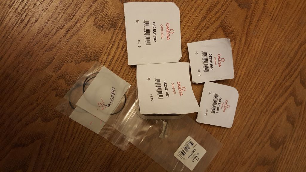

I regret not having taken the time to document the build from start to finish but I'll explain what's involved and what's needed: I just thought I'd share as I "finally" received the oem bezels and crystals to finish them right.

Original LMPO V3 - 285.00
Swiss SW200, H3 kit, freshly serviced by Tickleshoes - 215.00
V5 PO case set for case back - 60.00
Omega 088NS5139 case back gasket - 16.00
Omega 090ST1232 case tube - 28.00
Omega 069ST42184 crown - 38.00
Omega 086ST0115 helium escape valve assembly - 115.00
Omega 722250091440A08 date disc - 28.00
Omega 2230.50 non AC (Americas Cup) dial - 285.00
Omega 067PZ00010 Cal.1120 hands set - 85.00
Omega 082SU1702 bezel assembly - 345.00
Omega 062SB3065 sapphire crystal - 265.00
Omega 298ZW2981 crystal gasket - 16.00
Omega 026ST952 SEL's - 87.50 ea (two)
Omega 118ST1580 clasp attaching link - 68.00 ea (two)
Omega 117ST1580952 clasp - 165.00
Omega 068ST2207 spring bars - 9.00 ea (two)
Omega 068ST2208 springs bars - 9.00 ea (two) for rubber strap
__________________________________________________________________
TOTAL - no "too" bad :)
