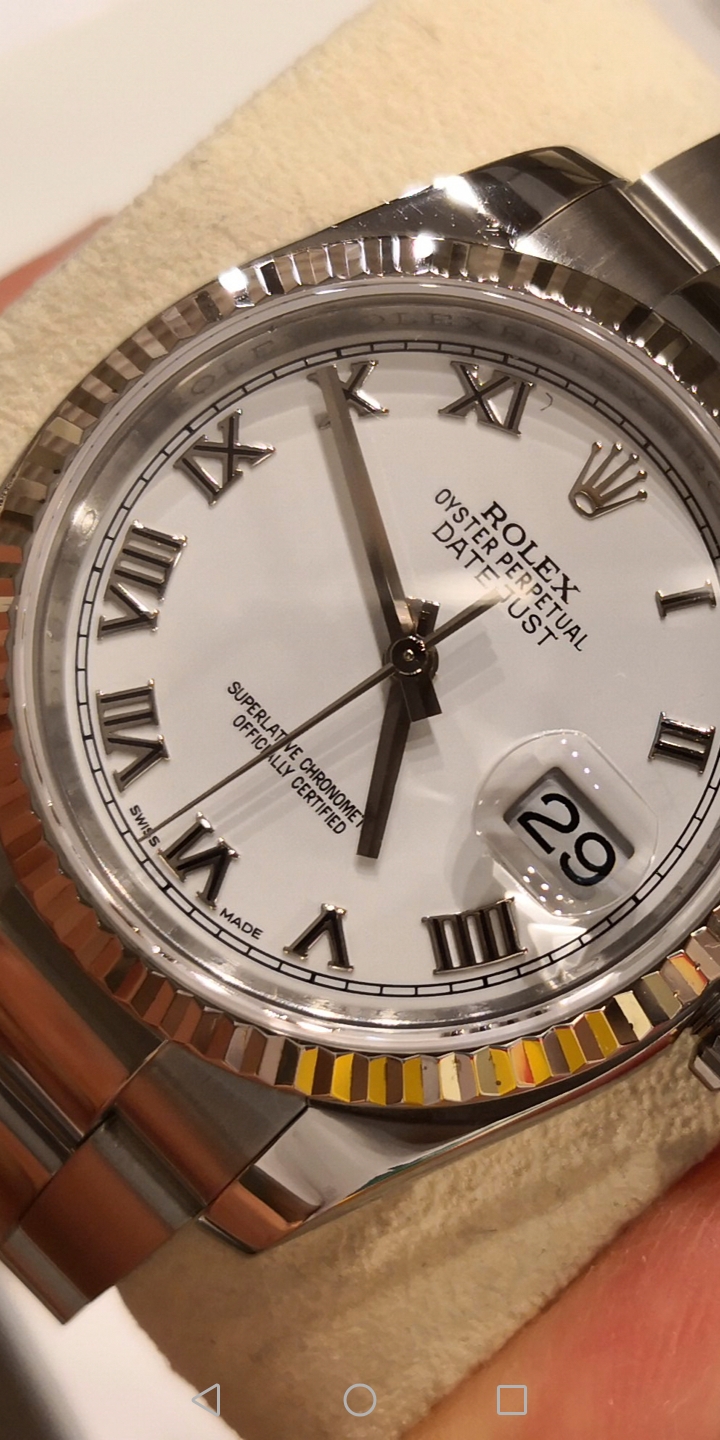

Thanks for the help guys ! KJ2020 Hinclimincli
​I tried pinching the pipe with a presto tool but using even moderate pressure didn't do the job. Using the old tube is actually a great ideea but I lost that.
So i ended up using a tiny tiny bit of glue on the tip of the pinion.

Nice one! I'm glad to see you sorted it out! Which glue did you use, by the way?

i used soething from loctite . Not home right now but i will let u know later. I made some tests before. It seems i'll be able to pull the hand out for future servicing .

Looks fabulous! You don't happen to have the rep minute hand from that watch do you? I've been trying to get one for a while now and every time my TD can't get BP to complete the deal. The WSO ones don't match and they sent me lumed hands twice even though I ordered non-lumed. Geez...
Really like that Roman numeral dial with the black accents in the hour markers. NIce work!

i have all hands and 2 dials. One silver one blue . I think i have 2 crystals as well . thanks again for the tips !
