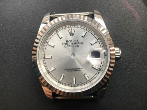

I've been bitten by the bug to build a watch of my own. I see Raffles mentioned a lot as a good place to start. Just to verify I have the correct site, is it:
https://rafflesdials.com/ ?
I'm looking at a SS Datejust to start, like the gen I used to own at the beginning of my days of collecting. Looking at this:
Along with the cheapest eBay/Ali/DH movement I can find, so the loss won't be too bad if I butcher something, lol. Maybe this:
So all I have to do is set the dial on the movement, press the hands on the dial, drop the movement in the case, screw on the back and attach the bracelet? Seems hard to screw up, even for me.
If it goes well, I've got a beater watch for a song. If it goes badly, I'm only out less than $200...I've spent more to be disappointed plenty of times on restaurant meals, concert tickets, and dates, lol.
Am I forgetting or missing anything?

Rafflesdials is OK, Rafflestime is better quality and used to have more choice, but I think his son has now taken over the business and doesn't want the risks associated with fake Rolex parts.
You need a DWO, which are called 'overlays' on RD's.
Make sure the case is for a 2836 movement if you're using a DG2813 - 2824 case will not work.

From what the site says, there are cases for the 2824, which do not work with a DWO, and some for the 2836, which does allow a DWO, but isn't offered in the model I want. After hearing horror stories of getting a DWO lined up correctly, I'm not sure I want to try one on my first build.
The Raffles Time site doesn't seem to offer any rep parts...at least not enough to build a watch from scratch.

You should look for a case which fits an 2824 and its DW without needing a DWO. Alligning that is really terrible work. I'm just doing that with a 36mm DJ and mickeymouse dial.
Beside that you should seal the gasket before assambling.

You mean like a butter knife? Got one!
Kidding, I have the basics...good screwdrivers, hand press tool, movement holder, case back tool, spring bar tool...I think that's all I should need, right?
tweezers and finger cots
some kind of magnification
a silicone mat or a mouse pad
a place to put the parts and a place to put the tools ( i got badly burned on my first as I was totally disorganised...when I put your watch head on the screwdrivers 😱)
and rodico, absolutely essential to align the hands. I did it the first time with tweezers, I almost died of stress 😭
if you have done a dial swap in the past, this should be a breeze
I'm pretty sure that's what I selected, unless I'm not seeing something.

and don't forget a good light source. I was shocked to see how small those things are. Youtube tutorials give you a bad sense of size 🫣
Like QC pics, where every flaw looks like King Kong, but the real watch arrives and only a fighter pilot or neurosurgeon can see it, lol.

Nice first build. That's a good model. I've only worked with the 15000, 1500, and the 15053. How did it end up working for you?
