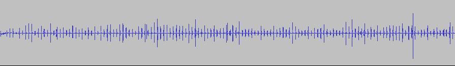

I use this software and it actually has an advantage over a standalone machine, because it can analyze recordings. That's something a standalone can't do.
When I get a watch in for service, I take a recording and file it away. I can use this for comparison after the work is done. I can send before and after screenshots to the customer so he can see the improvement. And since I retain everything on file, I can go back 6 months later and view it again if needed (for instance if there is a claim that the watch was sent running too fast or slow).
Another advantage with using recordings is that they show you the waveform of the movement. The waveform provides graphical display of volume variations between ticks, providing another dimension of analysis. No standalone machine, even Vibrograf, displays this. Standalone machines only tell you when a tick has occurred; they do not tell you the volume of the tick.
For those of you who wrench on cars, this would be akin to a timing gun that could also tell you the strength of the spark in volts. It would be way more useful than just knowing when the plugs fire. You could use it to detect other underlying issues.

No, nothing as complex as that. Sorry for the confusion. I use Audacity (free) to make my recordings. It is via this software that I can see graphical display of the audio signature. Nothing fancy.
The point is that eTimer can analyze recordings, whereas a standalone cannot (or at least should not, due to possible pickup anomalies, but I'm sure a creative person can rig something up). And because you are already taking recordings for analysis, you can observe the audio signature.
Here's an example, an A7750 that initially looked good on the timer. The graphical display indicated erratic tick volumes:
