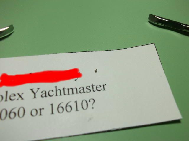

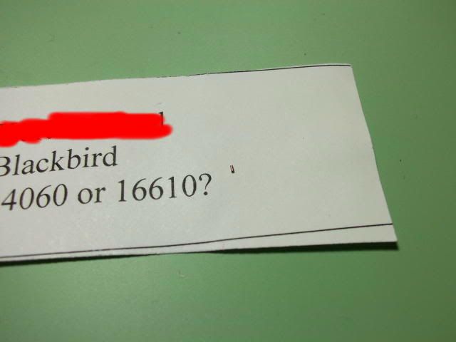

No worries, just wanted to point out that it does happen. I had 2 last night in fact where the hand tubes ripped out of the hands. The rep hands tend to be poorly formed, and furthermore their fitment to their respective posts is usually either very loose or way too tight. When it's too tight, the post gets left behind and is difficult to remove. I've even seen the assemblers glue or epoxy the hand in place when it doesn't fit properly.
Here are some of the service pics from last night. This happens all the time.
