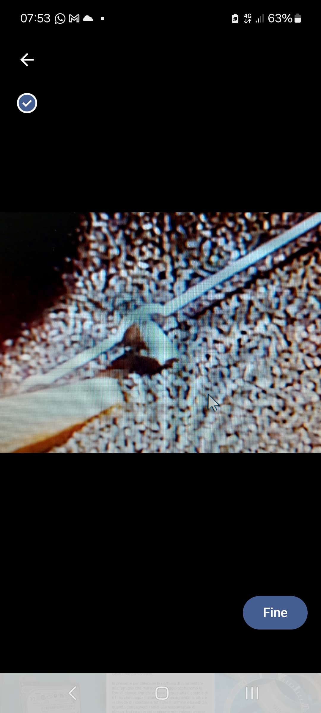

broached slightly what's mean? i have seen that the second hand has a long stem
