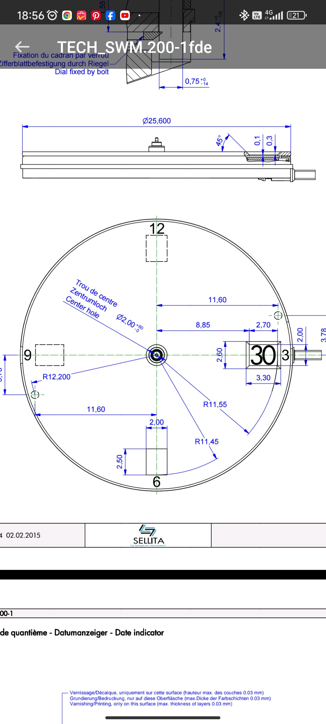

Manage to find a thread with those information, but would like to do a little jig to clamp some 1570 feet and mill with the dial feet tool to he exact location for a 3135 caliber.
1570/75 dial feet positions are at 30 and 57 minutes
3075/85 and 3175/85 dial feet positions are at 13 and 37 minutes
My question is about the diameter ont those location will be applied?

Thé deal IS to use thé 1570 feet to located thé 3135, my jig should have two hole for thé 1570 for using thé existing dial feets, and two drill bush AT the correct location to mill thé 0.1mm to glue some dial feets for 3135, Can t find this dimension, the diameter...

Why not just measure a 1570 foot diameter and use it as a starting reference? You may need to lightly sand them to reshape them if they are gouged up from foot screws, etc.
Then add 0.1mm or so to the reference diameter and that's your starting jig hole diameter. Keep increasing the jig hole size until it just fits over the existing feet. Now you have an adjusted reference diameter to use for the 3135 feet holes. This ensures the 1570 feet will have space all the way around them in the new 3135 holes that can accept a glue bed.
