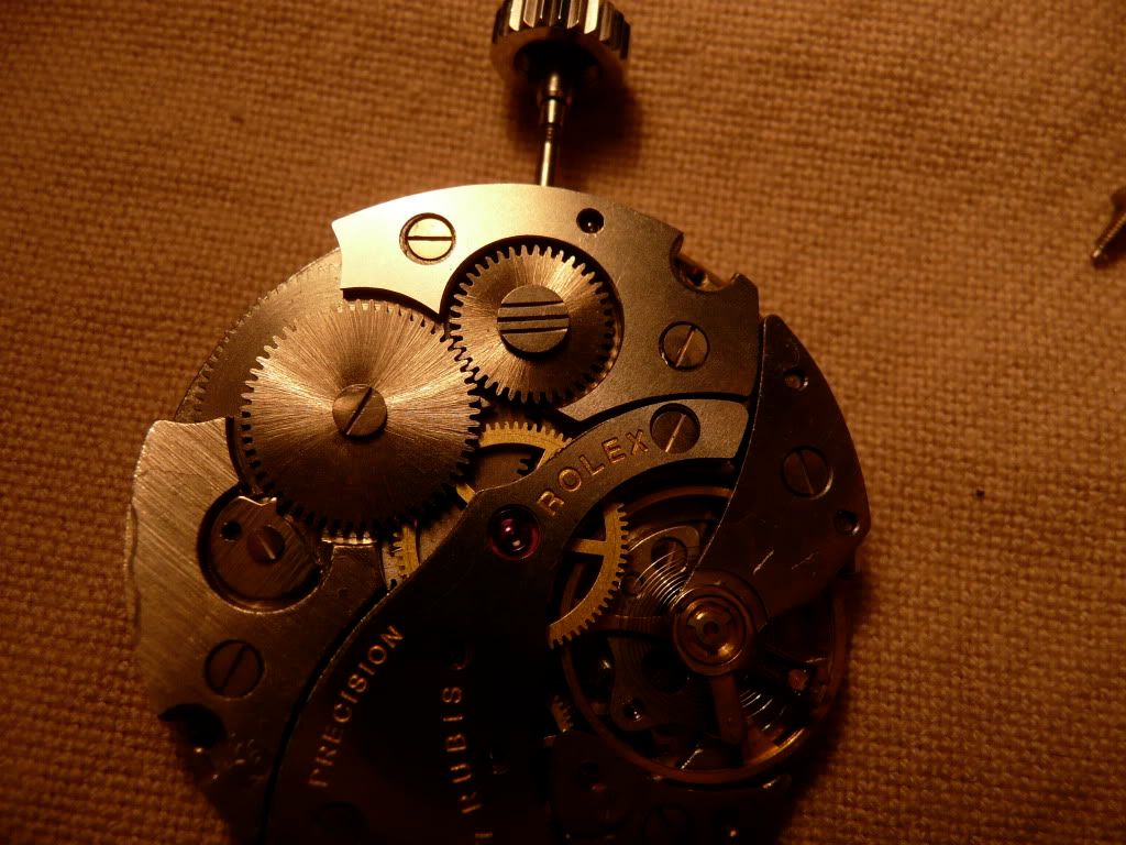

Thanks for the advice, and thanks for the repair page you sent me by PM, Coldi. Much appreciated. I wonder if I have dislocated the castle wheel, though according to the web page you sent me, I have the opposite problem: I can set the time but not wind the watch. Presumably I will have to fiddle with the setting lever--which clearly has two positions. Looking at it through the loup I don't see anything obviously awry, but then I don't think I'd recognize it as such unless it was really bad. I'm going to give it a try tomorrow, so please feel free to chime in between now and then with more advice. Here's a poor photo. Perhaps this will show you something.....

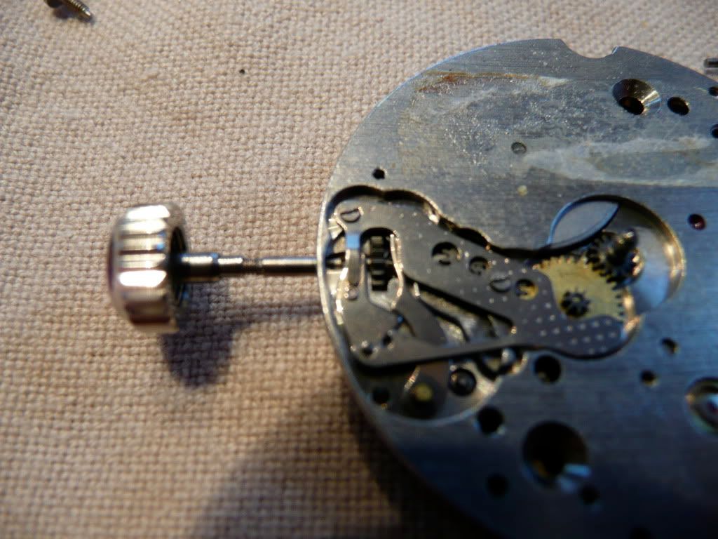

Here's a photo of the back side.....
R2D4
Admin
15/4/07
14,908
56
I would take the dial off, reset the lever and Keyless and try again. It's tricky sometimes. You just have to take a deep breath and go slowly. You'll get it. :)
Oh BTW, take that movement off the cloth and put it on a solid clean surface. Your just asking for a thread to get in there and foul up the balance. ;)
